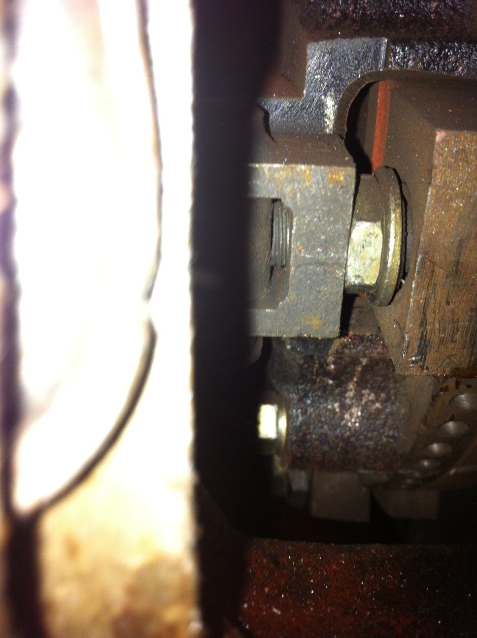

HI i was cutting grass with my Farm Pro 2420 and finish mower when all of a sudden it reved up and wouldnt move, will not move in any gear and there is a slight grinding noise when clutch is released clutch was replace a couple of years ago any imput would be appreciated thanks

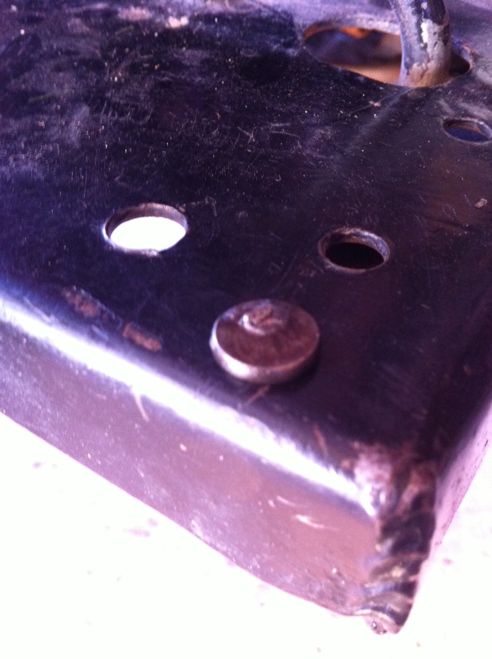

Hi this was located in the bottom of the casing below the clutch and also if you look I have no more adjustment left to adjust my freeplay on clutch peddle have approx 4 inches I know this is too much also tractor will move in L L gear is there a procedure to properly adjust these clutches thanks

Just a WAG but from seeing other clutches that looks like the head of a rivet that holds the clutch plate together.
Yes, and if that's where you've been "adjusting free play" you have probably seized the discs. It could also explain one sheared rivet. But there are quite a few rivets holding the friction surfaces, so shearing just one is probably only a symptom - not a cause
As you probably realize, pushing in the clutch pedal disengages the clutch. What actually happens is that your foot motion causes the throwout bearing carrier to be pushed into the clutch release fingers. That metallic noise you're hearing could very well be coming from a damaged throwout bearing. Anyway. The force of the TOB pushing on the release fingers separates the pressure plates from the friction discs. When the plates and discs are not in contact, the clutch is disengaged. Once you release the pedal the TOB carrier backs away from the release fingers, and the discs and plates once again mate.
The basic clutch adjustment involves starting with the correct stack height, then setting (and maintaining) a 2.5mm gap between the TOB face and the clutch release fingers. This gap is set by changing the length of the pull rod that connects the clutch pedal and the clutch release arm that sticks out of the bell housing. The adjustment is where the yoke is threaded onto the pull rod. As the friction discs wear over time, you periodically adjust the yoke on the rod as required to recover the 2.5mm gap.
All this is done from outside the tractor. But when encountering a situation like you describe, it's not that simple. If you've been adjusting through the inspection window, then you've altered your stack height. All bets are off. Someone with Chinese tractor clutch experience might - and I stress might - be able to look through the window and figure out how to undo what's been done. But short of that, you're likely gonna have to split the tractor. The existing clutch may be salvageable, but you won't really be able to tell until you get in on the bench. At that time it can be repaired or replaced, stack height set, then reinstalled on the tractor. When the tractor's reassembled, you then set the 2.5mm gap - and the stop bolt length if necessary. At that point your pedal travel should be back to the specified inch or so.
The rust on that rivet by the way, suggests it's not a recent break. At this point it may be nothing more than a red herring. Who did the last clutch replacement by the way?

Hi the clutch w replaced in 2007 when I purchased the tractor not sure who done it? I will split and inspect Greg can you explain how to set stack height thanks
   / Farm pro 2420 transmission/clutch #7
Sure. Look in the owners manual section on Adjustment of the Tractor. With luck you'll locate a diagram of the clutchpack there. I don't know whether your tractor has a 3 finger clutch or a 6 finger clutch, the stack height is different. But on my 254 Jinmas, 3 fingered stack height was measured from the clutch release finger tips to the engine side of the PTO pressure plate. I'd adjust each of the 3 release finger hex nuts until there was exactly 96.8mm between each tip and a corresponding location on the pressure plate. Those three tips also were spec'd to be within 0.1mm of each other. That way they exerted simultaneous and equal pressure against the TOB face.
