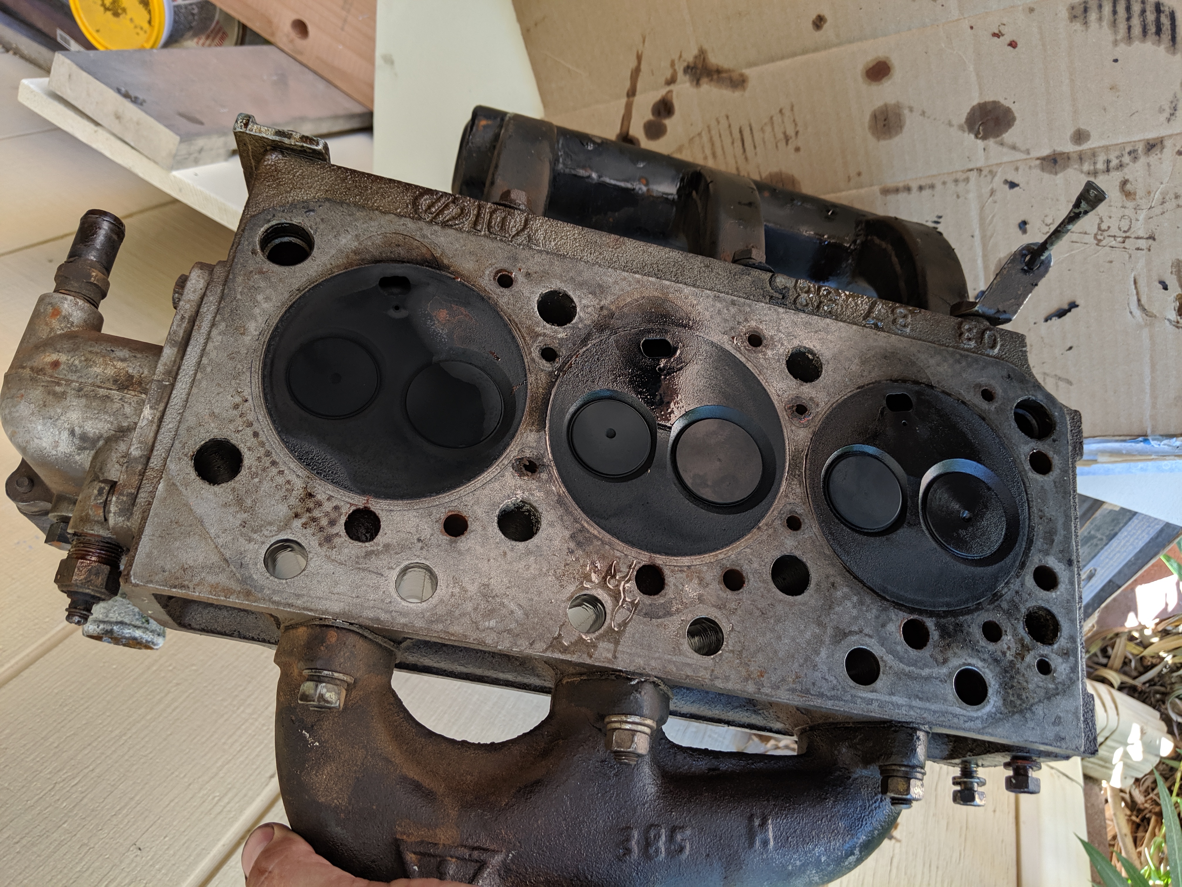

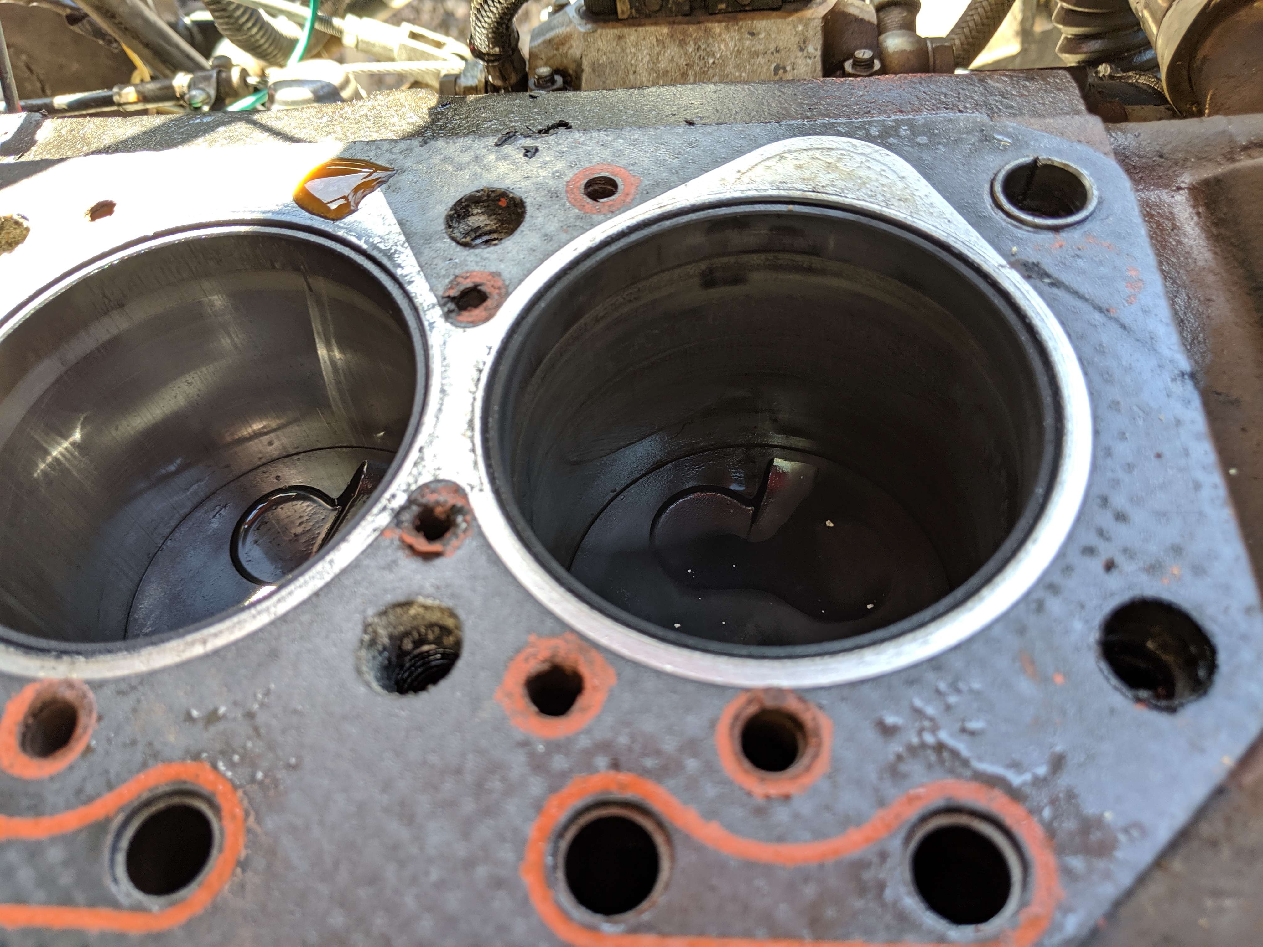

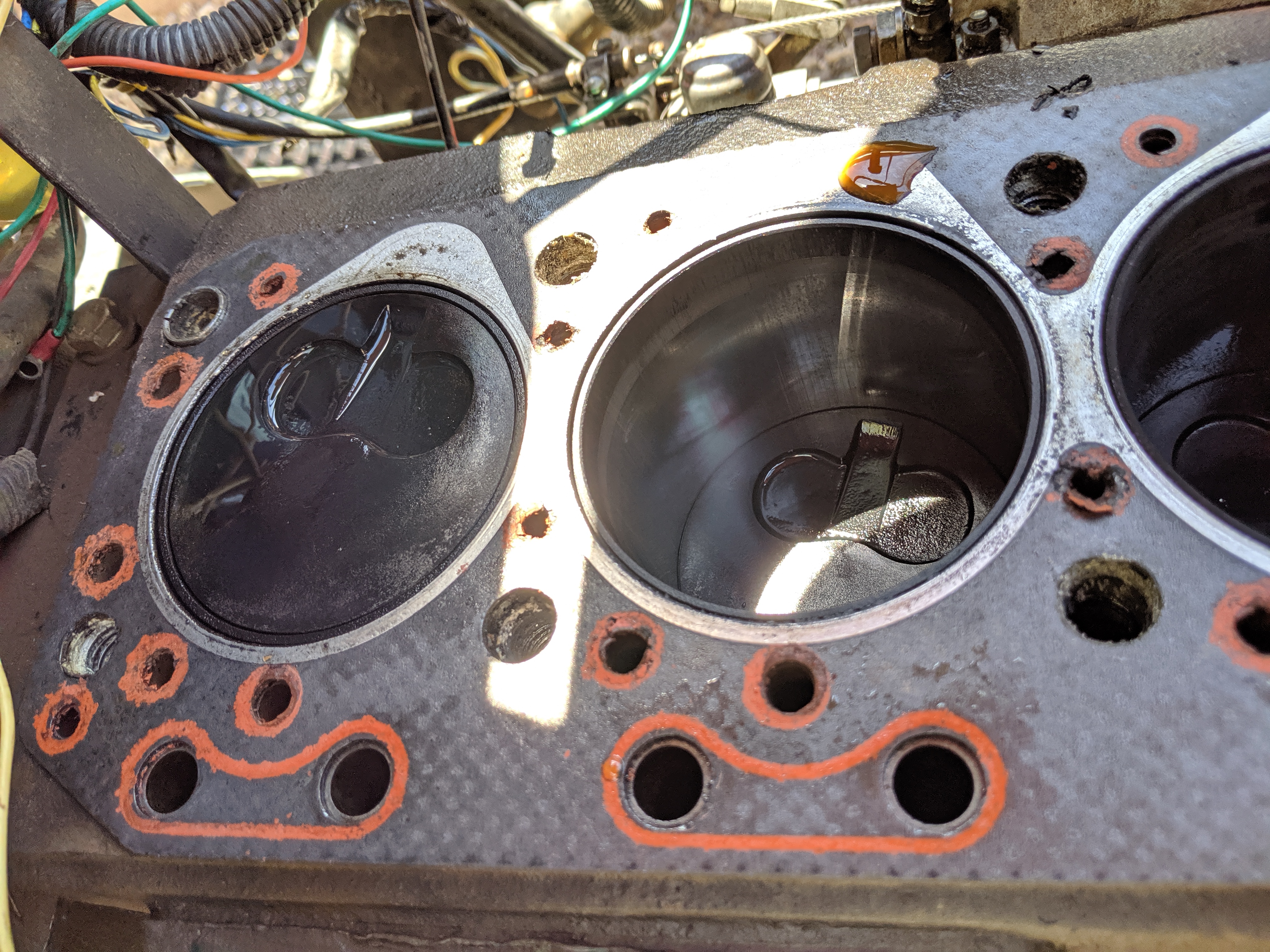

I buy a new head gasket and plan a weekend to do the replacement. When I pull the head off the tractor I find what looks like a fairly new condition head gasket, with no obvious signs of damage. The cylinders don't look great, but they didn't show major signs of damage either. (see below) I cleaned up the head and block and installed the new head gasket. As I reassembled the head, I noticed the fan pulley seemed loose and found the bearing out the water pump were shot. Ordered a new water pump and waited for the next weekend to continue.

Hey Tommy, thanks for the pointers. There is definitely blow by happening. The breather pipe that exits near the bottom of the engine is puffing the grey smoke and if I pull the oil fill cap off while it is running I get some as well. If the oil rings are the issue, would it be as simple as removing the pistons, re-ringing and honing the cylinders?
I may not try to play with the timing any further if you think it sounds close to correct. I thought the smoke could be from timing but it seems like you are suggesting it is more likely burning oil than fuel.
