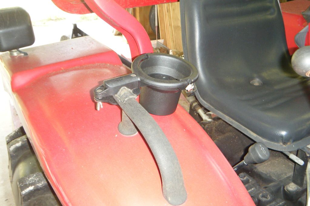

My first accessory install:laughing:
Swiveling ATV drink holder, $8 from china mart.
   / Farm Pro 2425 New Owner #12
Actually, that's a pretty cool accessory. I am supposed to be drinking something nearly constantly, and my Farmpro doesn't have a cup holder, so thanks for the idea!

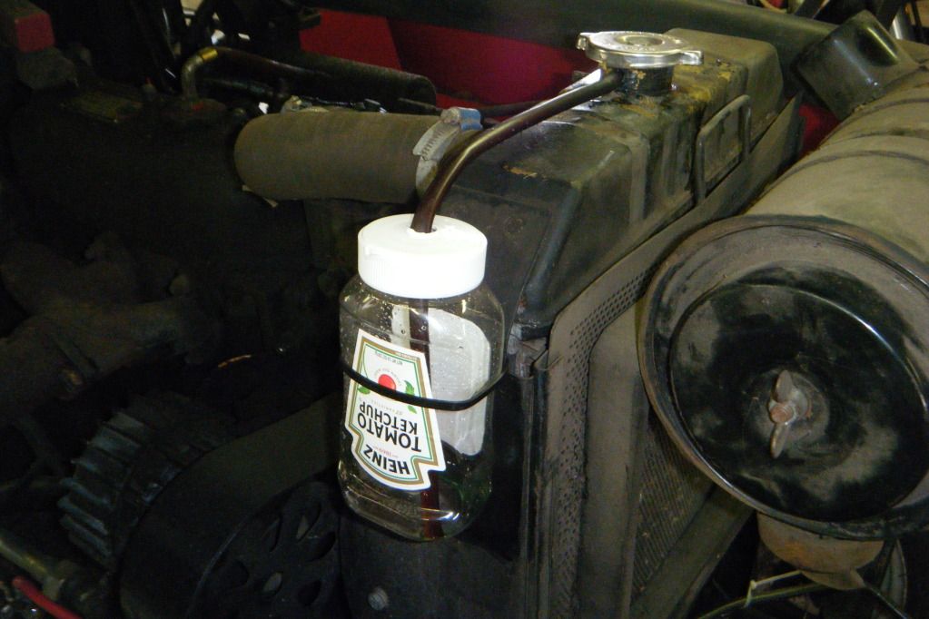

Speaking of heat, when working a bit, the coolant will spit as the radiator cap opens, here's my solution. Best use of Heinz ketchup bottle I could think of:p
Great idea! It must be kept 1/3 full otherwise it will suck air back into the cooling system.
