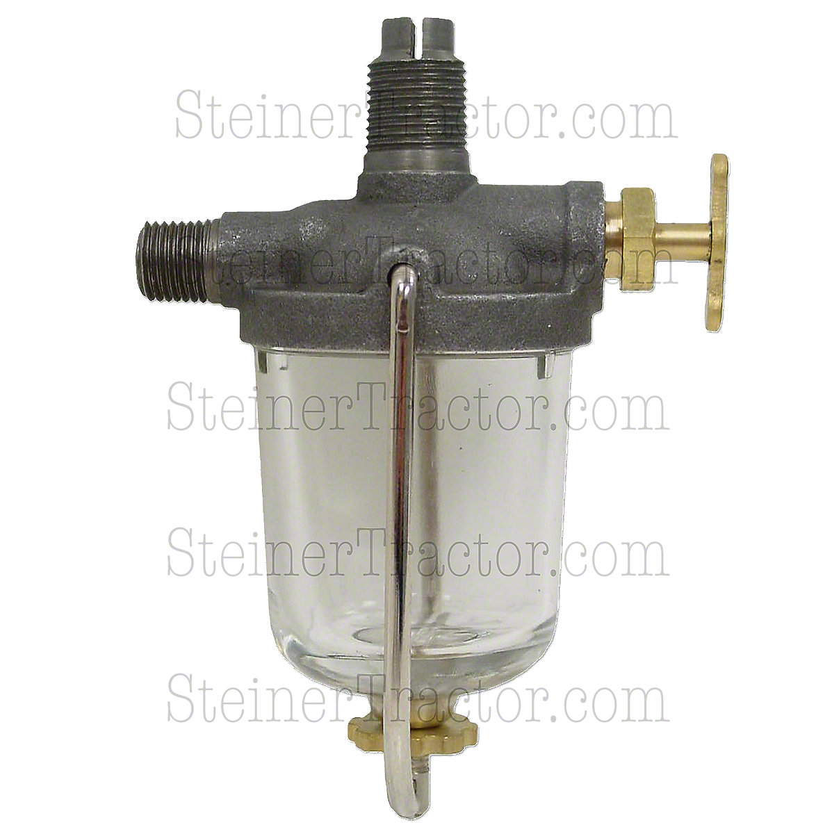

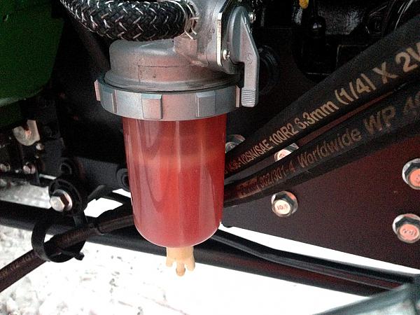

My fuel bowl is shot on my Farm Pro 2425. I tried fixing it but it just broke. Is there a part that will replace these without having to order one? I have a couple tractor places around here but none carry Chinese tractor parts. Thought maybe someone here may know of a different brand that would work?
/ Farm Pro 2425 #2
You must have the plastic bowl. I replaced mine with a glass one from NAPA Tommy at Affordable Tractor also carries replacements.
/ Farm Pro 2425
Mine has the tapered thread and yes the plastic bowl. My tractor has been acting like it runs out of fuel so I was going to check screen in sediment bowl. It has been leaking for awhile. Hoping it was sucking air from there is why it kept running out of fuel.The collar that hold the bowl on wouldn't tighten it just spun.So I took it all off and wrapped enough Teflon tape around it to get it to tighten. Then when I went to put it back on before I even got it tight enough it broke off in fuel tank. I got it out with ezy out but cant find a replacement. Do any other models have that tapered thread that would work on a Farm Pro? Whats my options?
/ Farm Pro 2425 #4
You have many options. Which type of sediment bowl do you have, since you described it differently than what I envisioned.
Type 1
Type 2
/ Farm Pro 2425 #6
Ok, that's the one shown in Type 2. I have not found where individual parts for this type are sold, but that is a fairly common unit. They are found on John Deere, Case, and many other tractors. I have one on my Mitsubishi excavator and Mustang skid steer. It looks like you have found one at Tommy's. You can always change over to the type 1 with a glass bowl if you want to.
