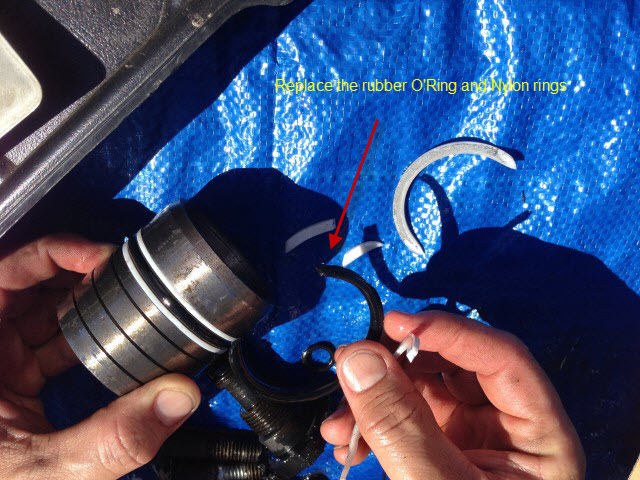

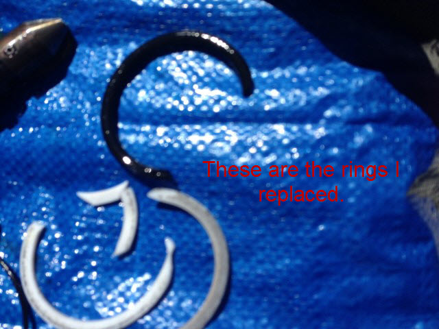

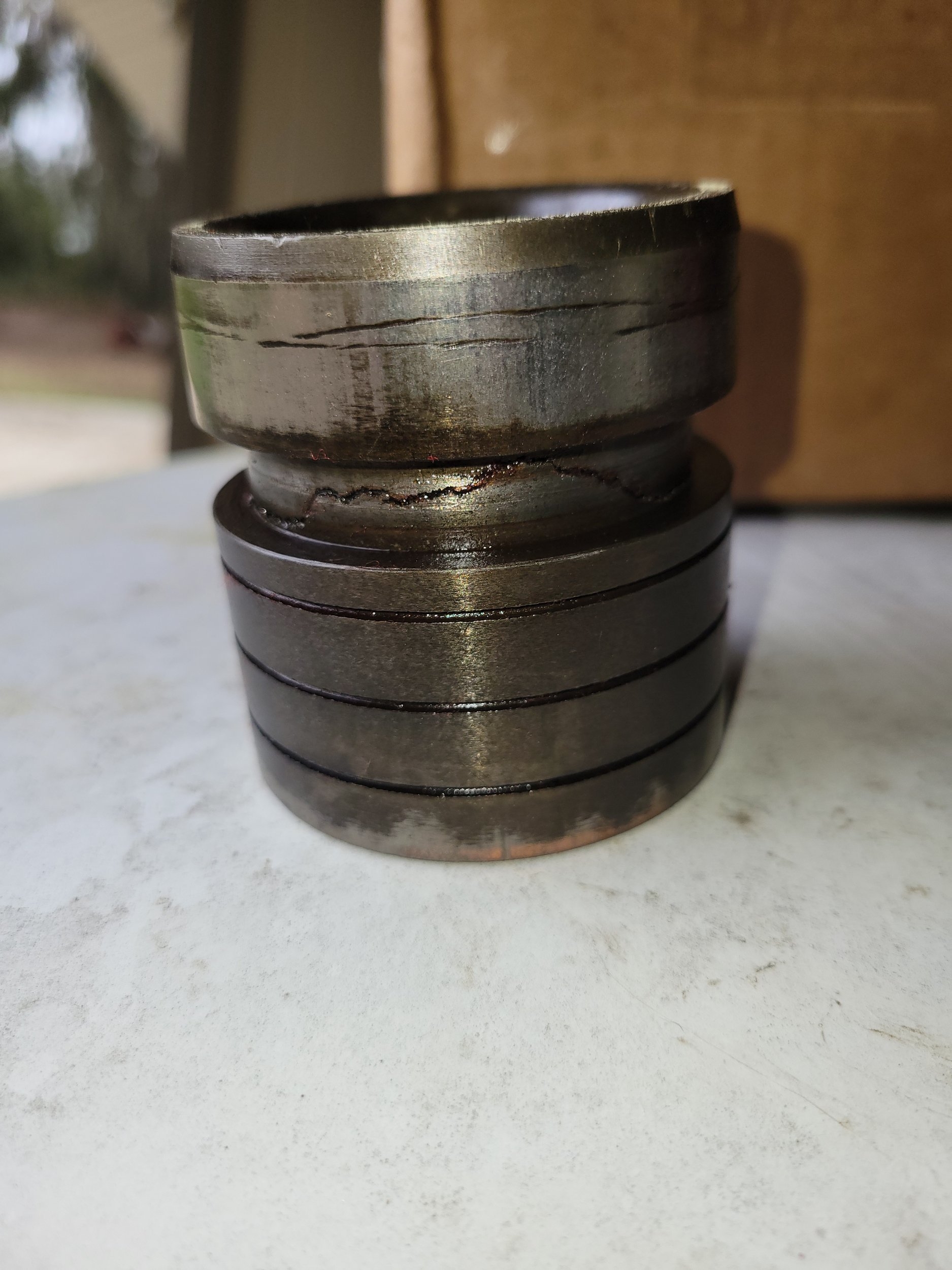

I got the tractor back and decided to take a look at it myself, the first thing I noticed was that the hydraulic fluid was not full, not a good sign so I decided to drain it and check the seals myself. I ordered a piston rebuild kit from Affordable Tractor ( the repair shop had this also, as well as a diagram of the piston I printed for them) and all of the seals were still in the bag when I got it back from the repair shop. I pulled the cylinder and found that the piston ring was disintegrated and the nylon seals on either side of the ring were broken in numerous pieces, I replaced these rings and had the tractor back together and working in less than two hours. Now the Local Farm-AG John Deere dealer's shop spent 6 hours on it, charged me $270 ($70 of which was for fluid) and could not find a problem.

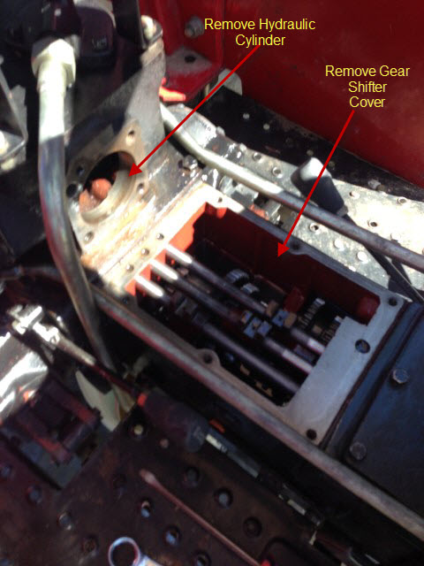

2. Remove Gear Shifter Cover and Arms (you will need to do this to get the cylinder out, its in the way). (See Pic)

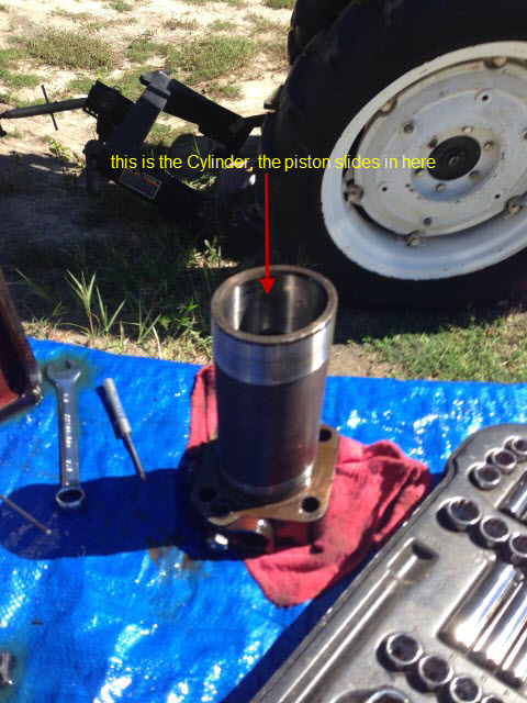

3. Pull out the cylinder. (See Pic)

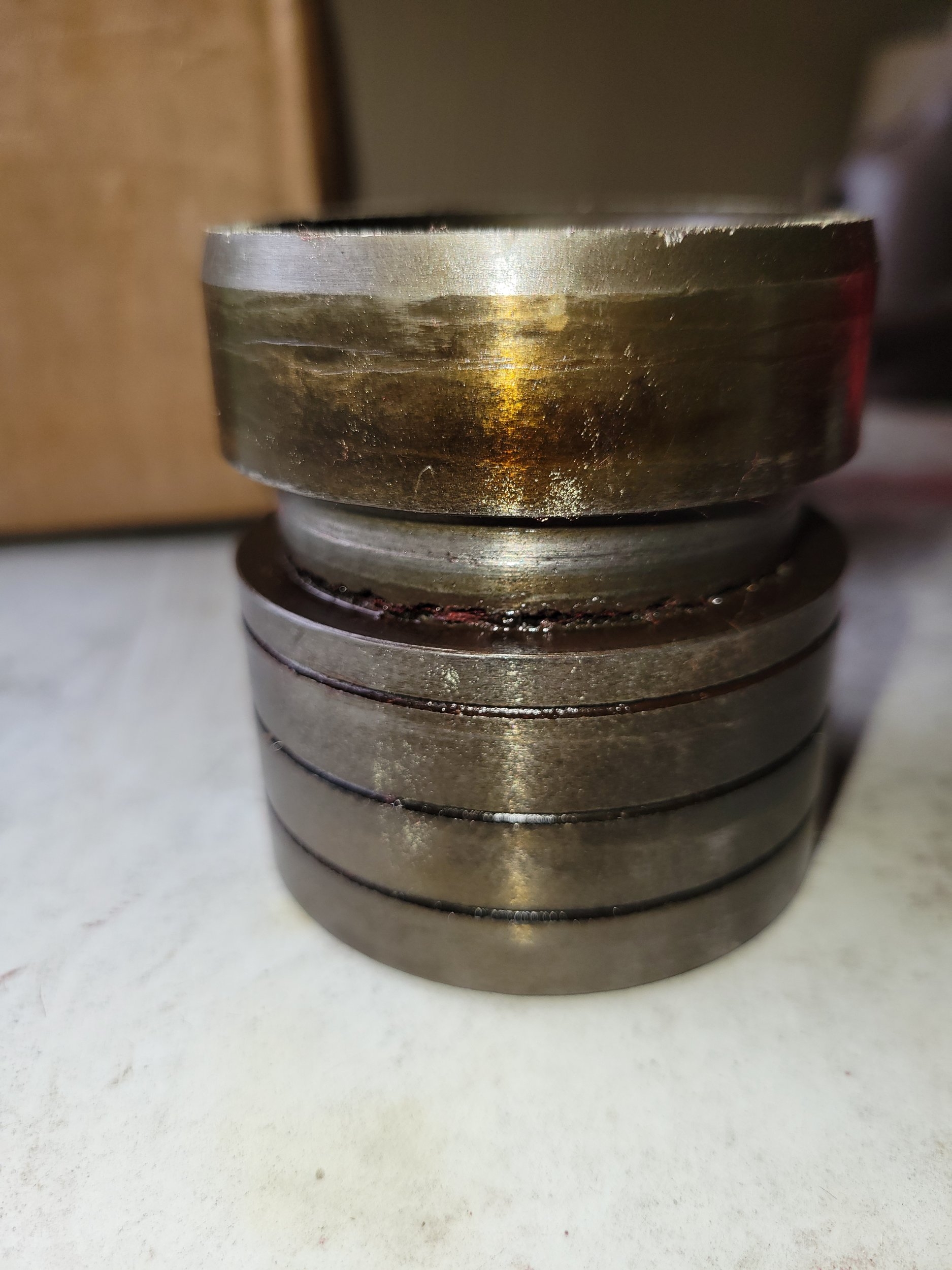

4. Remove the piston from inside the cylinder, on mine it slid right out, the rings were bad, but if the rings have a good seal you will need to tap it on something while holding the cylinder upside down to get it to come out enough to get a grip on it.
5. Replace the ring and nylon washers (See Pic)

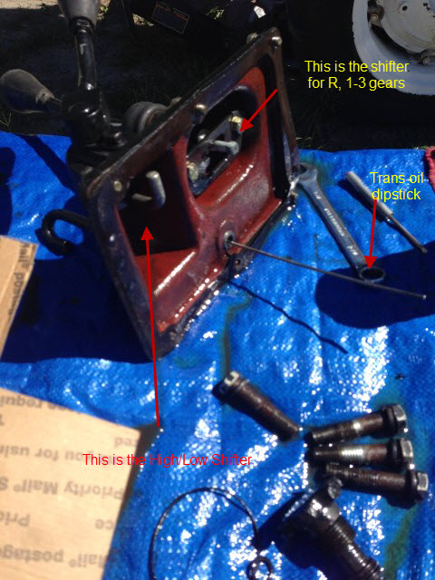

7. Replace the 3PH plate, the cylinder and the Shifter and cover. Make sure the shifters line up with the linkage arms. This was not too difficult but took my several tries to line them up as well as the gasket. I had to put the cover on and get the tractor in Neutral in order to line up the shifter with the linkage arms, there are three arms, one for High and Low, and the other two are for Reverse and first gear, the other for second and third gear. You can see them in the picture.
