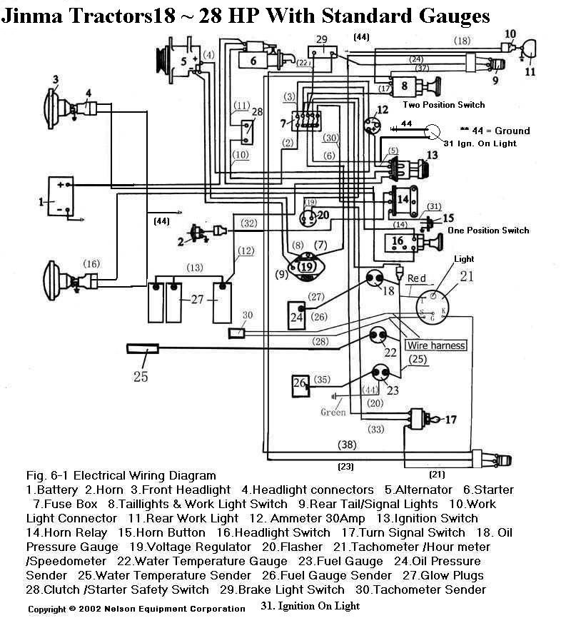

I just purchased a Farm Pro 2425 tractor. It being the same as Jinma explains some of the diagrams and part numbers in my operation manual. I am having electrical problems. No gauges. Checked all the fuses in the fuseblock, but haven't searched for in-line fuses yet. I wouldn't think one fuse could power all the different gauges and idiot lights too. First owner said he knocked off the exaust pipe and had to replace it. Maybe too much heat on the fuseblock?
   / Farm Pro Manuals?? #4
Unless you see a physical distortion of the fuse block, I doubt exhaust heat has anything to do with it. Cheap electrical systems are almost universal with entry level Chinese tractors. But your manual should have had a wiring diagram. When you find it, you'll likely see that - with the exception of the ammeter - all other gauges/indicators are protected by a common fuse.
//greg//
   / Farm Pro Manuals?? #5
The wiring diagram is very vague about what does what. When the wire lines get to the fuseblock area they blend together, not a high quality drawing.
   / Farm Pro Manuals?? #8
Thanks for the wiring diagram. With it on my computer I can enlarge it big enough to see where things go. This helps alot.

Thanks. That diagram Tommy uploaded is basically representative, but it's for an earlier model with the individual gauges. Now that he knows it's for a 2006, perhaps he's got access to a newer diagram that incorporates the cluster gauge wiring - because unfortunately I don't. There is however a problem with how the above diagram depicts the tach/hour meter wiring. Look at the K terminal on tachometer sender 21. The line going down to that tail light wire is incorrect. That wire is the hour meter trigger, and should go over to oil pressure sender 24.
