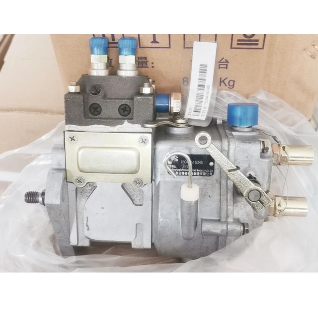

I have a new project tractor that I have hit a brick wall on have a farm pro 2040 getting fuel to the injector pump in from the injector pump. A little bit of fuel is going to injector one, but getting no fuel to injector to. I am at a brick wall and would like some advice. I have checked fuel lines, gravity, flows, good.
/ Farm pro #4
Does your fuel injection pump have a cover plate on the side? Does it look similar to this?
/ Farm pro #7
No, I have the OEM injector pump that does not have the side plate
In that case you have three options:
1) Send the injection pump to a local diesel shop, or thepumpguysc.
2) Purchase a new injection pump.
3) Attempt to repair it yourself. It should be noted here that individual parts are not available, and there is no service manual for the injection pump.
Good luck, let us know what you decide.
