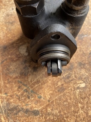

On the “back-side” of the lift pump, there will be either a roller or a plunger that rides on the pumps cam lobe..
Behind that will be a seal or oring.. u can just dunk/spray that area..

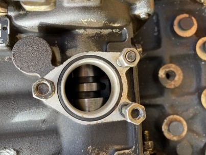

Okay I finally got around to removing lift pump. I just removed the (3) 10mm nuts from the lift pump flange and the pump came right off. As soon as I loosened those (3) nuts,
fluid started pouring out from the gap created by loosening the three 10mm nuts.
I assumed that the fluid was diesel fuel and that I had at last found how the fuel was getting into the crankcase. I collected the leaking fluid in a container until it was done draining. But it does not really smell like diesel fluid at all. It is a clean, thin somewhat oily fluid that smells more like an old oil paint or maybe an oil based wood preservative. I'm thinking maybe that fluid is the injector pump lubricant?? Does that sound correct?
The lift pump was still connected to the diesel fuel inlet and outlet hoses, so I opened the fuel bowl valve to see if diesel leaked out anywhere near the lift pump roller/plunger, but there was no fuel leak. I operated the manual plunger a few times but still could see no fuel leakage of any kind. Considering that make crankcase oil level rises at about 2 quarts per week due to this fuel leakage, is the any other possibility regarding the source of this fuel leak?
I still haven't done the air pressure test on the lift pump. That will be next.

The cam lobe always compress’s the roller or push rod slightly..
So when u pulled it away from the main pump, it changed position of the plunger rod.. possibly moving the rod to a good position where the seal can seal on the rod.??
If u don’t follow the diagnostic directions we can’t rule things out..

Okay I finished the air testing. I completely sealed the outlet side of the lift pump, covered the whole mounting side of the lift pump with thick soapy water and applied
120 pounds of air to the inlet side of lift pump. After 12 attempts with lots of soapy water and lots of air pressure, not one bubble or leak of any kind was evident anywhere.

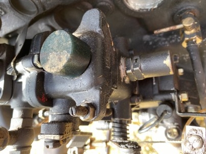

The fuel injection pump on some engines are lubricated with oil from the engines pressure system. If that is your case you will have an oil line connected to the engine block, and another connected to the sump.
As I recall, this injector pump requires oil to be added to the injection pump manually.
I think you can probably see the small dipstick on the injector pump in the photo I posted earlier.

Depending on what injector pump you have, it might be possible for a leak to get into the crankcase through the front timing gear housing.
Another possibility is an injector that is leaking and letting fuel wash down past the piston rings.
I can't think of any other places where diesel would get in, unless the "lift pump" is powered by the engine cam shaft and not part of the injector pump. Think old style car engine fuel pumps mounted to the block with an arm that rides on the cam. On my Jinma 284 the lift pump is mounted on the injection pump, not the block. When it failed internally it dumped diesel into the crankcase of the injector pump, which over flowed through the breather. Not the same thing as getting fuel into the engine block.
Post a picture of your fuel system so we can see exactly what is involved.
Thanks much for reply.
I'm starting to wonder if maybe is a leaking injector as you have mentioned above.
Do you know of a way to verify this? Is there a way I can test for leaky injector?
Or do I just have to replace one at a time until bad one is found?

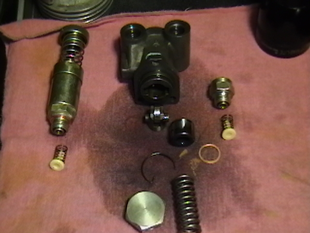

Here are your lift pump components.
