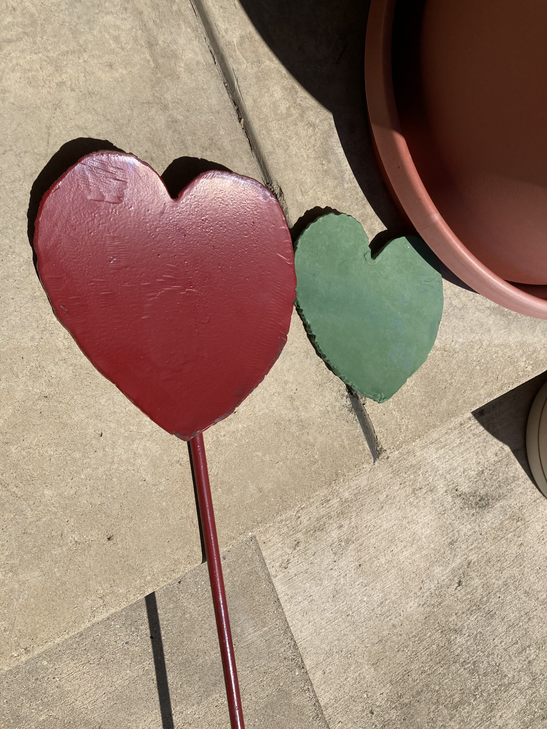

Here's one on using OEM paint. OEM for the good stuff; Rustoleum for the rest. Pretty simple.

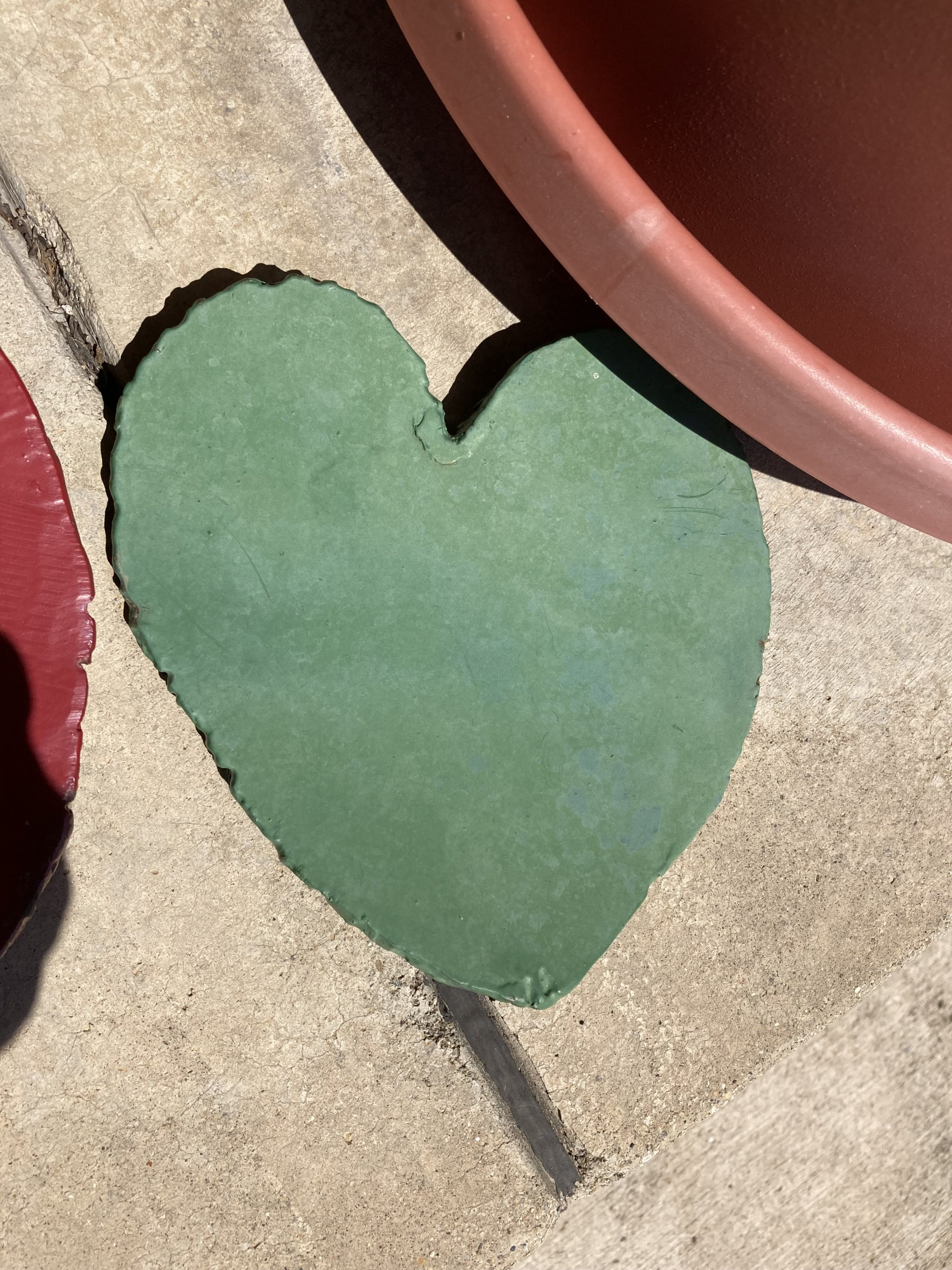

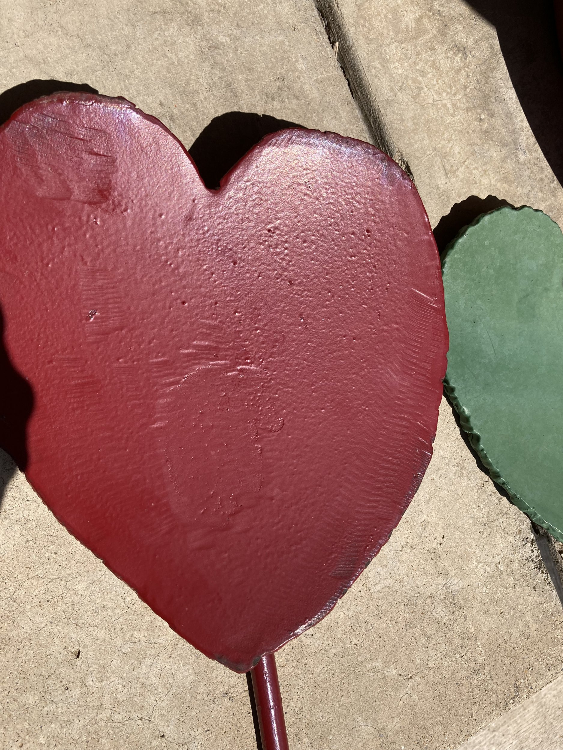

Here is a visual comparison of OEM red paint and green farm store paint to see which has weathered the test of time better. The red I think is OEM IH Red and the green is likely Oliver green from a farm store. The red was sprayed around 10 years ago and the green maybe six years ago. Both faced south into the sun.
Look how chalky and dull the green one is compared to the red one. The red is still glossy while the green looks trashy. I couldn't get the green in OEM. The difference in price between the two was not that much. For any restoration or repair work, OEM is the only way to go.
As I have written many times in other threads, OEM paint is relatively cheap because manufacturers want good looking older equipment to look nice and hold its value and instill pride of ownership and future sales . Farm or hardware store paint wants you out of the store ASAP with all of your cash on the counter.
