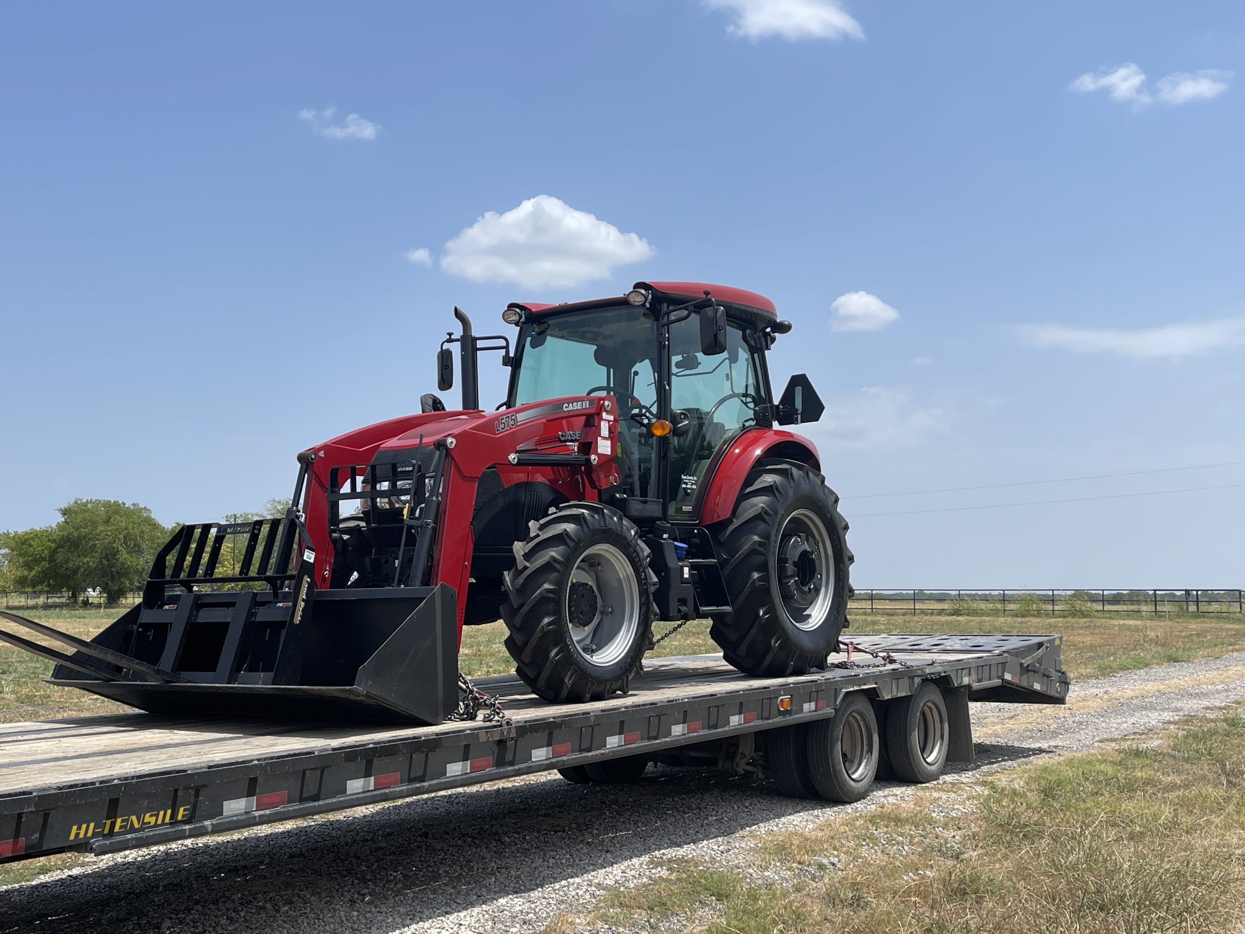

So far it has been pretty nice. Quieter. The air ride seat it pretty awesome. So far I have not been able to do a lot with it other than drive around the desert that is north Texas right now and some light loader work.
The loader is quite fast!
Have to figure out this MFD. I notice when I slow down, turning, parking etc the 4wd light comes on… book does not really say much about how it works.
It’s really nice having the extra weight, power etc…
I noticed there was another pto shaft in the tool box. Could that be a 1000 pto shaft? Mine only has the 540, didn’t have the 540 E option on that particular tractor, would have liked it but.. Does the 1000 pto have to have a lever to switch it like you do the 540E?
