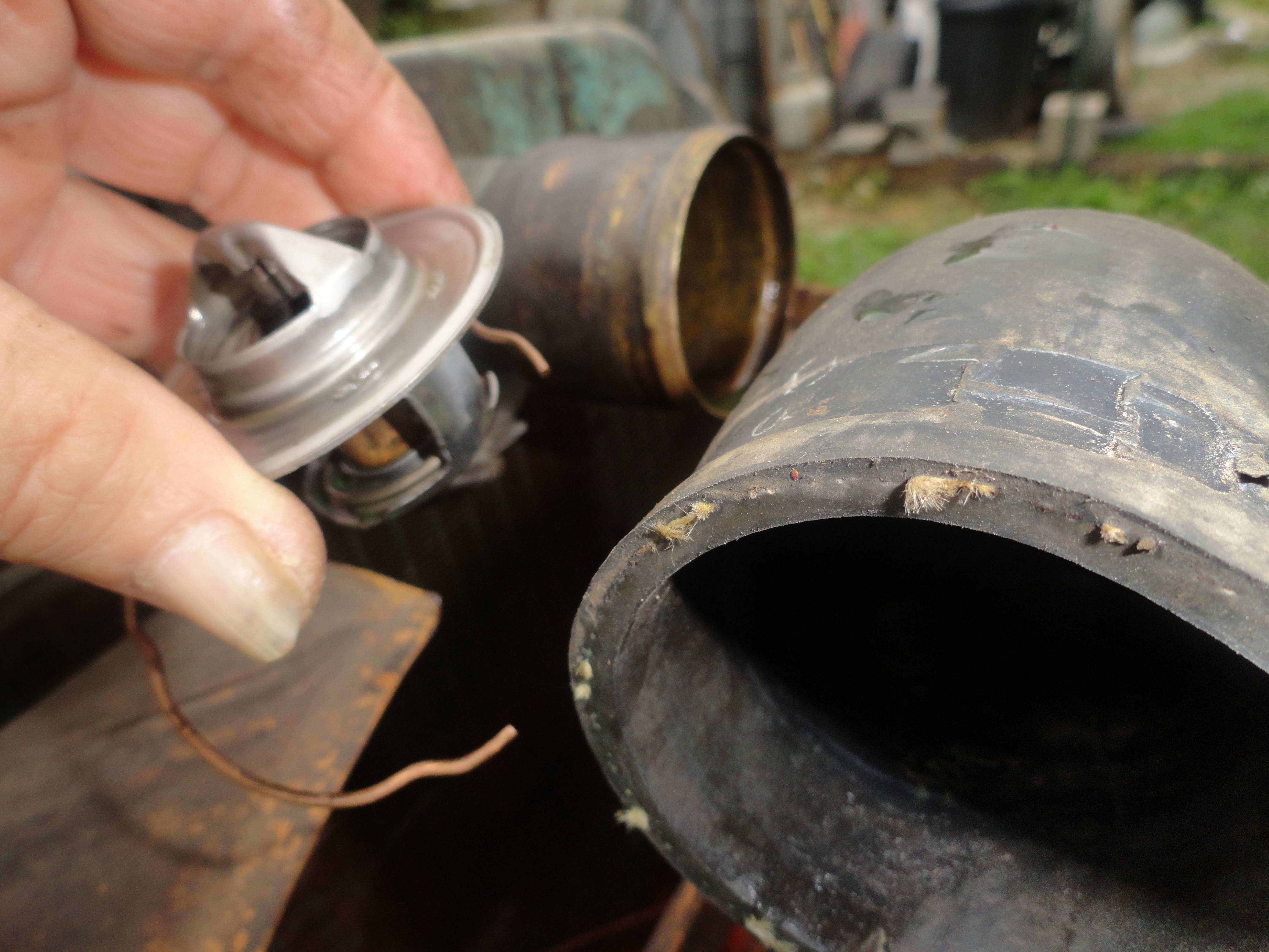

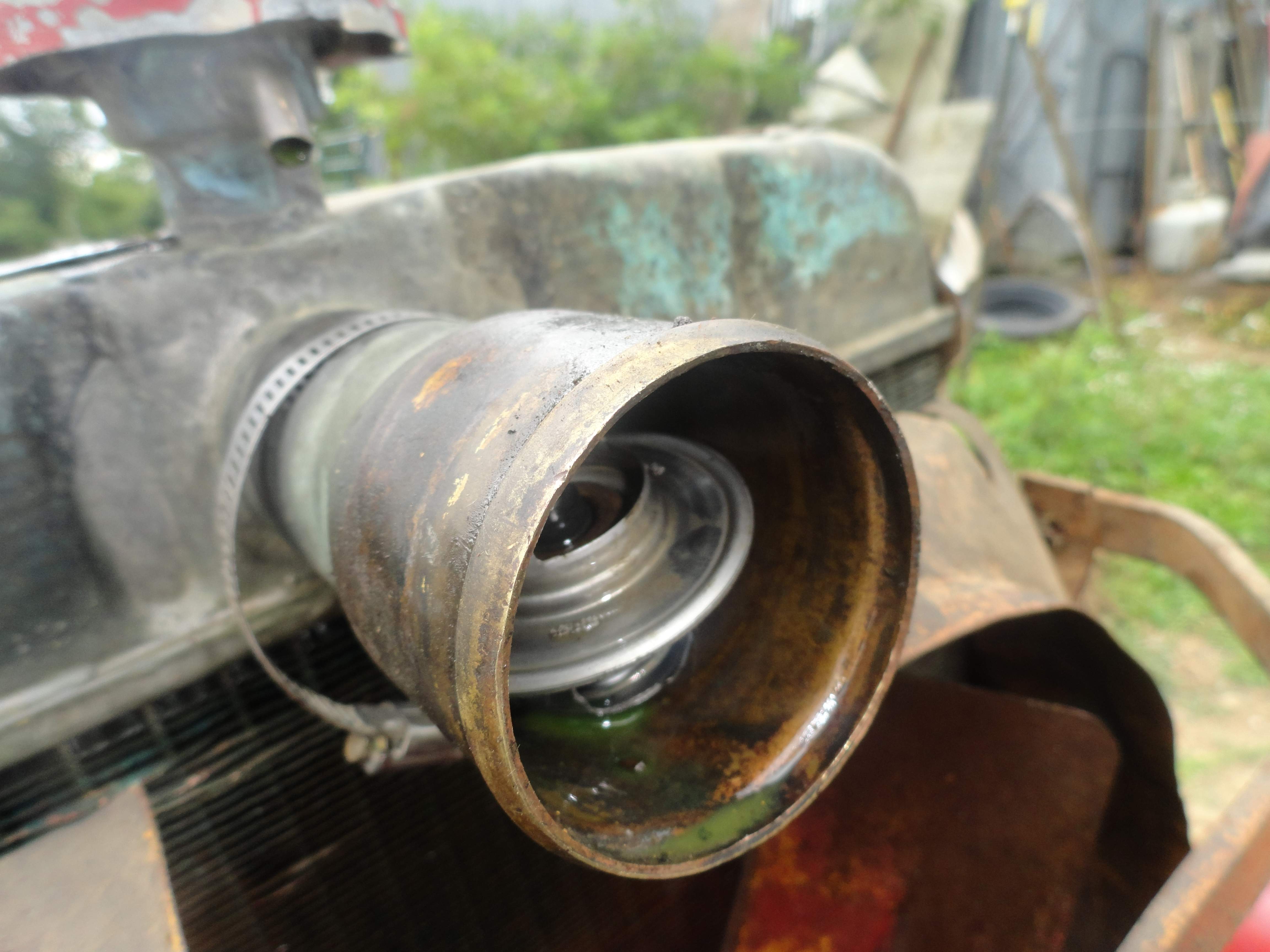

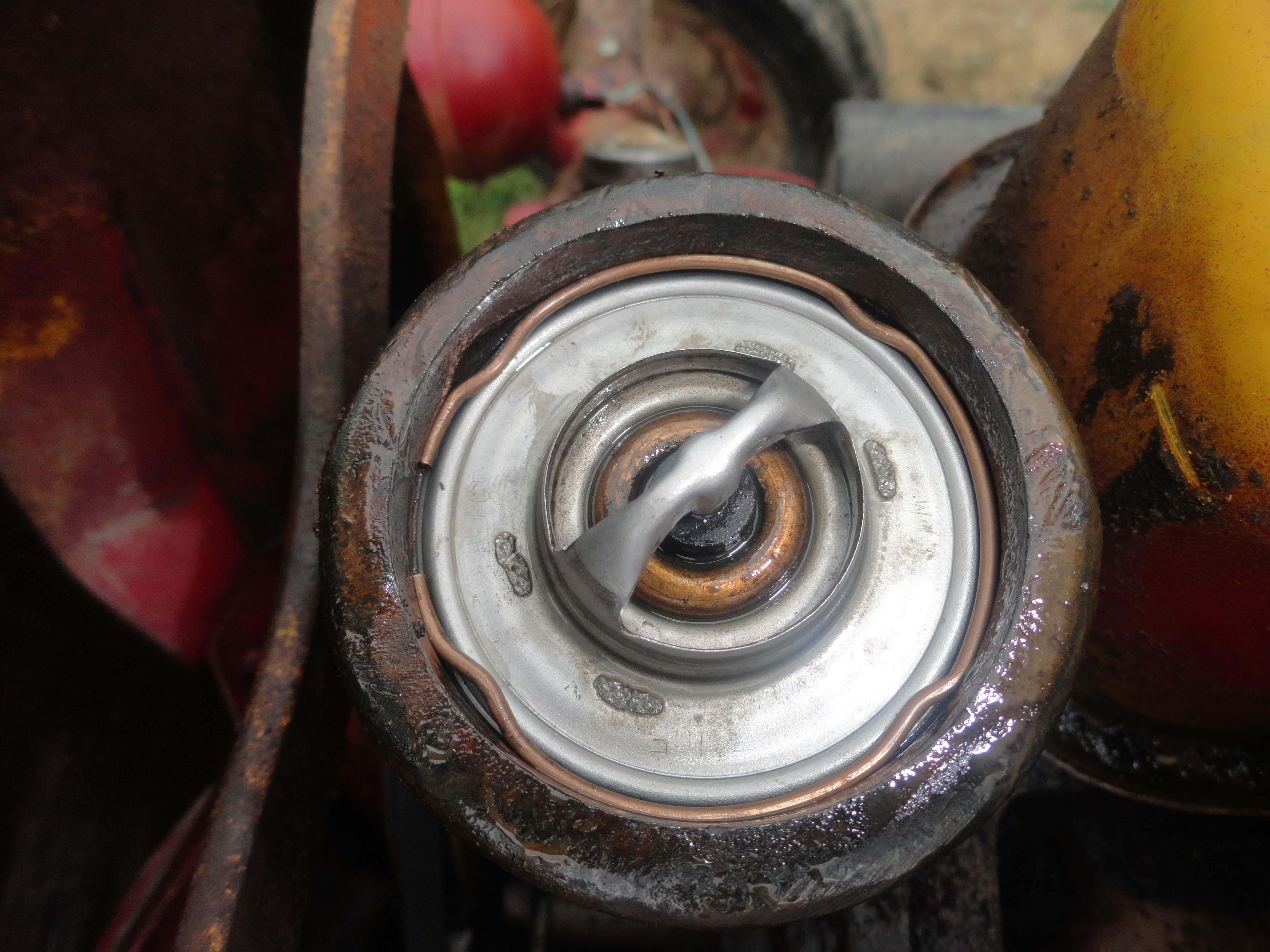

This is what I found: the thermostat, lying sideways in the upper radiator inlet; and I found the wire clamp to hold the thermostat inside the rubber elbow hose nearest the inlet on the cylinder head. Guess it's come unlodged. (See photos.) DSC00398.jpgWonder what would cause this? Maybe the thermostat got stuck and the pressure forced it loose from its sear. Guess I should go ahead and replace the thermostat or could check it with a propane torch to see whether it opens. Appears that you were correct, that the problem was engine overheating, thinning oil, rather than oil pump.

Could be a PO had the thermostat in upside down/backwards, and not letting it seat properly, and not letting the locking ring hold it properly either. With the water pump trying to pump at high RPM's, and it not held in real well, something had to give. You can always do the torch, or boil test and see if it opens. It does look like a newer thermostat. Never had the one out of the 240, or 656, but the one's on the Super C's, BN, A etc, has a brass housing.
I hope that cures your problem..!!

Ok. Thanks. Just got back from Steven's Tractor Supply w/a new thermostat. Pin toward radiator, as seated in the last photo, right? With the brass toward the engine, right? Thanks!
   / Farmall 140 Oil Pressure Loss #8
Yep... Parts book calls for a 180º one.

Don't want to be negative, but if the problem is overheating, you have likely just fixed a symptom, not the illness. Coolant should have been easily flowing past the dis lodged thermostat. If anything the engine would run too cold, not too hot. Best to look at that water pump again or for signs of oil or exhaust gas in your coolant, like maybe a blown head gasket or a casting crack.
