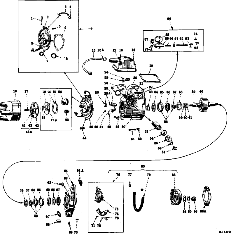

Here is an exploded view of your Mag. You may want to pull the coil cap off, # 14 I believe, and check for moisture and corrosion under that cap.
Also may want to check the condensor. I have a couple, apparently originals that have a brass shell. They get a green corrosion on them. Clean with some steel wool, or something similar, and they still work fine..!!
Being under plastic for several years causes a lot of condensation in the worst places.
