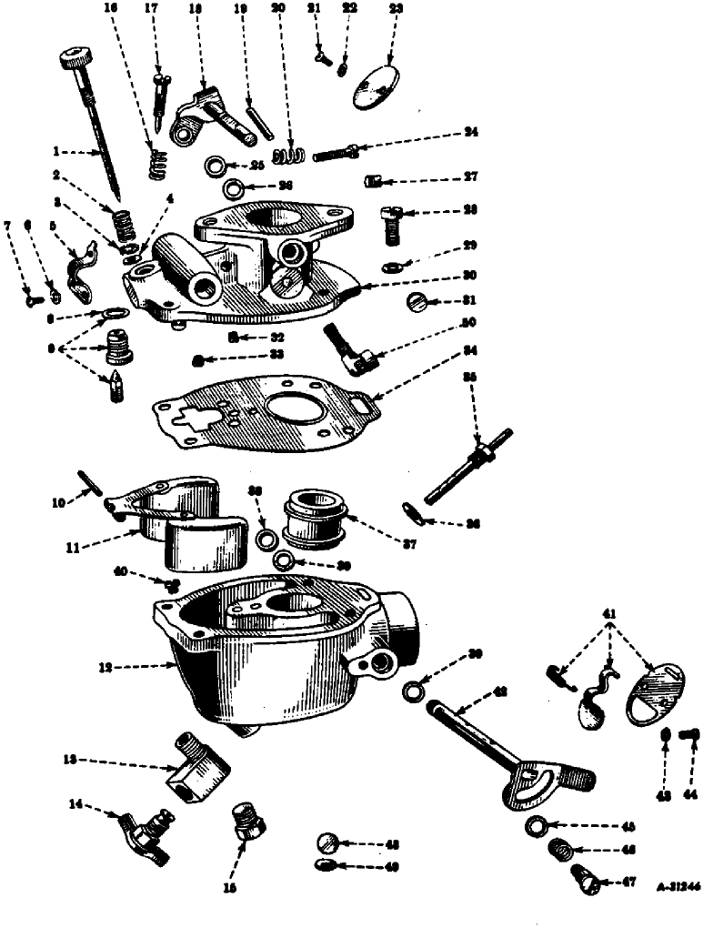

I've attached an exploded view of a Marvel-Schebler carb. used on the Farmall A. I'm curious if you removed the main discharge jet (#35, far right of the float) and cleaned that. There are several cross drilled holes in the lower part of the tube that can plug. The Zenith has the same, as all do, but this particular exploded view shows the holes in the tube much clearer.
