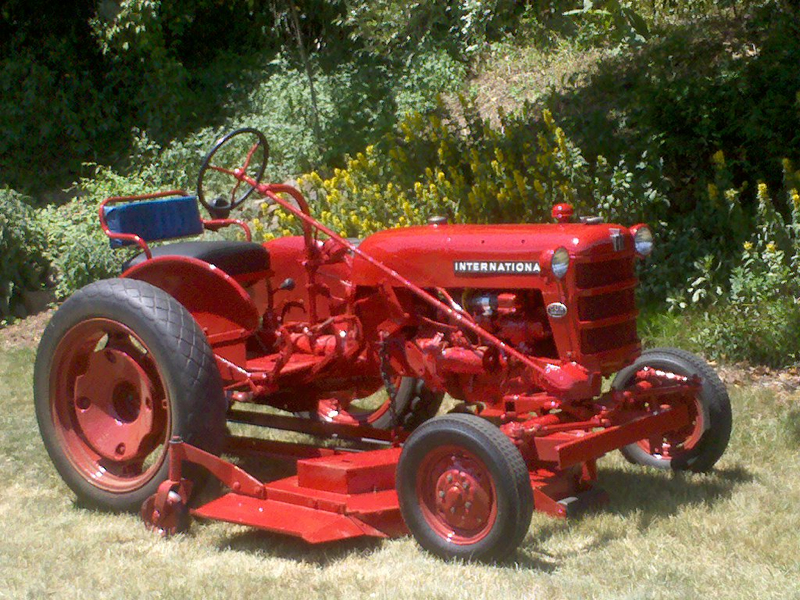

$2,000. Is about average price depending on attachments , I have seen them for much more needing work. They are little jem's and when you get it right it will make you smile. Not much can kill them and easy to work on so many out there parts are easy to find. Still wondering why the battery died on you. Pictured is about a 57 or 58 I found re did it for our American legion baseball field. Would have loved to have kept it. But my 88 yr. old uncle has 4 of them parked next to me I can play on any time.
