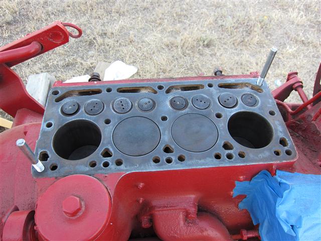

I'm facing a ring job on my 1948 Farmall Cub. Lapped the valves but the compression is only about 60 psi (wet) now. Should be about 100 psi on a 6.5:1 compression engine.
Question: when you do a ring job on your Fords, etc. do you put in oversize rings (0.020" etc) assuming that there's significant wear on the cylinder walls? Or do you just use standard size rings?
I want to do the ring job on that Cub in my shop without having to send the block to the machine shop if I can avoid that.
You'll have to check the taper in the cylinders to find out if you need to have it bored and use oversize pistons & rings. I'm not sure if that engine would have sleeves or not. Maybe someone else would know about weather it's sleeved or not.

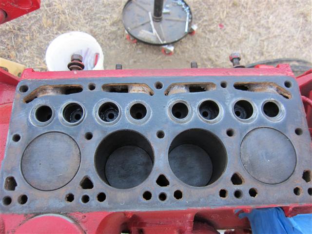

No sleeves in that Cub 4-banger. I did check the cylinders when I did the valve job--no ridges at the tops of the cylinders.
I may just do a poor man's rebuild (rings, rod bearings) and replace the valves and guides also.

Lapped them. Compression test (wet) showed about 60-70 psi on the cylinders with the lapped valves up from about 40 psi before lapping. Should be around 100 psi (6.5 compression ratio). Figure I'll be doing rings next.
   / Farmall H oil pressure #20
hmm... methinks seats as well...
