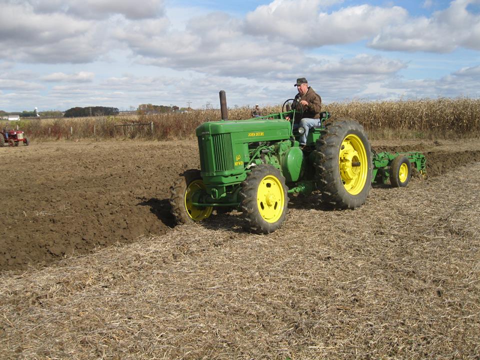

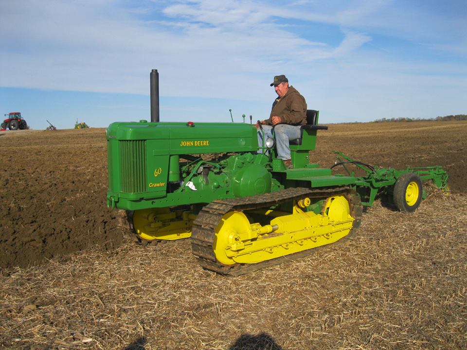

There are no known "home conversions " of a tractor to a crawler that top the fit finish and engineering . Of a JD model 60 crawler built by TS.
   / Farmall M Full Track Conversion #8
Have you seen his latest..?? JD 60 with functional MFWD. He has it, and the 60 crawler at a local plowing days today, and plowed with both. And I forgot to take my camera... :(
   / Farmall M Full Track Conversion #9
I have had the honour of driving the crawler and seen the 4WD in it's early stages . All around outstanding.
   / Farmall M Full Track Conversion #10
Found a short video of Tim's 60 crawler. I can't remember if the rear diffy, and undercarriage, is off a a 1010, or 2010 crawler.
https://youtu.be/c7RS5sDRIUg
Talked to a buddy of mine this morning who had Tim do some work on his tractor a couple years ago. He sent him a video of him plowing with the 60 MFWD. I checked Youtube where I got this, and nothing posted there. I'll have to see if he still has it, and will forward it to me.
