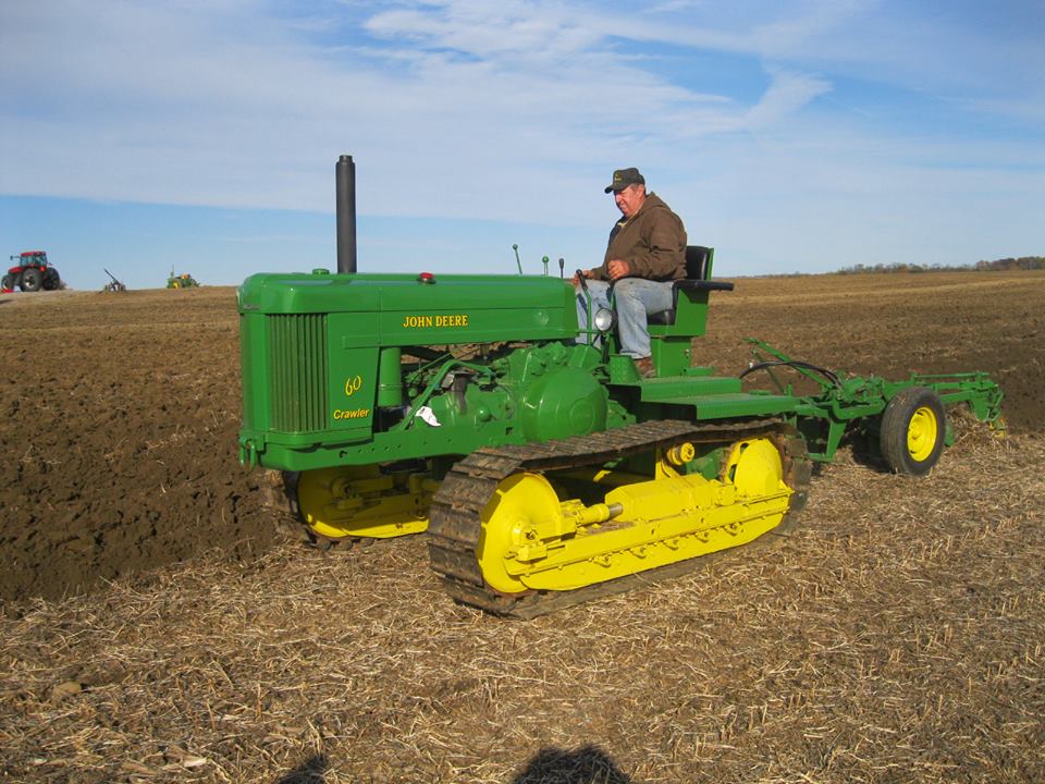

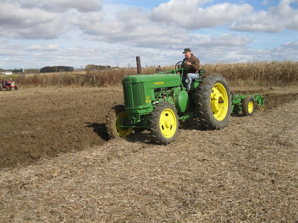

Thank goodness someone had a camera yesterday. He posted more than several pics of the guy's plowing. Here are a couple of pics of Tim's creations.
