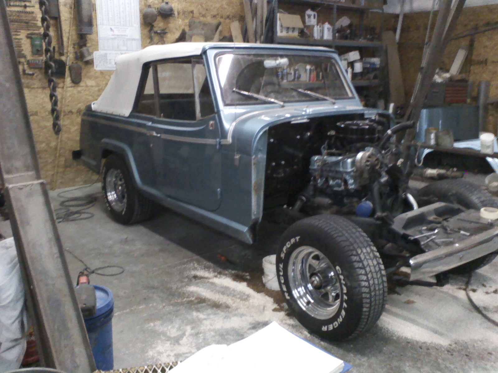

BoonevilleKid, not sure what the plug numbers are, will have to check them. Havn't had a chance this winter to work on any of my stuff as I have over 600 hrs in the jeepster project and other work lining up every day. Once I started on the jeepster more got added as the owner was real happy how well it was turning out so it became a bigger project than planned at first. I walk past my super c each day going to the shop and know that some day it will be new again also but while the work is there have to take care of it first. This is what I was working on all winter if anyone would like to see the build on it its located on Helpwrench.net under automotive project build threads 67 jeepster LT1-350 4L60E. I can only hope my super c turns out as nice as this jeepster did for the owner that I built it for.
