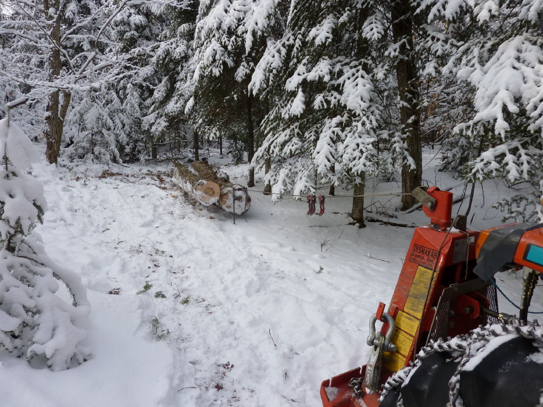

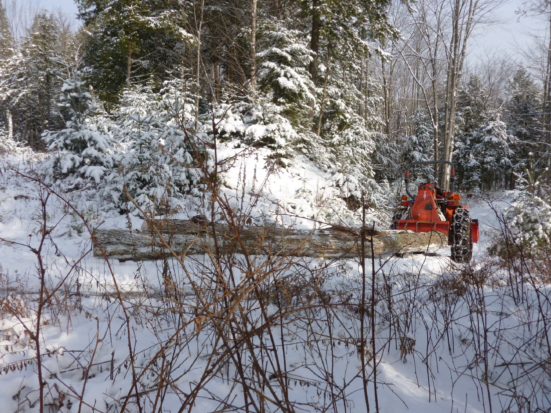

I have 5/16" on my Farmi. I dont pull a lot of big stuff. Mostly firewood and balsam fir and spruce. It handles hard maple logs 20' long and 16" or 18" at the butt doubled up just fine. Have pulled a few bigger but not many. My winch is good for 6400 LBS of pull on the bottom coil. Wow 200 feet every pull. That a lot of hiking.
