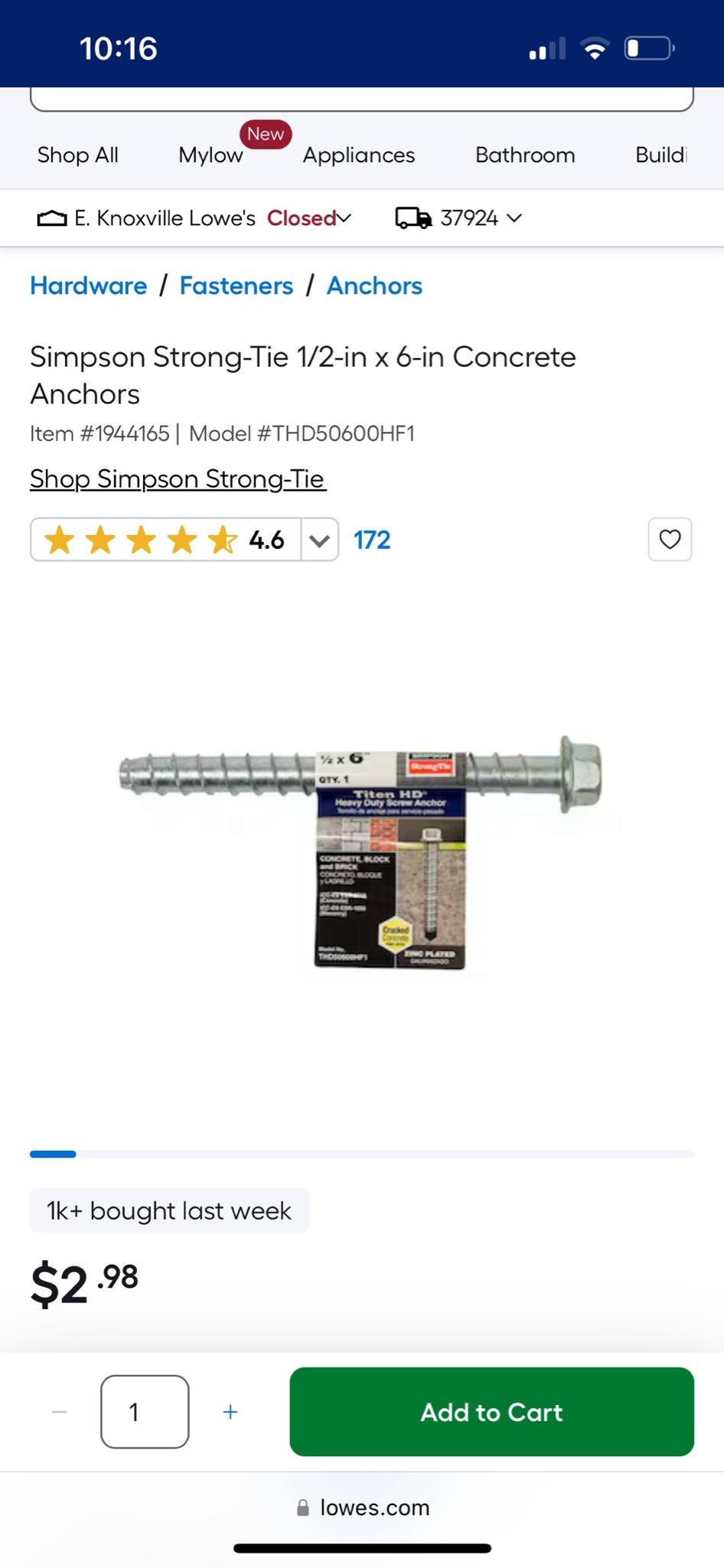

May not be what you want but I was supplied with Simpson Strong-Tie Titen HD 1/2 x 6" for the brackets on my timber frame. I'm sold on their product. I put them in with a 1/2" impact and never stripped one out.
