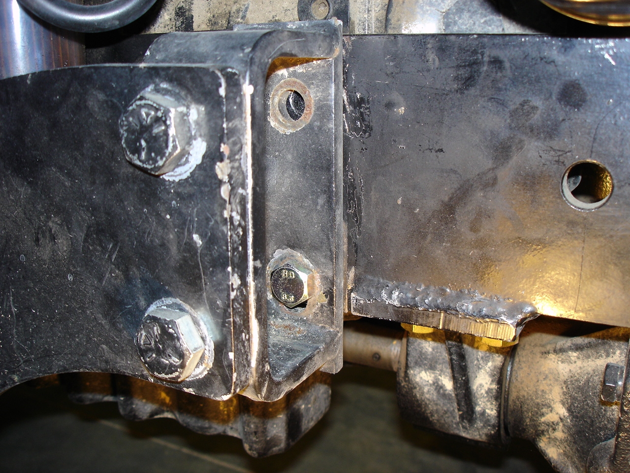

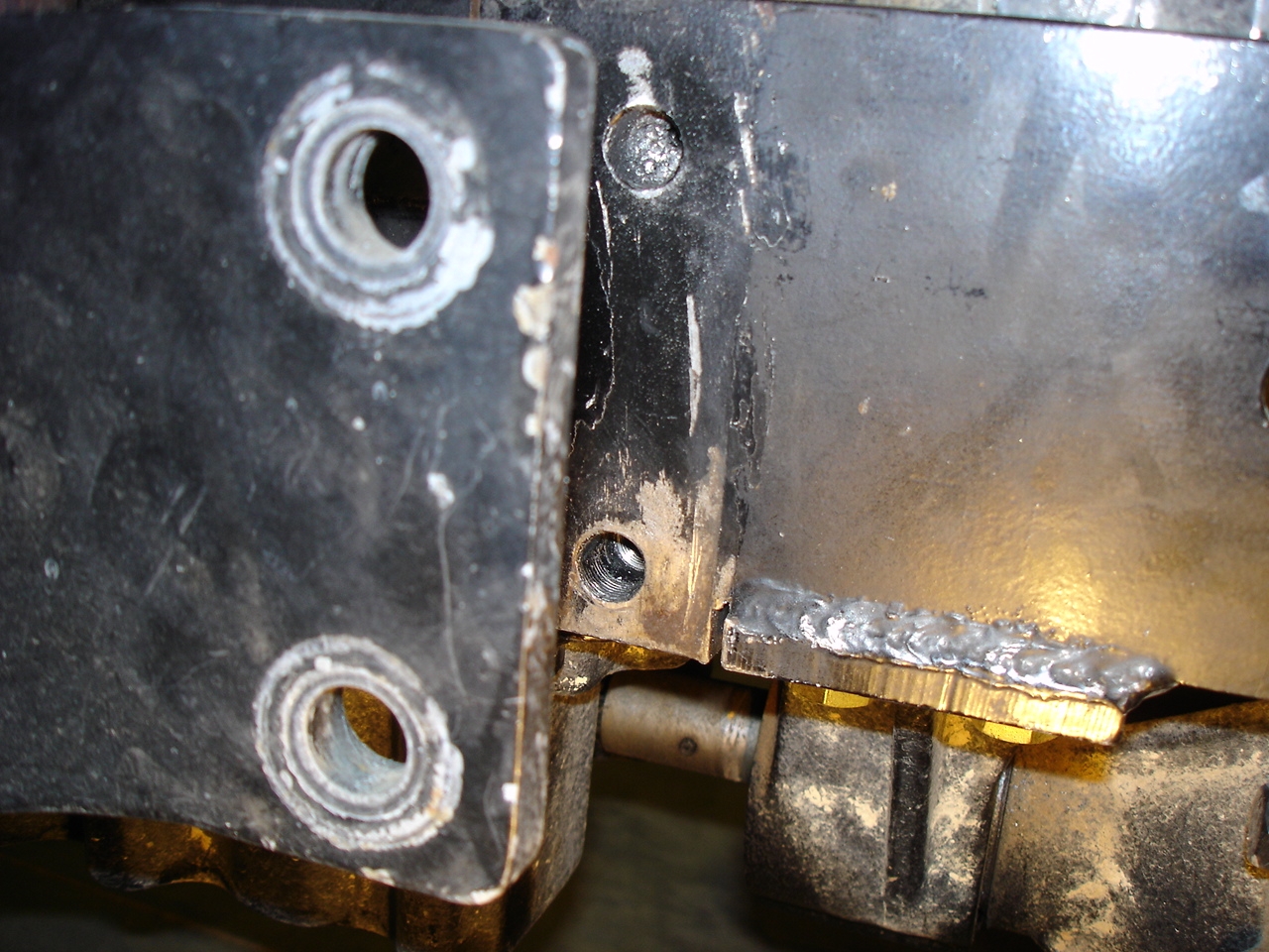

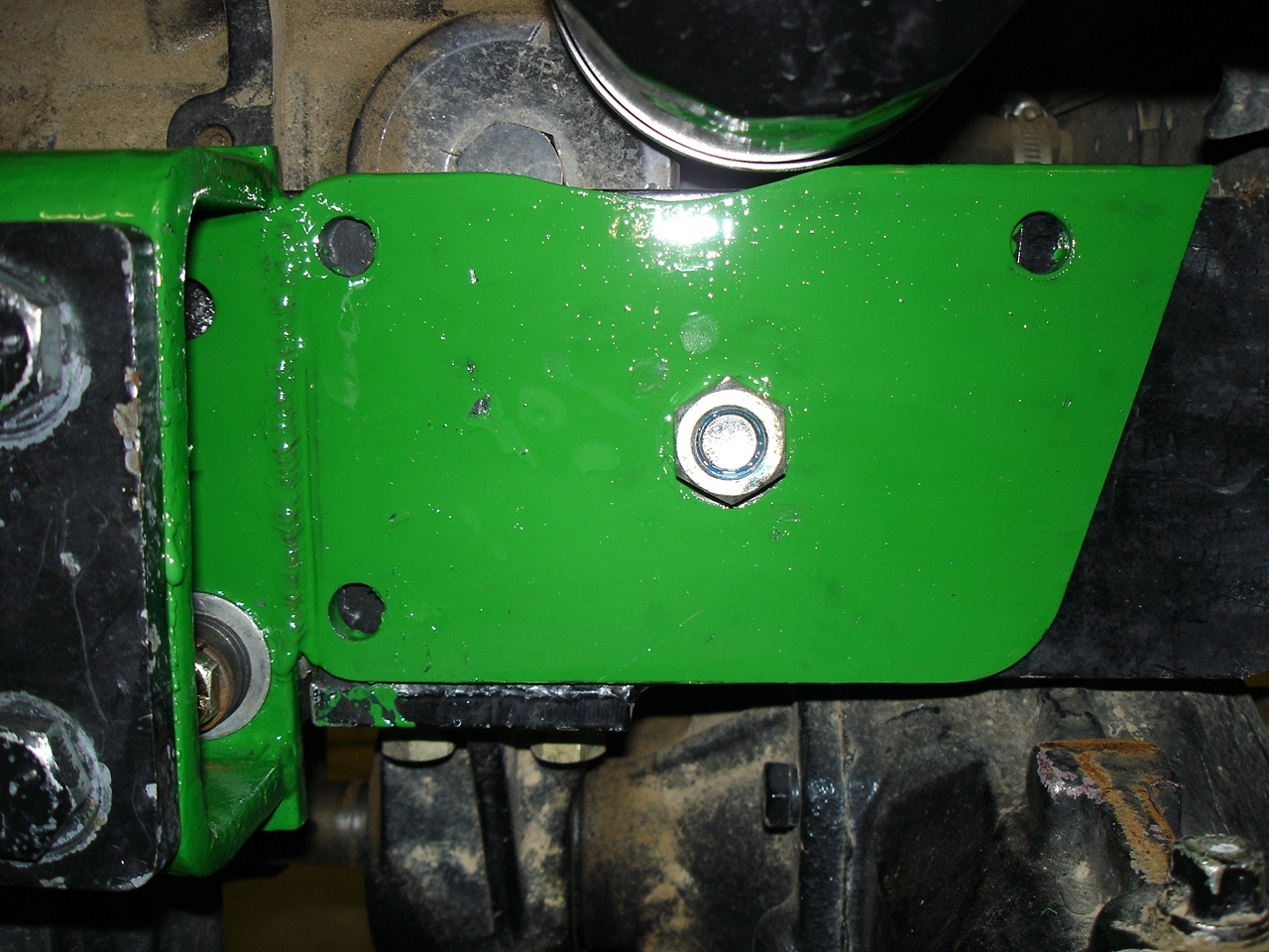

Here are some photos of my FEL mount repair, showing the bolts that broke off in the block, the stock forward mounting bracket, and how I modified it so I could utilize one of the holes already in the frame. I did both sides this way. I painted the new brackets JD green in protest of Farmtrac going under.:)

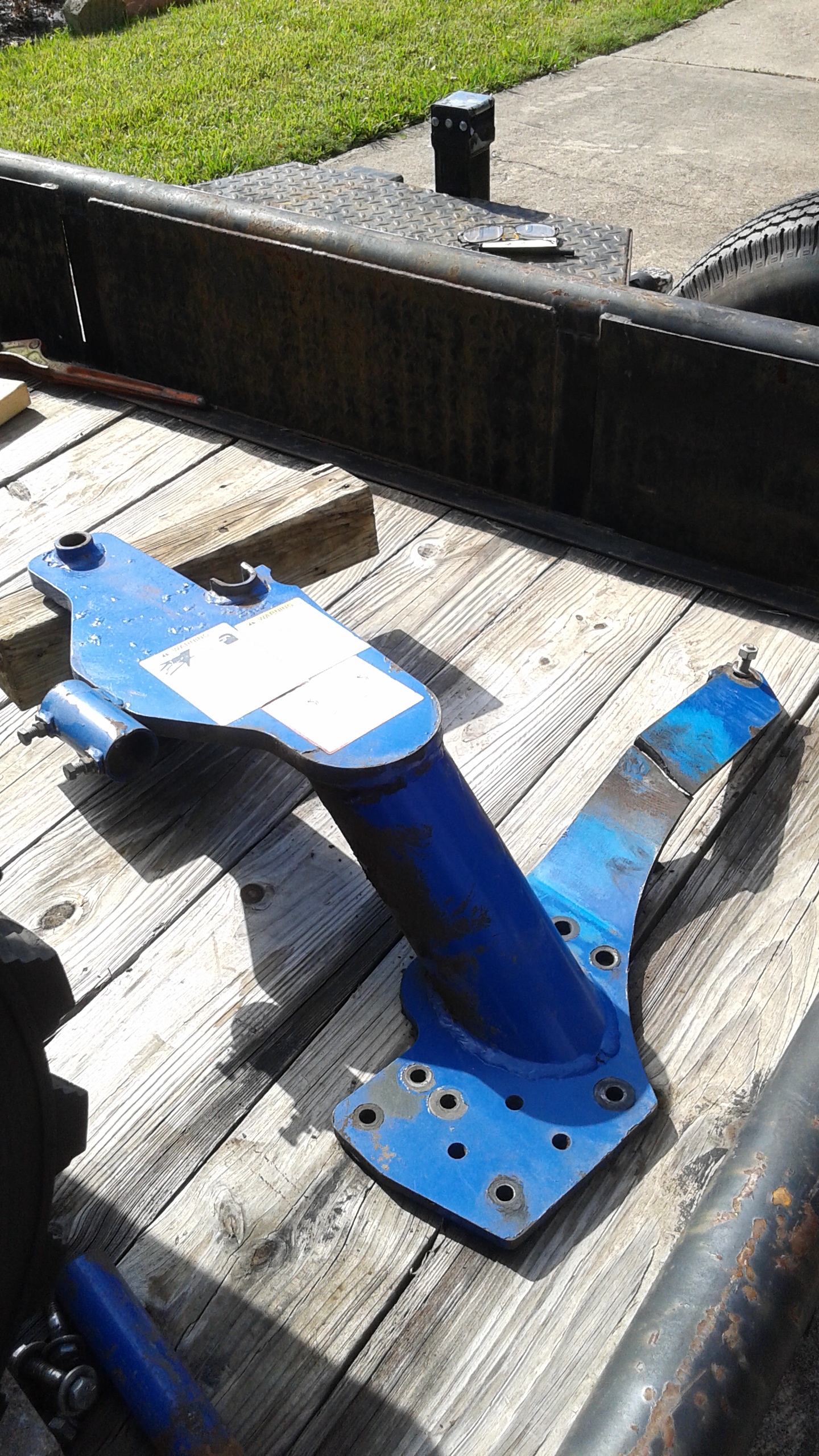

I'm resurrecting this thread because after 370 hours and plenty of full buckets of stone, I noticed that the entire head of one (of 4 per side) of the rear loader bracket bolts sheered off entirely. I was partly relieved because not too long ago while using the bucket to move stone, I heard a crack. Nothing more ... just ... CRACK. I knew it wasn't good, but didn't know what the heck it was. Now I know.
Anyway, what I know about fasteners, including bolts, is just enough to be dangerous. Therefore I'm here asking for help. The 7 heads of the bolts that remain on the (rear section of the) loader bracket unit read "J D 10.9" Ryan03 wrote above: "I changed my bolts with the metric equivelent of a grd 8 bolt, I think it was 10.9"
Are bolts for this application categorized by both size and hardness? What exactly do I ask for when I go to the hardware store? I do have a set of bolt removers (E-Z out) and a counter clockwise cobalt drill bit. I may be getting back to you to determine which of the E-Z extractors I will need. I'm armed with:
-5pcs Multi-Fluted, Machined Alloy Steel Screw Extrator Size: #1-#5
-5pc Left-Hand Cobalt Drill Bits Size: 5/64", 7/64", 5/32", 1/4", 19/64"
Finally, I had to laugh when I read the following on the package: "Remove Broken Screws Easily"
They don't know who they are dealing with in my case.
