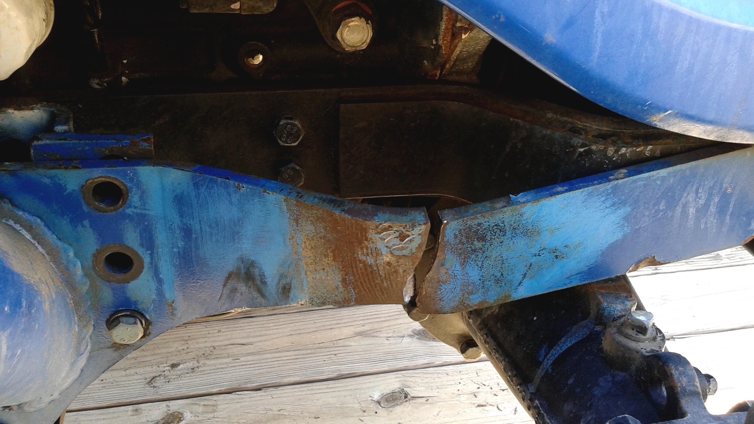

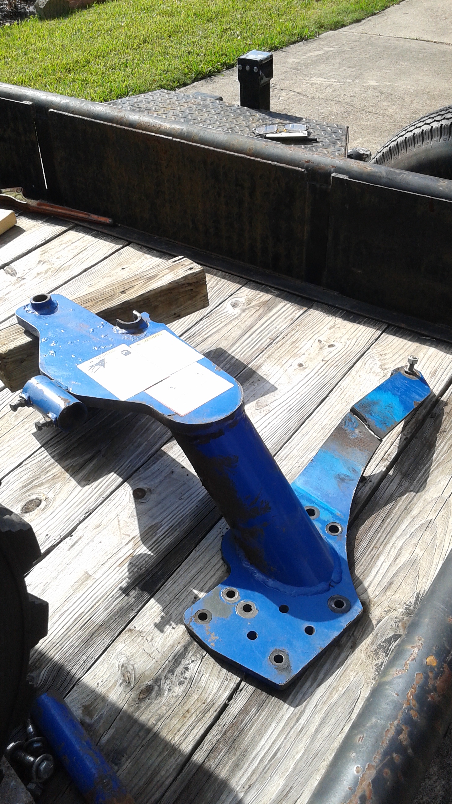

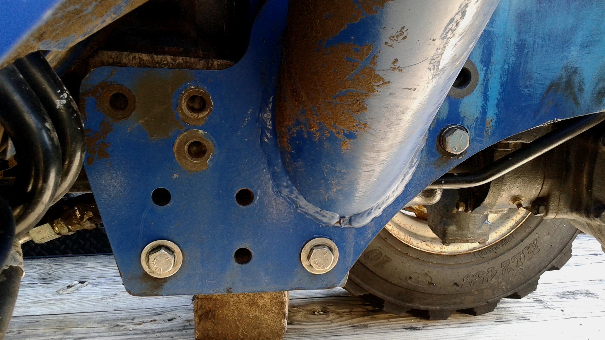

Same story on my 2007 Farmtrac 300DTC right side bolts and right bracket. Three broken bolts sheared off deep inside and support bracket broken in half.
I can't seem to get the bolts out.

I had the same problem with the broken bolts and didn't have enough bolt left outside of the threads to get an easy out extractor on, so what I did was take my wire welder and I kept building up the head of the bolt until I had enough to get the extractor on, it worked like a champ on every bolt.

I realize this is an old thread but I have this issue reoccurring on my 360dtc and I has been redone with 1/2” bolts and 9/16 bolts and now I am doing it with 5/8 bolts. I drilled out the 2 most front holes in the frame on both sides to use them since the factory did not use all the bolts in the block and I fabricated plates to the loader frame out of 5/8 plate to also use the front 4 holes of the frame on the front as well as the 4 in the back and 2 into the transmission. The loader brake ts have broken before and have been welded and plated. My tractor never came with a support from the bottom of the loader frame to the rear axle like most tractors have so I am fabricating them and so the bolts don’t back out I am going to be using red locktight on everything and I think I’m going to tack every bolt head to the frame so they can not loosen up. I also have noticed a small loss of coolant and I can not see where it is going so has anyone seen anything on that?
