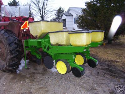

   / FarmWithJunk opinion needed #30
Like this?

   / FarmWithJunk opinion needed #31
Hey FWJ: If you get that fertilizer spreader ready to sell, sign me up for the third one. I have a very good Flex 71 four row planter. It is built to work off the TPH. I plant about 15 acres of corn a year, and this is a great design for me. Now, all I need is a way to side dress the seed with fertilizer.
   / FarmWithJunk opinion needed #32
I've been side tracked for a few weeks, dealing with health issues. Not a lot of time in the shop lately. Looks like that may be turning a positive corner though. Fortunately for me, I've got a planter w/ fert. capabilities for this season. I'm hoping to have my "invention" done in time for next year.
