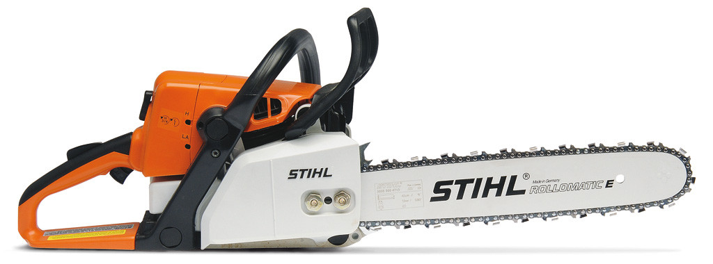

I made a marking gauge out of plywood and measure each piece. I did that after my first season of burning. As I was cutting wood in my forest I would get fooled as the diameters changed. I had to recut a lot of pieces to fit in my boiler. I do know the points on my saw(s) to gauge with but I prefer the separate gauge. With the cutting I do out in the woods an attachment to the saw would be in the way and I would need it on both sides of the bar.
Doug in SW IA
   / Farwood measuring guide for chainsaws... #24
I'm an idiot, I use my bar. Just make marks with the chainsaw.
Usually only buck a little at a time.
I do too. I turn the saw as I move up the log. Line my "16 inch place" on the bar with the end of the wood and look where the tip is as I step into final position. Turn the saw on its tip and get after it.

I'm an idiot too. I scribe a line 16" & 14" (for one customer liking shorter lengths) back from the tip on both sides of the bar and brush bright red paint over the scribe marks with a thin brush. When the paint wears off the bar's surface I have a crisp thin red line down each side of the bar at 16" & 14".

I'm an idiot AND lazy. I just hold the bar sideways for a second and eyeball where the tip is. If I get tired I just go and ride around on my tractor for awhile to refresh myself.:thumbsup:
As well, my fireplace is quite wide, so the length of the logs doesn't need to be very precise.

Does your bar have that hole about 4 inches back from the tip? That's where you put your all-thread length guide.
