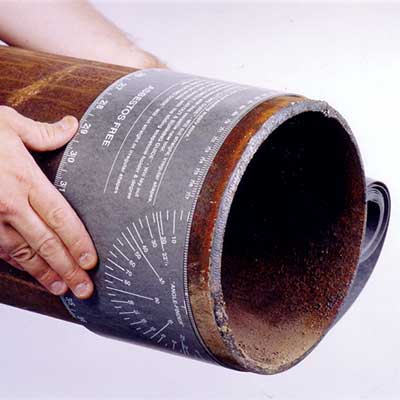

How about putting a band around the log and marking all the way around. Should be able to get nice even and straight firewood chunks. Just move it along the log and remark as needed. The last piece may not come out even though.

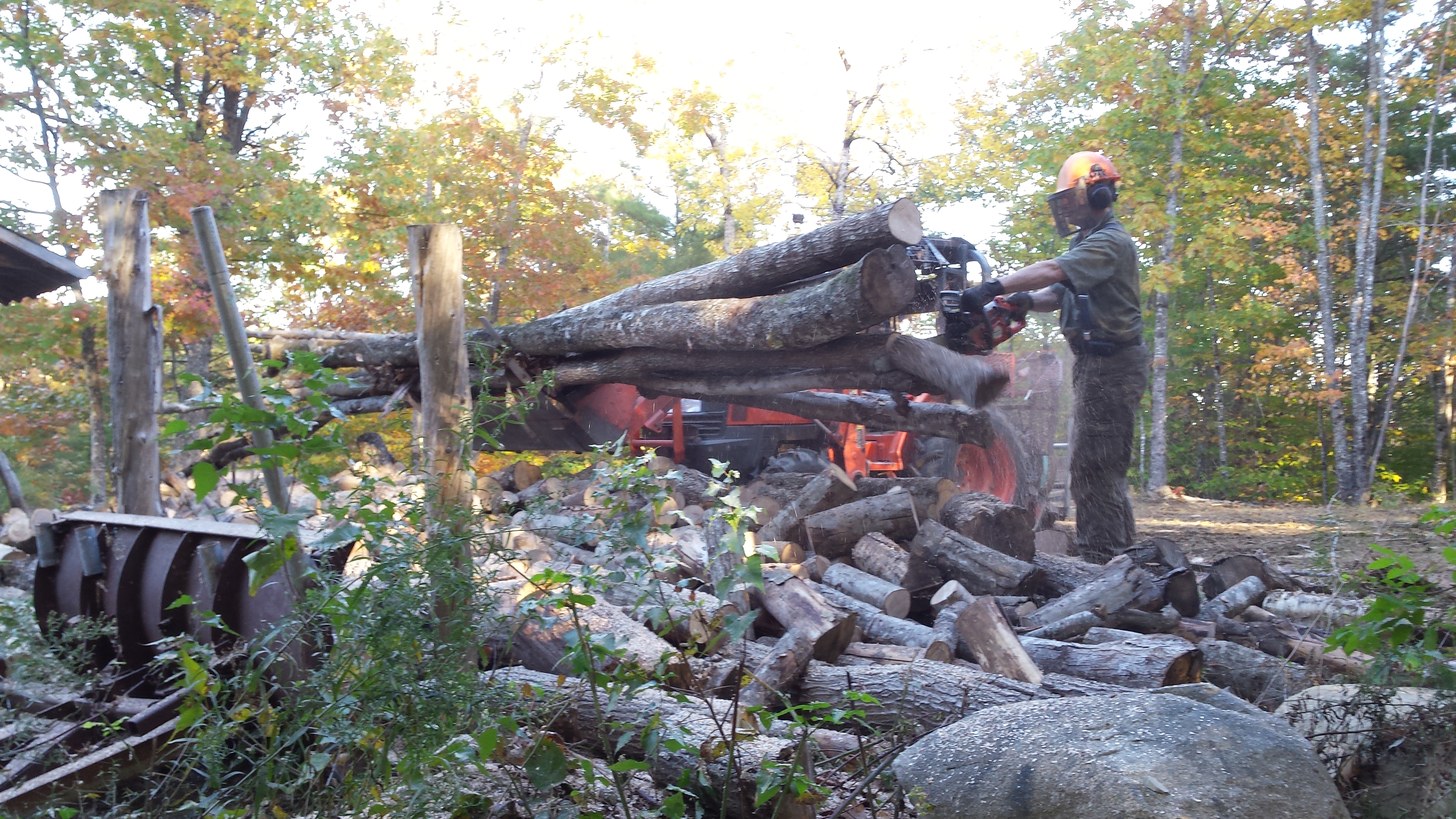

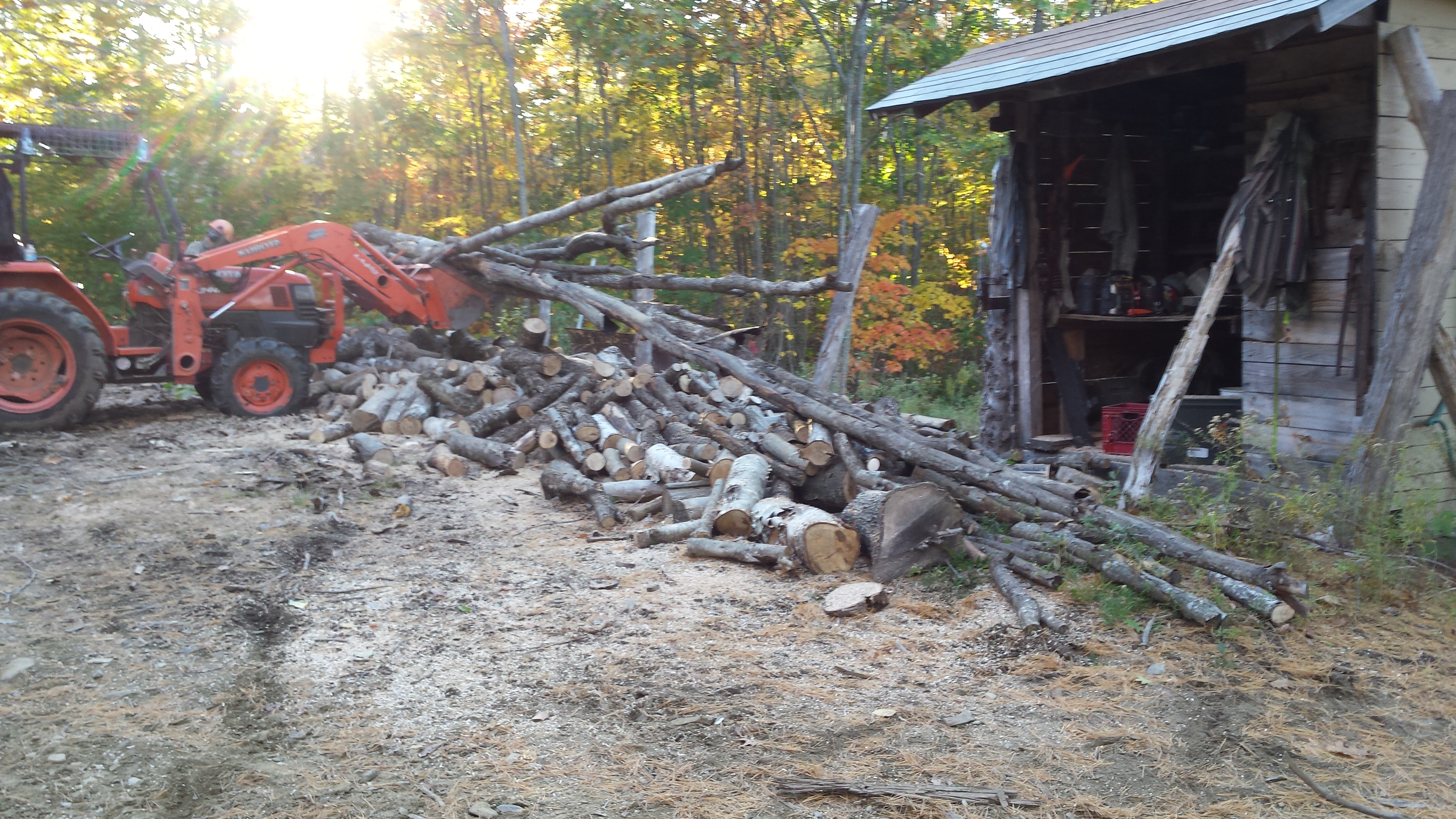

I give the Cut-Rite chainsaw guide 5 stars, finally got a chance to used it today for a couple hrs., takes a hair longer to put on but less than 1/2 a hair in time to take off, comes off in a snap, no hand dancing the saw, just lay the blade, boom right there 16"> stick after stick until I get to the middle of tree from both ends, tip the bucket finish up the middle 6'-ish, the smaller ends I make 18-20", I left the guide-rod at 18" with piece of tape at 16". Works the best from right to left, from left to right have to pick a spot on the tree for the next cut while finning the first cut, no more wood over 20".
Amazon.com: Cut-Rite Chainsaw Firewood Measuring Tool-Accessory, Detachable, Flexible, Stick, Cutting, Mounts directly to bar nut.: Patio, Lawn & Garden
There's no imaginary hunting for the 18" inch guide, if you cut wood with clothes on then unplug the guide and stick it in the back pocket for refueling. I added a 1-1/2" X 10" small block of wood to my saw carryer, drilled 3/8" hole in it to stow the guide. I also had to add an 3/4" X 1" deep slot in my saw carryer because the plug-in nut is almost an 1" long, I picture of my saw carryer somewhere, might have to grab another one, in the mean time here's a couple pics. from last season when my son stopped in, same game this year only difference is now the wood is Cut-Rite
