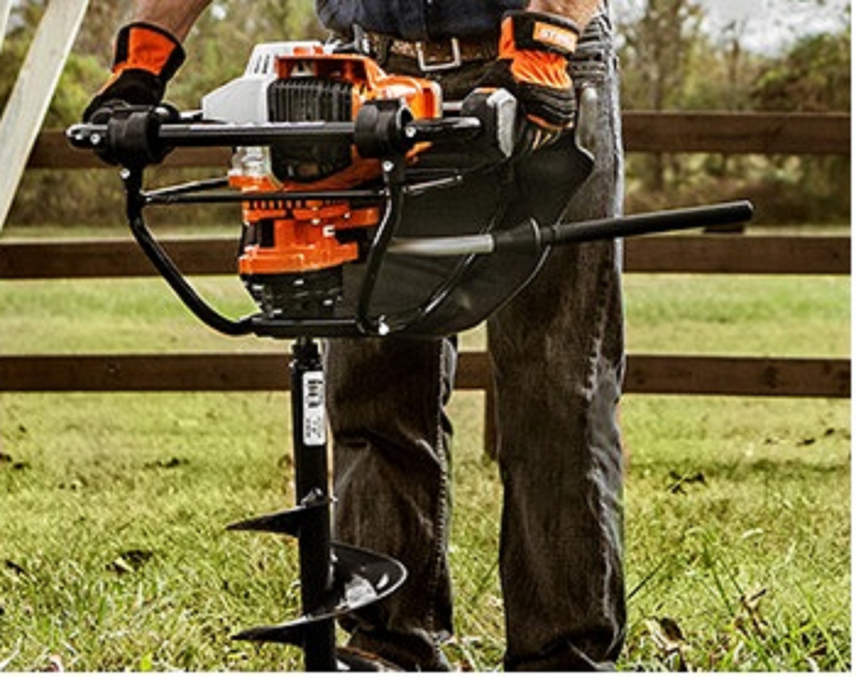

I have a Stihl BT131 and would recommend it to anyone wanting one.
It is a well designed unit and has safety features that I doubt the Harbor freight unit has. As poster leonz mentioned if it hits something hard it can twist hard, very fast.
The Stihl unit has a clutch disconnect that you can see in the picture which is the "bar" that stick out to the side. It works great.
I would NEVER ever try to use one without the disconnect for the reasons that have been mentioned.
Not cheap but worth the design cost if you really want one. Now if you don't like and want to get rid of your FIL then encourage him to get the Harbor Freight one.
