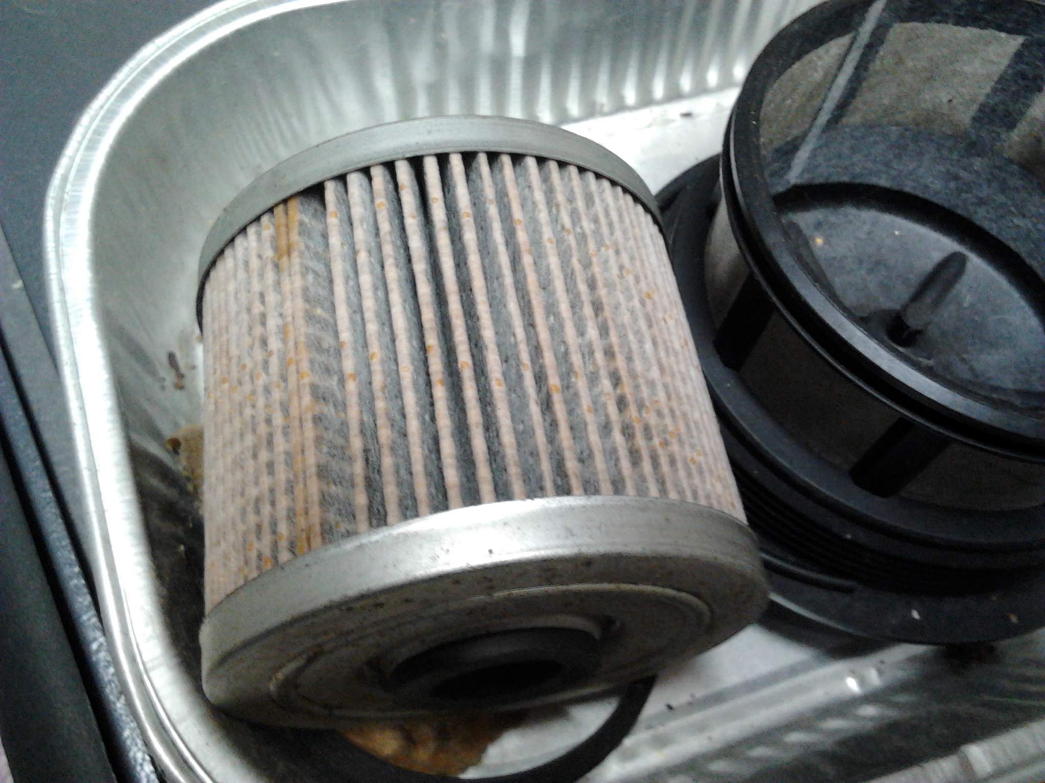

Personally, I don't care if an additive boosts mileage at all; so long as it doesn't decrease mileage, I'm good.
What I've after is longevity, and decreased nuisance (clogged injectors) problems.
This is the diesel fuel filter that came out of my 7.3, changed at the factory interval.
I dose with Stanadyne, at the prescribed rate. Even in your hand, that filter is hard to distinguish from new.
Bought the truck used. The filter that came out was black as coal - same goes for the trucks I see down at my friends commercial garage.
Do the research on veggie oil conversions. One issue commonly encountered when converting an old diesel to veggie, is that a lot of the crud sitting in the system gets flushed - you end up changing fuel filters many times in a short order, till the system gets cleaned out. High bio-diesel concentrations act in the same manner on old diesel fuel systems.
Bio-diesel is very rare in my area, let alone in the high concentrations that exist in parts of the USA. If my diesel additive does nothing else but keep my fuel system spotless, then I consider it money well spent. I change my fuel filters myself, but it's not something I want to have to do when I'm driving through the USA on vacation.
I don't imagine that you see extended -40 temperatures RI way. Anti-gel and cetane boost come in real handy at those temperatures. The point in my ramble here..... not everybody has the same goals for additives.
If one sees no need, of course, don't use 'em :) .

Personally, I don't care if an additive boosts mileage at all; so long as it doesn't decrease mileage, I'm good. What I've after is longevity, and decreased nuisance (clogged injectors) problems. This is the diesel fuel filter that came out of my 7.3, changed at the factory interval. <img src="http://www.tractorbynet.com/forums/files/oil-fuel-lubricants/398271-favorite-diesel-fuel-additives-2014-11-12-17-36-a"/> I dose with Stanadyne, at the prescribed rate. Even in your hand, that filter is hard to distinguish from new. Bought the truck used. The filter that came out was black as coal - same goes for the trucks I see down at my friends commercial garage. Do the research on veggie oil conversions. One issue commonly encountered when converting an old diesel to veggie, is that a lot of the crud sitting in the system gets flushed - you end up changing fuel filters many times in a short order, till the system gets cleaned out. High bio-diesel concentrations act in the same manner on old diesel fuel systems. Bio-diesel is very rare in my area, let alone in the high concentrations that exist in parts of the USA. If my diesel additive does nothing else but keep my fuel system spotless, then I consider it money well spent. I change my fuel filters myself, but it's not something I want to have to do when I'm driving through the USA on vacation. I don't imagine that you see extended -40 temperatures RI way. Anti-gel and cetane boost come in real handy at those temperatures. The point in my ramble here..... not everybody has the same goals for additives. If one sees no need, of course, don't use 'em :) . Despite the photo op nonsense, fuel mileage is not really a top priority for govts. Gas engined cars today basically get the same mileage as my friend's 1978 Rabbit. Rgds, D.
I guess the question for you is what evidence is there that the fuel additive keeps your engine and fuel system more reliable. I can certainly understand that would be a reason to use an additive even if there were no other benefits but 1) other than anecdote what evidence is there and 2) are you sure the additive does no harm?
