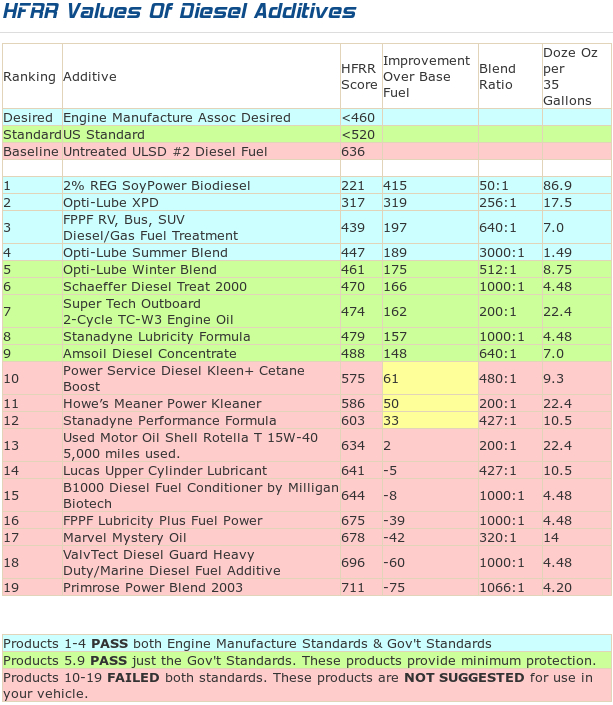

   / Favorite Diesel Fuel Additives #56
image-3978207329.jpg Test results from diesel place I think independent lab results
Note that "untreated" fuel means that before different retailers add their own additives, to illustrate a "worst case"
   / Favorite Diesel Fuel Additives #57
<img src="http://www.tractorbynet.com/forums/files/oil-fuel-lubricants/397828-favorite-diesel-fuel-additives-image-3978207329-jpg"/> Test results from diesel place I think independent lab results Note that "untreated" fuel means that before different retailers add their own additives, to illustrate a "worst case"
Saw this report years ago when I started buying diesel cars, I was surprised to see using bio diesel if you can in your area is one of the best things you can run in the fuel. I use power service in winter when the bio comes out, the diesels all run better with power service. HS

1) Thanks for the update on FedEx operations. I keep forgetting about "outsourcing" in business these days.
2) I would still rely on the engine manufacturers both to state maintenance requirements (fuel type) and to work with fuel suppliers (big oil) to insure that fuel for sale equals the fuel needed. Understood that there are extreme condition exceptions but in general I have a tough time imagining that fueling up anywhere on US 70, 80 or 90 across the country is going to cause any harm to an engine.
3) Firemanmike's chart shows that some additives actually decrease ?lubricity. How do you know that you are not harming your engine by added something that increases fuel mileage by a few percent?
