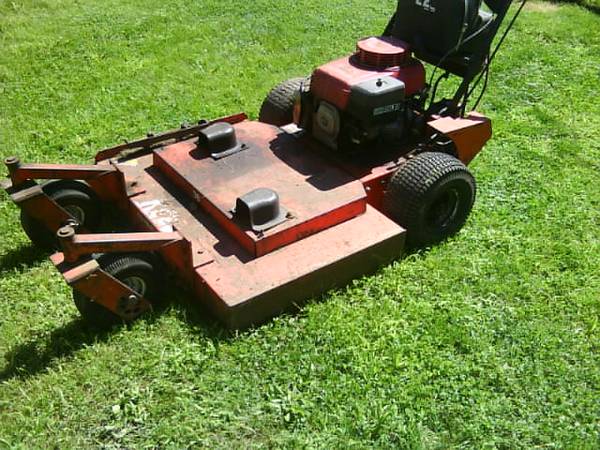

Picked me up one of these.. has a blown 8hp Honda motor. I found it originally came with a B&S 12hp and I have a B&S 11.5hp that can go on it. Belts need changing, but its complete, spindles are good, blades are good, NO rust holes.. very very solid..
Paid $75.. Good deal?
Anyone know where to find the manual? I found one for a mid 90's Eglestar 1 wich is the closest I could find to match....
1987 FD Kees Model 361860P
Engine Cycle: 4
Engine Horsepower: 12
Engine Make: B&S
Cutting Type: Rotary
Cutting Width: 36
Cutting Height: 1.5-5
Self-Propelled: Yes
Weight: 408
Thanks!

I'm just getting ready to work on one of these...mine's a 1989 Snapper badged version...don't think they changed anything until going to peerless gearboxes and double-wide wheel drive belts. I have the manual but I'll have to try to figure out my scanner.
Any specific items you're looking for?
Don't see how you could go wrong for $75, pair of rear tires costs that much.

I don't know my scanner but I do need to get you some pics of cutting height adjustment. Clearly a failed design by way of others, very neat though. Should be able to get some good results, Those funky front casters are only part of the puzzle. She'll go 1" to 5", you'll need the pics/description. More versatile than some modern offerings?

Well, first major glitch has been encountered and I don't have the machine available for a good look.
Can't find brake bands. Never replaced them on this mower and *assumed* it would be like any other commercial mower. Nope, it appears you need assemblies that have the band attached. Expensive. $35-50 depending on which side.
Need to research re-lining, I'm not throwing another hundred bucks towards brakes. All the modern bands I've installed in recent years have adhesive to hold the linings in. Can't be too hard to replace the friction material. Brakes are critical. Once you cross reference some parts the availability opens up but the prices remain steep.
Snapper #'s are 76339/76340

Question: Are your drive belts 44"? I bought 44's but they seem way too loose even with adjustments, but 43" ones wont even go around the pulleys?

44" is specified and a I have a pair sitting here and they look to be appropriate, still haven't driven up to pick up the old girl. I'll try to get you pics of the oddball cutting height configurations if not figure out my scanner feature and do the whole manual for ya. Should have my machine here this weekend, really want a good look at this "brake assembly" bit. I worked for a company that ran nearly identical John Deere commercials back a lifetime ago, LOL, try to research that crap, JD is wishy-washy when it comes to commercial machines. Guess it's why the basic Scag and it's clones are easiest to cross reference?

On this note, belt/brake wear is dealt with by the threads on the long brake op rods that go to the handles. You'll just need to back these off or tension them down. There's a fine line in braking and steering that takes 15min to 1/2 hour to get braking and tracking coordinated. Can't do it without the machine running.

Ya.. I adjusted them about halfway up each threaded part of the operating rods and there still is way too much slack in the belts.. Theres also 3 different holes for the brake actuator. Mines in the 'tightest' one now.. Whats funny is the old belts work perfect but measure out at a little over 43.5".. Wouldnt think 1/2" would make that much difference..
