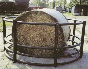

4) Buy a hay ring and put whole bale in. (my pick)
We have 6 foot bale rings that have 18 head slots, one 4x4 roll lasts a day in them, so we feed daily.
Payback on a bale ring is very fast, my estimate is that the cattle tramp/waste 1/2 a bale if unrolled flat. They don't waste hay in a ring.

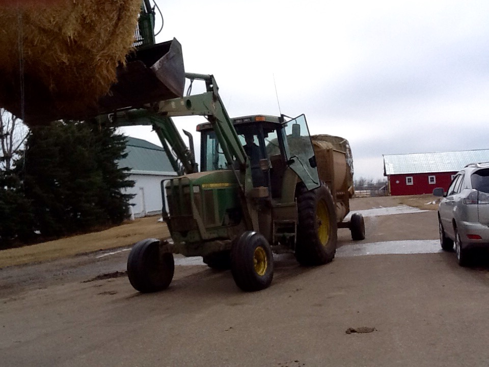

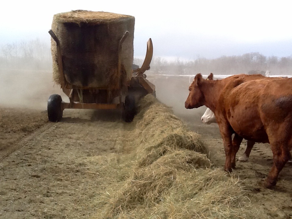

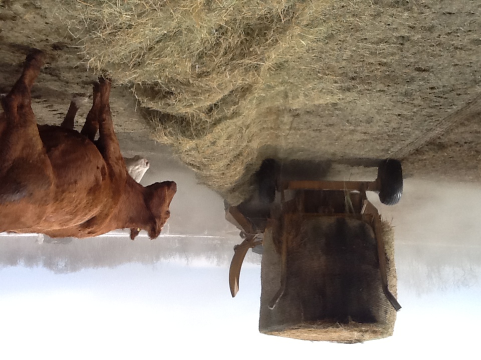

Here's a rig a friend of mine uses?
