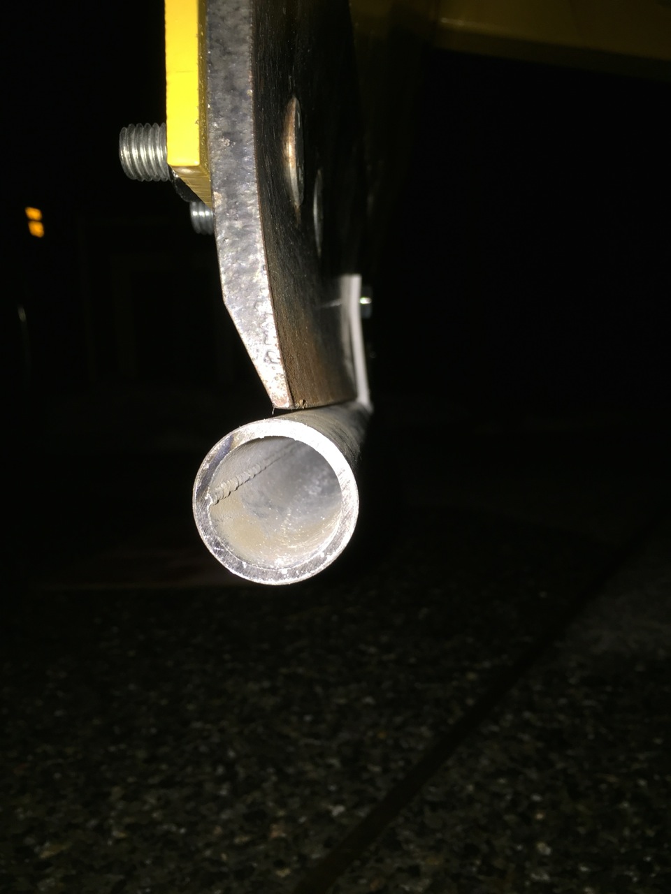

Put a pipe over the cutting edge (you can search on TBN -- it's a popular suggestion). I have tried a few things, but like the pipe best of all. It lets me scrape down through the snow without digging into the gravel. Here's a pic of the pipe edge I made:

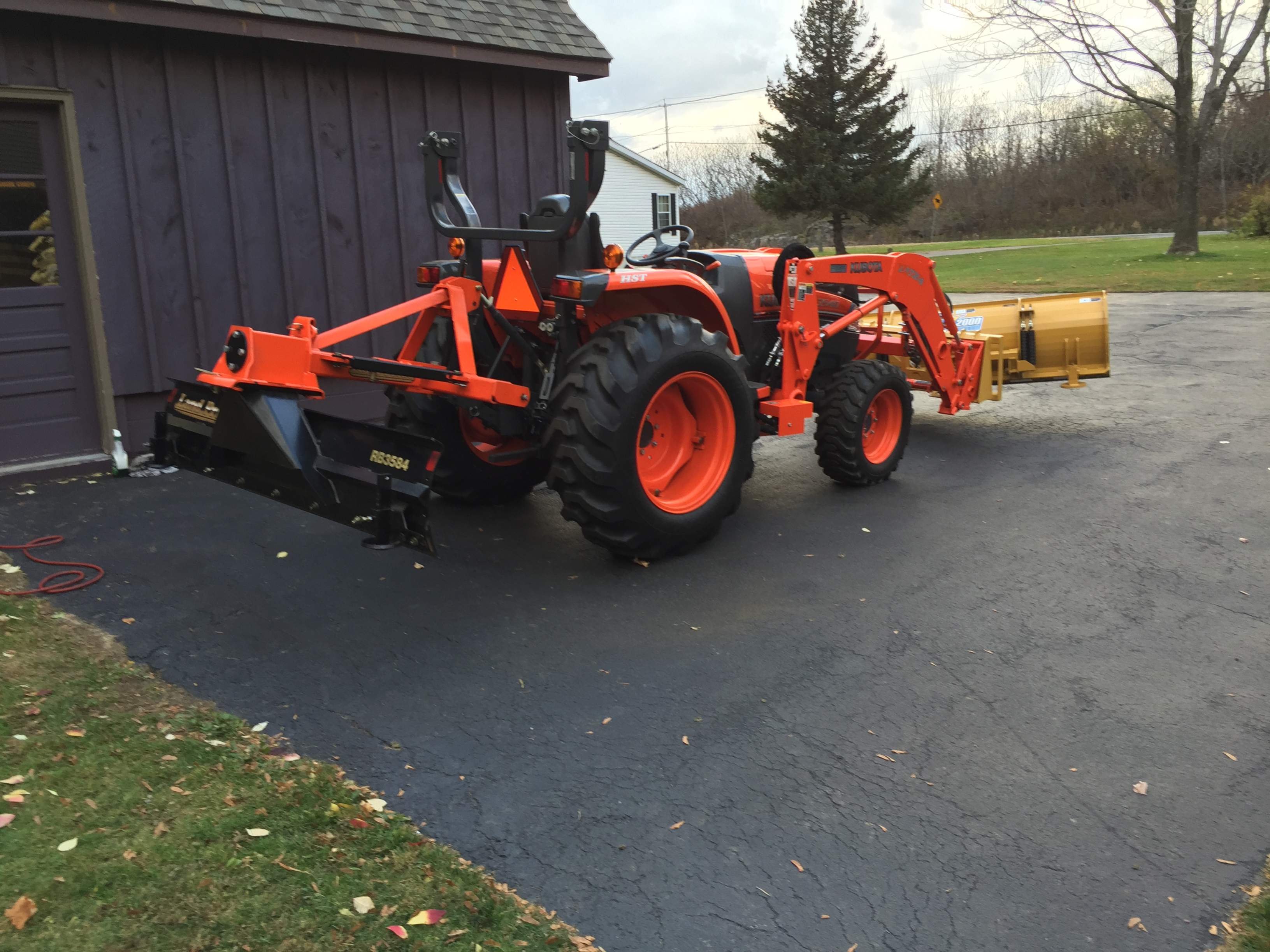

You need bigger shoes, the ones I have on my RB3584 Back Blade are mushroom shaped and do not dig in when ground is frozen, whether pushing snow on lawn or gravel but when ground not frozen just the heavy weight of the blade is enough to cause shoes/skids to dig in.
