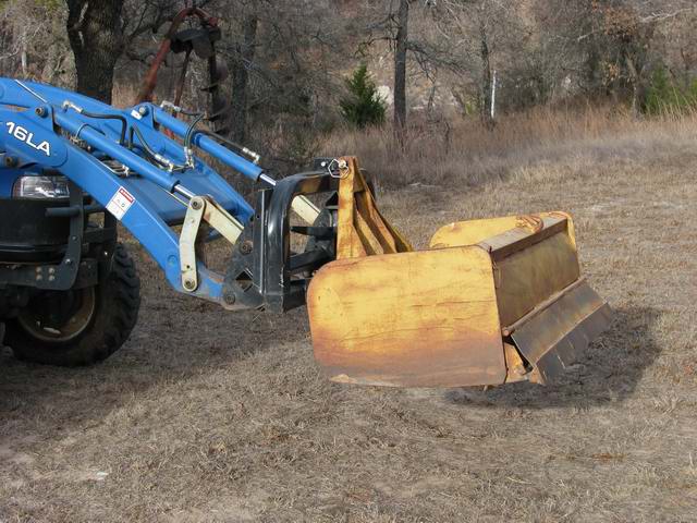

   / FEL 3PH attach? #5
Be careful if you get a boxblade on the FEL. You won't know if you're coming or going.;)

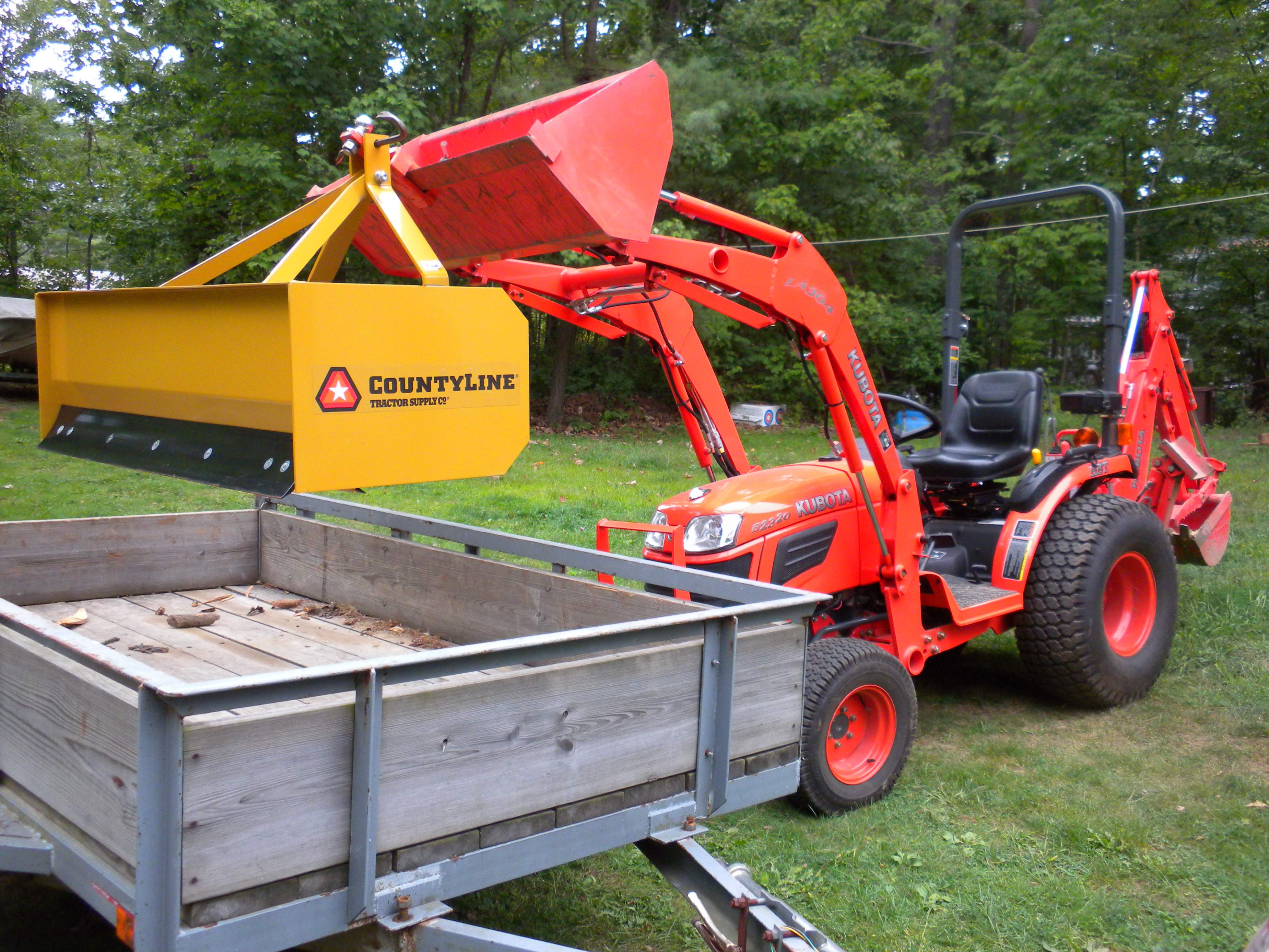

   / FEL 3PH attach? #6
I funagle stuff with my trailer ball setup.....works good for moving/stacking
