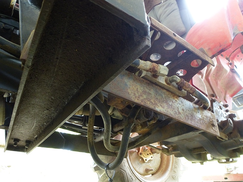

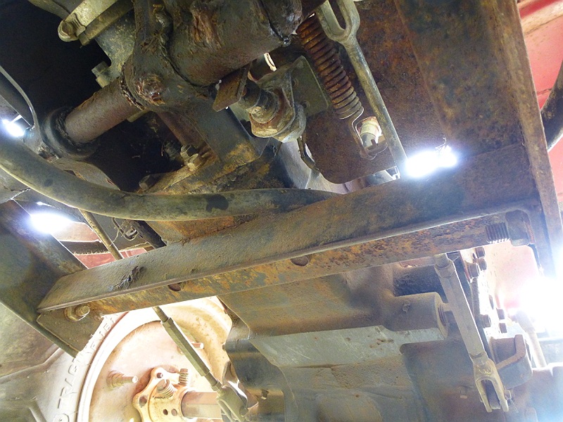

Ok, I'm home. This is a YFL650 loader on a YM186D. Here are pix showing the only bolts that go straight up from below. All views from below operator's left foot.
1) Two bolts at Right side (only) of front crossmember:
2) Rear loader crossmember is bolted upward to transmission:
I tried taking photos of the bolts into the side of the engine block by the starter and over on the opposite side. It's impossible with the power steering cylinder and hydraulic lines blocking any view. But those locations are obvious and you couldn't overlook a missing bolt.

.... ach I should have taken some pics last weekend when I was there; your bottom bracket bolt locations look right on the 2nd pic but different on the first one ... any idea of size & length? Thx cheers BC D

I'm home in town at the moment so can't go out and look. As I remember, the upward bolts at the right end of the front crossmember simply attach the mast on the right side that supports the loader control valve. Your YFL675 loader might be a little different than this 650.
As for the two bolts upward from the rear crossmember into the transmission housing - I'm not willing to remove them. I expect they are set with blue Loc-tite like a lot of other stuff that seems solid. But I'm pretty sure it is critical that you have correct bolts in there (and the bolts into the side of the engine block).

all the side bolts are intact; and it looks like the bottom ones have been missing for a while; understandable you don't want to loosen or remove them to check length or size; there looking like a 1/2" equivalent (what's that in metric 18mm?; could you size them with a socket the next time you think of it; thanks). I recall tightening all the bolts when I first got it; then seeing some bolts loosened and went around retightening again; and I should check again with some blue locktight.
