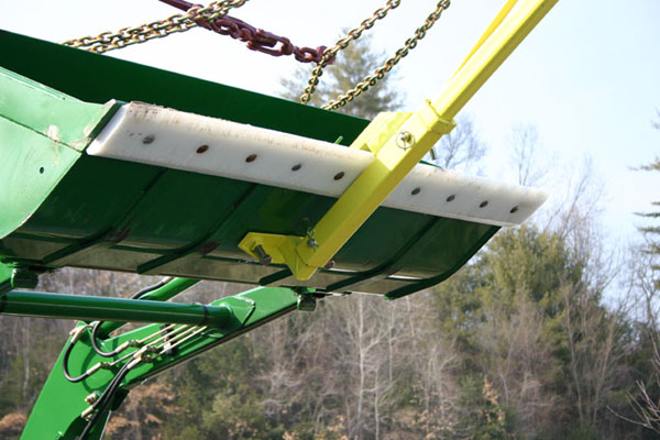

I finally had a chance to try out the FEL mounted boom pole I made last month. It started as a hitch receiver to move trailers. I was able to move my 24' enclosed trailer with a tongue weight of about 1,000 lbs with ease, so I thought I would see what it was capable of a little further out.
The boom is 2x2x1/4 tube which I cambered about 2" then added a strongback and chain slot. The pole is chained from the midpoint back to a pair of bucket hooks.

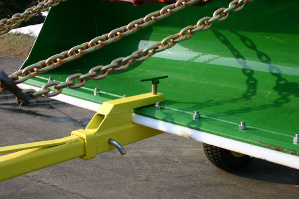

Bucket receiver clamps on over cutting edge

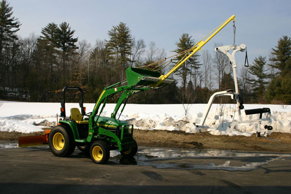

   / FEL Boom Pole
Lifting height is about 16'. I'll gain a foot when the 300cx loader arrives this week.

Nice work, but a word of caution -- that rig fully raised will also put your tractor's center of gravity dramatically higher and make it much easier to tip. Don't ask how I know this. /forums/images/graemlins/shocked.gif

jpr - Thanks for the heads up. I assumed anything raised to that height would be real unstable. I don't think I'll ever hoist anything to that height, I just wanted to use the reach to unload trucks.

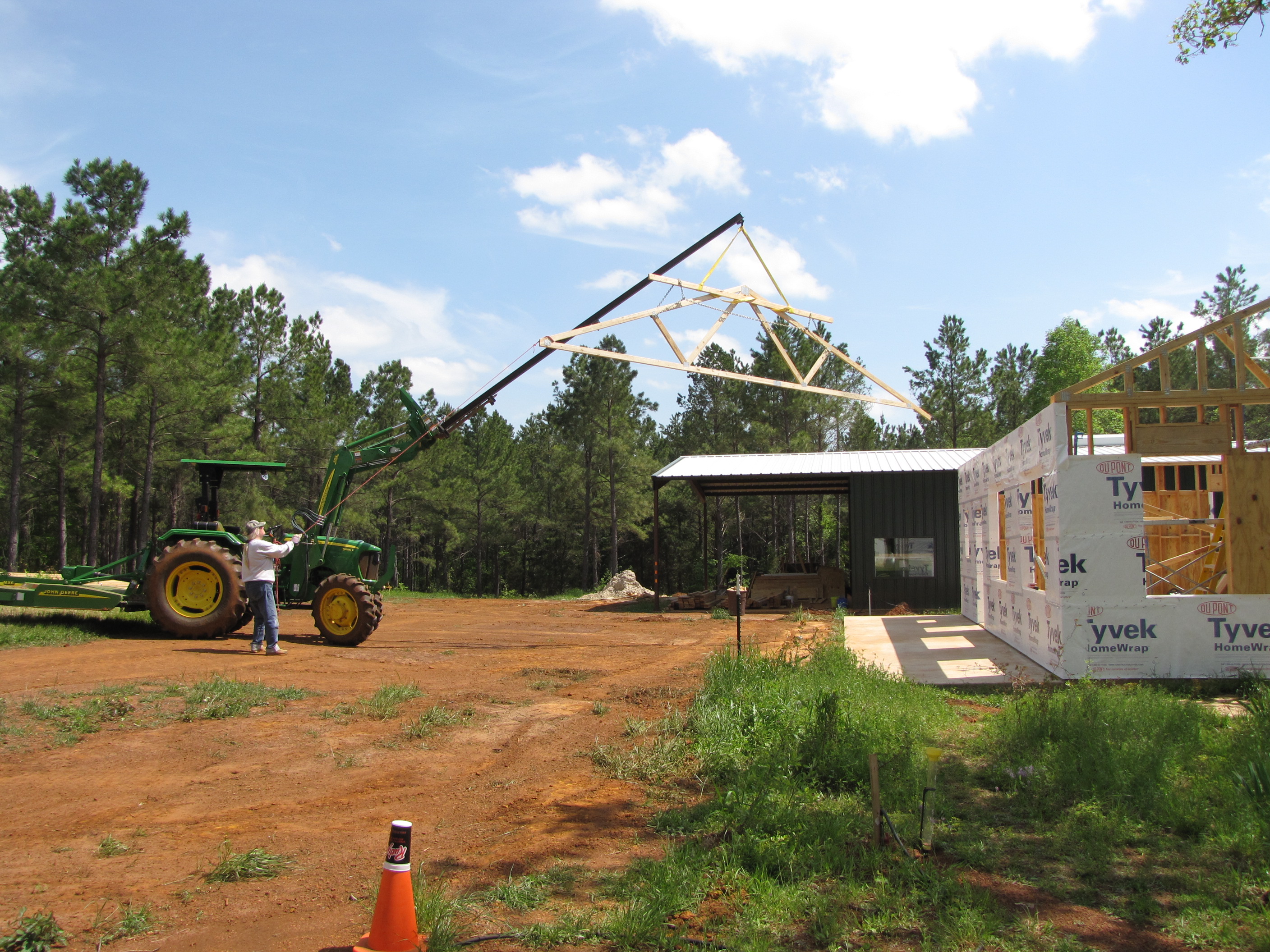

I'm interested in building one to set trusses on walls and sections of a Quanset building and probably other things. I don't want to over build and I like the use of a 2" hitch but it seems that putting it on the front edge of the bucket would place a lot of stress on the cutting edge even with the chains attached to the bucket hooks. I'm thinking the hitch receiver should go inside the back of the bucket with bolts thru the bottom and a brace up the back of bucket and a bolt there as well with a backer plate welded to the outside in the back of the bucket to spread the load across the plate.
Maybe I could talk myself out of using the receiver and just use 3 bolts to attach the boom to the bucket which would remove any slop that might exist between the receiver and the boom. I only have a 5' bucket so the side supports are only 2.5' apart or less and maybe rigid supports would be better set at maybe a 30* angle to the boom. 2" x 2" tube should work fine with the strong back but I want to be able to get it up to at least 18'...so... 7' from the bucket and a 14' boom so I can keep the truss away from the front of the tractor and not so the bucket blocks the end of the boom. Is that boom too long?
What do you folks think?

I used a set of pallet forks pushed together. Then a 20' long 4" or 6"? H beam and welded some straps on to hold it to the forks. There's a 3/8" steel plate with a 1/2" hole welded at the mid point and at the end of the beam to hook onto.
Remember to take it REAL SLOW with something like this - a 1" movement is magnified 20x at the end of that beam!!!
