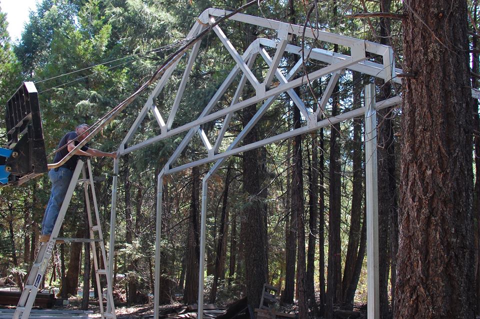

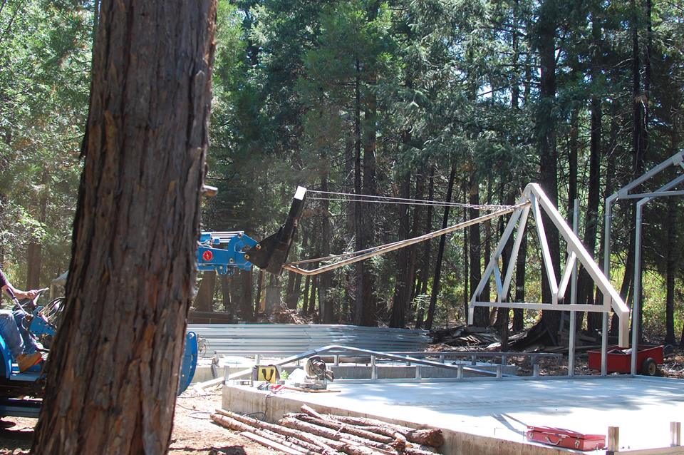

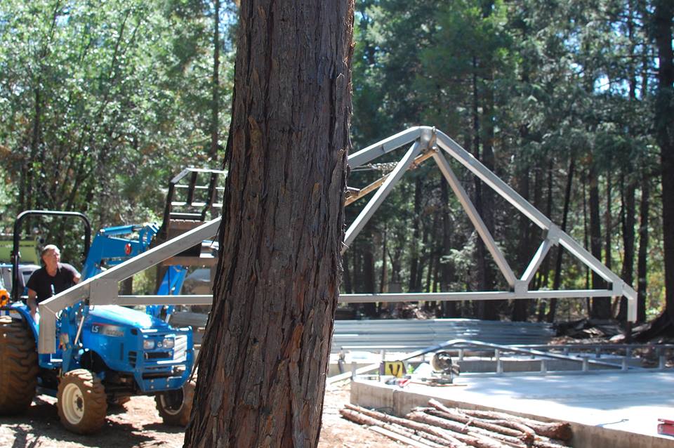

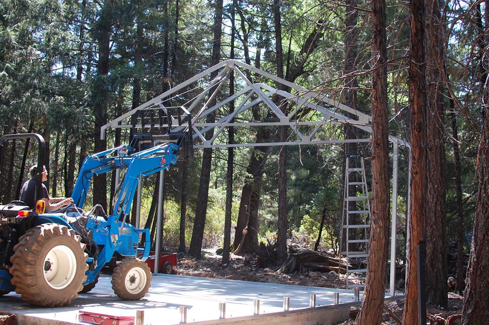

I don't know what year your Kioti is but I know the CK35 did not come with an SSQA for a long time - my buddy dfkrug has one and is hampered with a pin-on. The one I quickly cobbled together in an hour or so did the job nicely and is only intended to last as long as the project will take (lifting trusses) but it was mounted just about at the pins on a 2" receiver welded to the bottom transverse brace on my forks backer. When lifting trusses like this, we are really pushing the limits of a CUT's stability so slow-and-steady-and well thought out are the watchwords. Like using lengths of small logs as my ramp to climb onto the pad - NOT!
If you have to use your FEL bucket for the lift, yes, mount the receiver as close to the pins as you can get.
