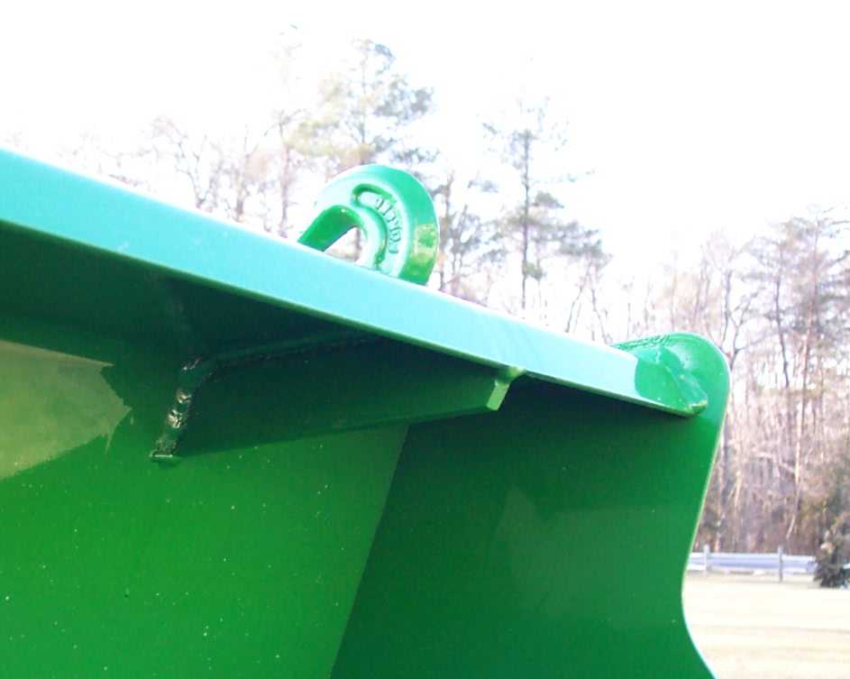

Here are a couple of simple 3/8" bucket "grab" hooks welded to a standard JD bucket. The technician added welded 1/4" steel gussets for reinforcement.

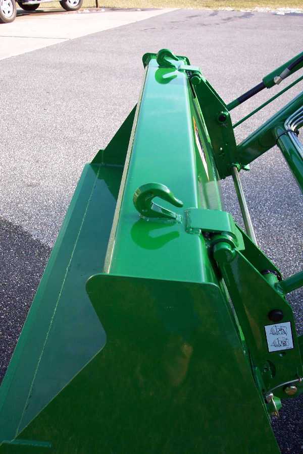

Pic: Welded "gussets" distribute hook load, add bucket top rigidity, and diminish general torsion forces on the bucket.

I like your setup. Simple and professionally done...should last forever and not distort your bucket when you use 'em a little more than you should...we all know we do that sometimes...heck that what a tractor is for!!

It was a stick weld. I also welded on a piece of angle across the top, to make the bucket stronger and give me a good place to put the hooks.
