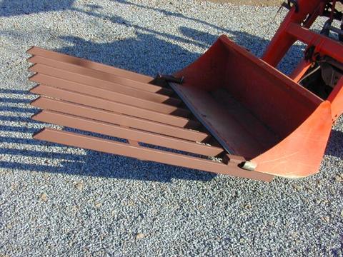

Yep, especially when proding under brush and logs. My 1/2" x 2" clamp bars bent just enough to loosen tightly clamped bolts after rooting brush and shaking it off in the burn pile. I have since bolted my brush forks on via the trailer ball hole in my bucket cutting edge.

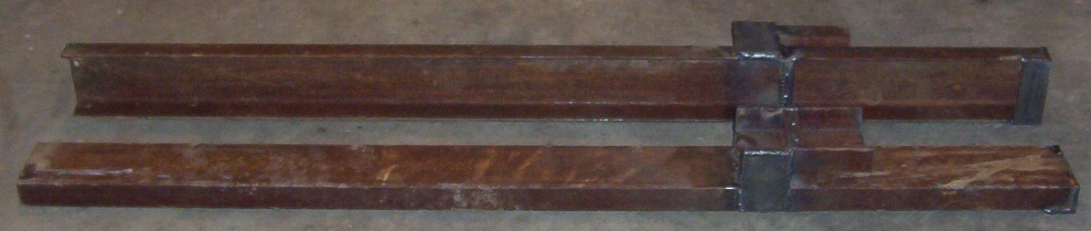

If your forks are twisting side to side then you have other issues. Based on what my customers have told me, there is no need to torque those clamp screws down to the point of bending the 3/8" steel top plate. The feet plus the fact that the front bottom pad edge should be as close as possible to the cutting edge lip should be enough to eliminate almost all twisting.
If your application is causing the forks to twist while clamped then I suggest you take a hard look at what you are doing with the forks and re-evaluate if you really need forks and not something else. My design is not intended to be a digger/mover, only a lifter/holder of items.

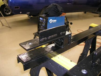

After moving the 450lbs compressor with the forks, I noticed the 3/8in top plate bowed a bit. I cut a couple pieces from 3/8 plate and welded perpendicular to reinforce top plate. Something to think about if you're lifting heavy stuff.

Now that's a good idea. It's amazing how much a small 3/8" piece of flat bar that's only about a foot long will bend even when it is welded up for the first 3 inches. In your modification, it's the webbing effect that gives it strength.

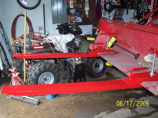

Like these? They are made from 5" channel, and they work fine. The rebar on top allows for a strap over the top of the bucket, but I have never needed to use it...

The first set I made many years ago had thick flat steel on the top like yours. I remembered they bowed or bent with a lot of weight on the forks. I gave them away as scrap when I sold a previous tractor I had. When I saw Madref's pics I remembered my first set bending, so I used channel top and bottom. I've had a lot of weight on this set. The attached (pic of my forks only) picked up the front and rear of a datsun 280z (with no engine) to jockey it around to load onto a trailer. When it lined up with the trailer I picked up the rear end of the car off the ground and pushed it up onto the trailer (estimate 1500#). I've also used them to pick up the back of my 20' trailer so the wheels are off the ground for brake service / inspection (trailer weighs 2500#). Thats more than my tractor is supposed to lift. Oops!!
