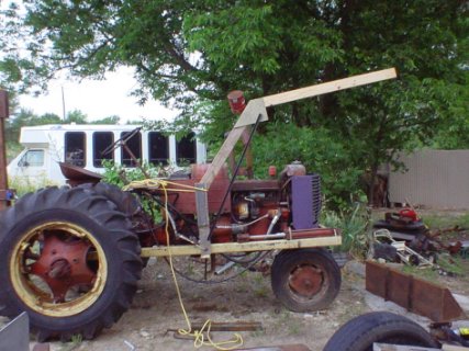

It's a VAC with live gear driven vane pump. This will be changed to gear pump later. I now have lift working and will be adding cross member and single curl cylinder. This will be attached to sub frame that will be my version of QC.
Here's a shot.

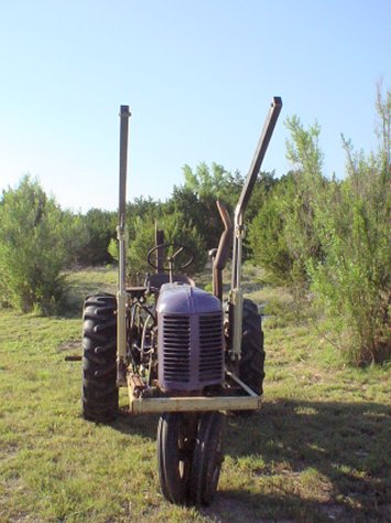

   / FEL coming
Frome the front.

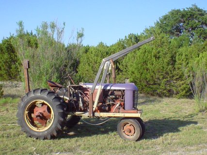

   / FEL coming
Here's a close up.

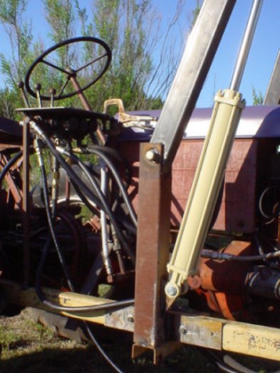

#11
Here's the center arm cylinder mount. Welds are 6011 with 7018 to finish and will wrap pipe with strap later and add gussets to both sides of arm.

Dummy, I just don't like JI Case red/orange and I had a gal. of the rustX grape. I planed on using the grape as a base coat, but Realy like the way it looks.
Mirth. I had planed on a FEL for the Suburban with the 9.2 Wisconsin. I would of used 1.5x3" tube instead of the 2x3. Imay still do this in the future.
   / FEL coming #13
Are you at all concerned that this might get a bit "tippy" with those narrow front wheels?
   / FEL coming #14
</font><font color="blue" class="small">( Are you at all concerned that this might get a bit "tippy" with those narrow front wheels? )</font>
Looks like good work so far, but I'd be really wary of a loader on a tricycle framed tractor. Those things are quite tippy without a loader.
John

   / FEL coming
#18
Tippy is realitive to the common cents of the fool ,in my case. operating the equipment. I'm not overly worried as I learned a long time ago not to drive with bucket over foot off ground, unless your on leval ground. I've seen more wide front ones tipp over than I ever heard of tricycles.
   / FEL coming #19
</font><font color="blue" class="small">( Tippy is realitive to the common cents of the fool ,in my case. operating the equipment. I'm not overly worried as I learned a long time ago not to drive with bucket over foot off ground, unless your on leval ground. )</font>
You make a good point there. For someone who's not used to tractors it might be a problem, but like you say, even wide front ones go over.
John
   / FEL coming #20
True enough, I've come close with my Yanmar, and it's about 4' wide front and back, just by dropping a wheel in a hole I didn't know was there. Fortunately I only had the bucket up a foot or so. It just seems like a "triangle" would be easier to tip than a "square" with the load way out front, but you're right, on flat ground it shouldn't be a problem long as you don't hit a hole like I did..........
