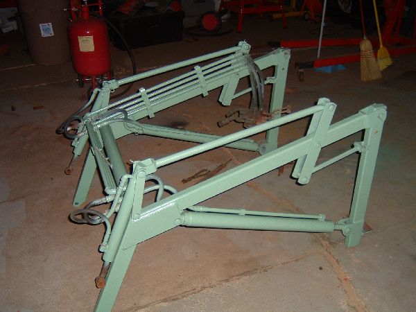

   / FEL control valve
My loader is home-made i think. It was free so i took it.
The cylinders seem to be in good condition but the hoses and valve is weathered away. I sandblasted and painted it today and im in the process of building the mounts.

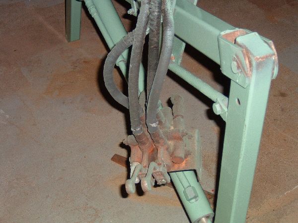

   / FEL control valve
Heres a pic of the valve that was on the loader , Im assuming i can put the newer style on that has side/side and front/rear motion in its place?
   / FEL control valve #8
</font><font color="blue" class="small">( Heres a pic of the valve that was on the loader , Im assuming i can put the newer style on that has side/side and front/rear motion in its place? )</font>
Yes, you can. I'm not sure on the hydraulic setup on your Yanmar and I can't see from the pictures as to how many hoses will connect to the valve. You have the 4 work port hoses that go to the cylinders. On on open center system you will have 3 more, pressure inlet, power beyond outlet, and return to tank. The configurtation of these 3 ( or maybe 2) hoses and your Yanmar's hydraulics will determine how the valve should be configured.
   / FEL control valve
#9
There are 4 lines going to loader and one pressure and one return on the old valve.
   / FEL control valve #10
</font><font color="blue" class="small">( There are 4 lines going to loader and one pressure and one return on the old valve. )</font>
Then you do not need the power beyond sleeve for the joystick valve.
