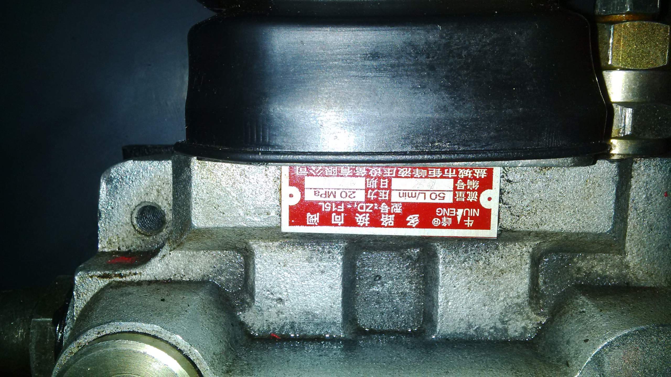

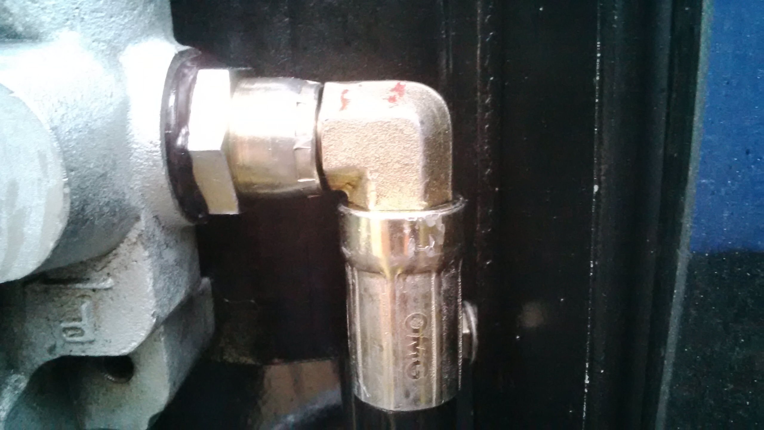

Good day all.
Anyone here know the fitting specification size etc that connects to this FEL velve? see pictures thank you
/ FEL Fitting size / specification questions. #2
I believe it is a metric ORFS (O-ring face seal). If so, it is not available for sale in the US. There has been a lot of discussion in the past about these fittings, check the archives.
/ FEL Fitting size / specification questions. #3
Quicksandfarmer is correct, but you can get adapters to convert to JIC at Affordable Tractor.

Thank you all, how about this site can anyone tell me what conversion fitting would fit on my current valve?
The link I gave you is exactly what you asked for, a dealer that sells aftermarket replacement fittings for Chinese tractors. Direct quote from the site:"you can order a direct fit replacement hose that includes an upgraded adaptor that does away with the factory adaptor that are known to leak hydraulic oil."
I don't know why you don't believe it when several people tell you, but the hydraulic fittings on Chinese valves are metric ORFS. This is not a fitting that is used anywhere in the world but in China. The only place you're likely to get them in North America is a Chinese tractor dealer.

Hello Quicksand the site you provided me I could not find the actual conversion fitting specification and I do understand that these are hard to find and trust I know. as for the site you provided all the fitting old / new don't look like the one I have on the spool valve the site I provide if one would know the exact specification to the one I have that was suggested on this forum to be a 11m ORFS then I would have been what I was trying to do is located that specific conversion on a site. my apologies quicksand I'm only trying to get as much info from as many to not order the wrong part as you nothing like waiting for 2 weeks for a delivery and get the wrong parts and yes im very anxious because this is the only thing standing in my way to get some work done on my property.
/ FEL Fitting size / specification questions. #11
I think your best bet is calling a Chinese tractor dealer like Ranchhand or Affordable Tractor in Texas and asking them.
But if you want to figure it out yourself, here is a guide to identifying hydraulic fittings:
https://www.discounthydraulichose.com/v/vspfiles/downloadables/thread_guide.pdf
The metric ones start on page 15. Note that for each fitting it lists a thread size and thread pitch -- ie M12x1.5. That's a 12mm diameter with 1.5 mm between threads. This is the same way that metric bolts sold at any hardware store are specified, and the sizes are the same as those of common metric bolts. So go to a hardware store and get yourself the following bolts:
M8x1.0
M10x1.0
M12x1.5
M14x1.5
M16x1.5
Be careful with the 8, 10 and 12 because they come in both 1.0 and 1.5 pitch. Take the fitting off, and see which bolt fits. That's your fitting size. If none of those bolts fit -- if it's 11mm for example-- you're back to dealing with the Chinese tractor dealers.

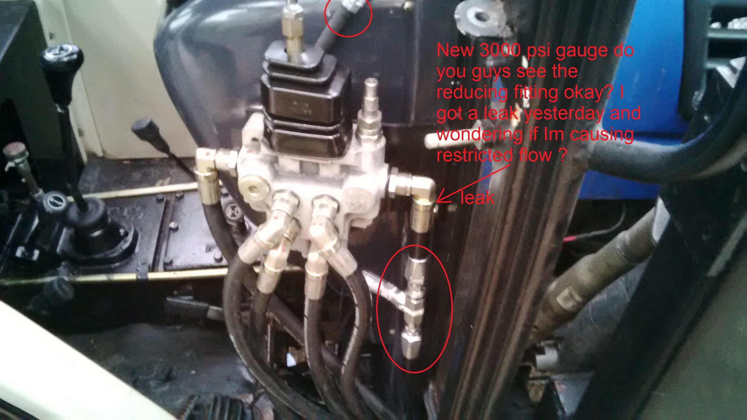

Thank you Bob unfortunately no Jinma dealership around here, what I ended up doing yesterday is old school switch the in put hose with the out put because one would think the psi would be just a bit lower to control the minor drip leak... it worked slowed it down by a drip per every 5 minutes so I took a string inserted in between where I had the leak at no 2 a few turns and stop the drip for now until I get a permanent replacement all fitting to a local available brand because the last thing I want is a blow out in the winter and have to wait for parts so will gradually replace all thank you Bob for your help and everyone one helping... I said it before will say it again I could not have done all my repairs without the help from the members of this site... Rob

Good day all. just a quick FYI I found the 2 conversion fitting for my spool valve and works great the in put and out put size is 15MDL-8MJ / Metric Conversion Male DIN 24* Cone Light Series to Male JIC 37* Flare Thread {1}: M22 x 1.5 Thread {2}: 3/4"-16 ( $32.00 each )

Good day BJR, on my end I used plumbing putty insert in the valve lined up with the release fitting made the new hole and no metal shaving got in the valve stayed on the putty I still used a 1/4 tube plugged on my mini vacuum and suck out anything that could have bypass the putty, for my valve because they are already at 15mm I would not want to increase the size and in my case it was good to go with the conversion fitting because now I could use the original hose to fit a standard valve if I find a good deal one day.
The only thing I have yet solved is the curl up power not as strong as the 3 other positions will check if I have air lock one day on the curl up position it works but I would judge at 75%.
