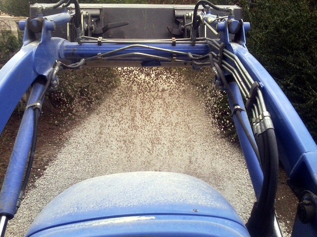

It is not going to hurt the L3200.
Once again, I agree. 3000 hrs of commercial work on my tractor. I've hurt it doing a lot of things it was never designed for, but this isn't one of them.
