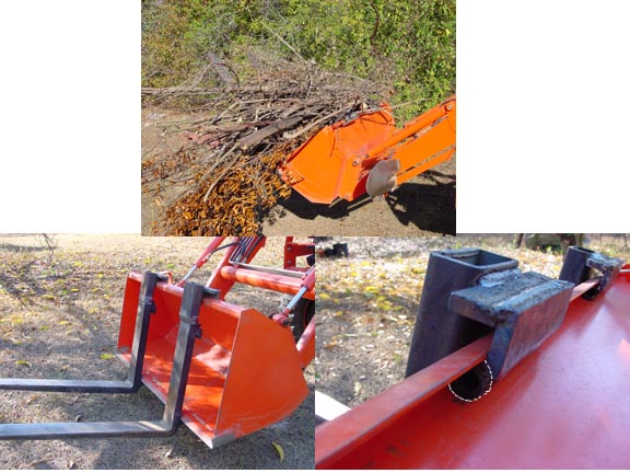

   / FEL forks using forklift forks #14
I did not have a frame for my forks. We just added to the top and I curl my bucket to catch the round pipe then "un-curl" and my forks are ready for use.
I am able to vary spacing with this setup.

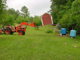

   / FEL forks using forklift forks #15
Here is a view showing one of my uses. Had to have the tank replaced on well pump. Did not want pump man to try moving or working inside the little space.

#16
gotrocks-
Very interesting setup. I wonder what the capacity would be? It seems like you may have some lateral movement where the forks meet the cutting edge of the bucket if your load shifted to the side.
I like the concept though!
   / FEL forks using forklift forks #17
The forks will hold more than my 2910 will lift. There is some flop side to side but it has never been a problem. I also have used (abused /forums/images/graemlins/confused.gif) the forks together and individually to dig up shrubs and small trees. I sure beats the "trench wrench."

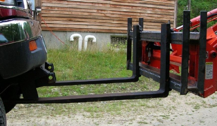

</font><font color="blue" class="small">(
The forks have the standard 16" spaced brackets on the back side of the verticals... these slide on horizontal bars on the standard forklift frame. I wold like to use these brackets if possible since it would allow me to adjust the fork spacing just by sliding the forks apart or together.)</font>
Yea that is the route I took as well. I believe the terminology
is "ITA Category II" with respect to the nominal 16" mounting
configuration. A new set of 48" forks was around $250.
I built a quick-tach style frame to mate with my loader
from some 4" channel growing in the backyard and a
few sundries scrounged/bought elsewhere. Here is a
picture before it was actually completed just to verify
whether my structural stress calculations were accurate.
The goal was to keep the frame as light as practical to
avoid excessive loss of loader lift capacity.

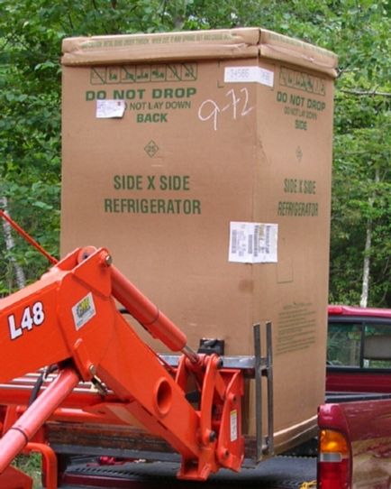

   / FEL forks using forklift forks #20
Sometimes things can't wait for projects to complete.
