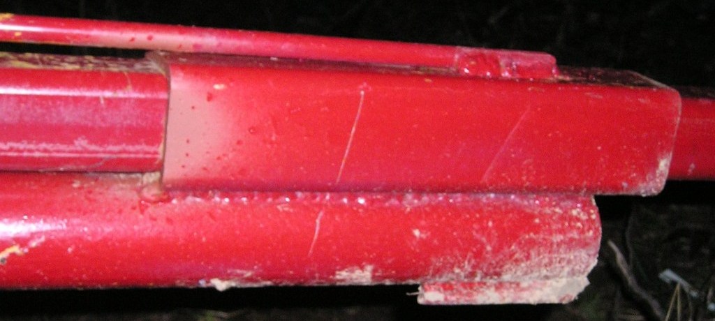

Hey David, very cool project /forums/images/graemlins/cool.gif
Here's the close-up of the stinger/reciever welded on the boom. As you can see, I had to do some modifications to the way it was originally built (King Kutter, I think)
Something else you'll notice is that I haven't yet drilled a hole to secure it with a pin.
-srj

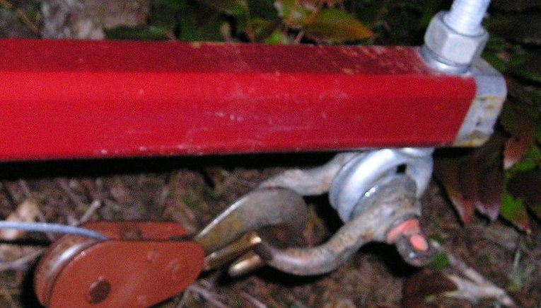

And here's a close up of the tip
   / FEL Gin pole (Boom pole and then some) #15
Thanks, those were great. I think your modification was also what I was wondering about. Now if I can just figure out what to ask for to buy the material.
David
#16
I had a hard time knowing what the ask for too...
If you go to any shop that makes hitches, you can probably get what you need. A short piece (about a foot) of the reciever tube (2" ID) and as much as you dare to go with the 'stinger' stock (2" OD). I went with 1/4" thickness on both.
-srj
