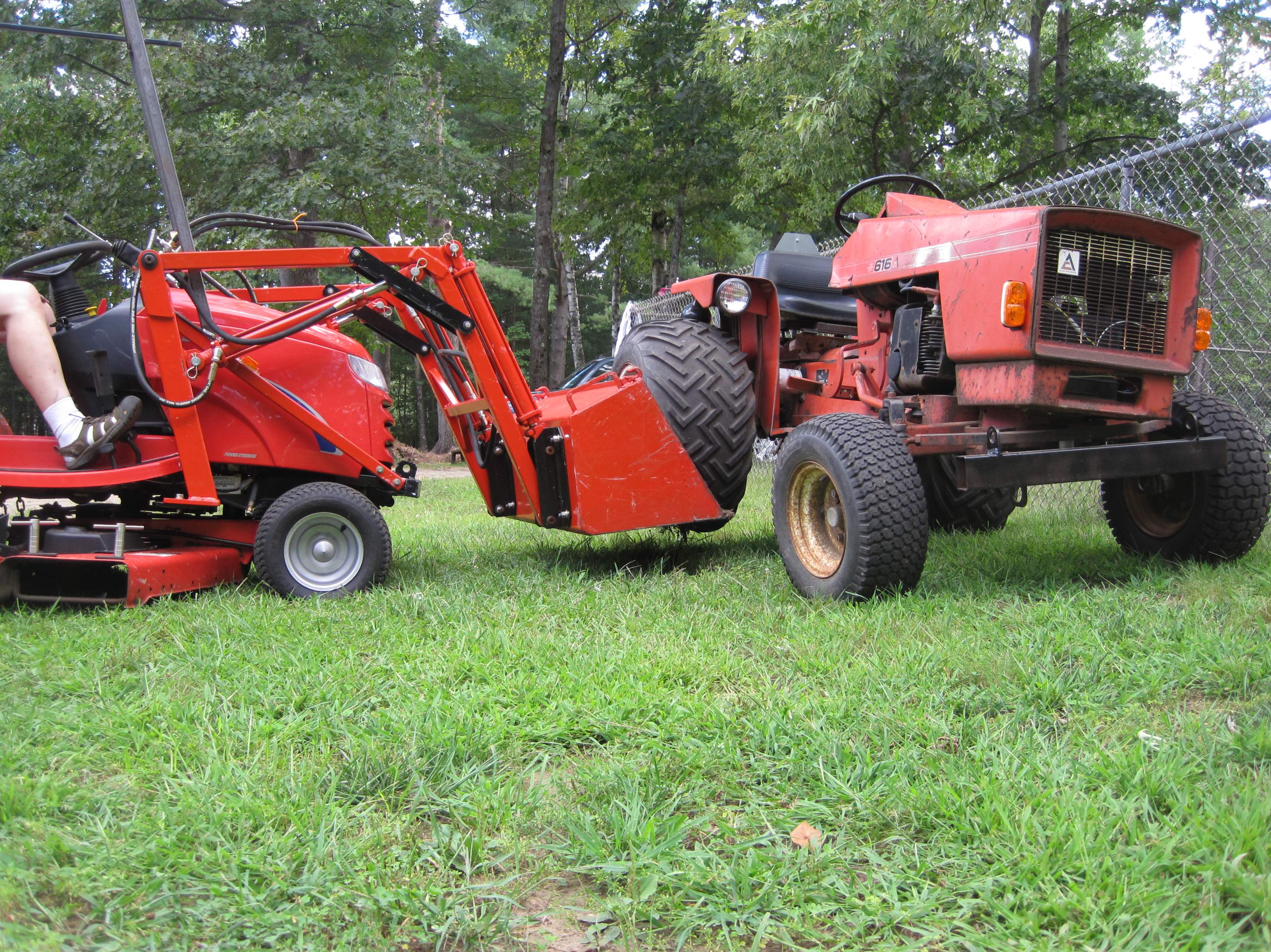

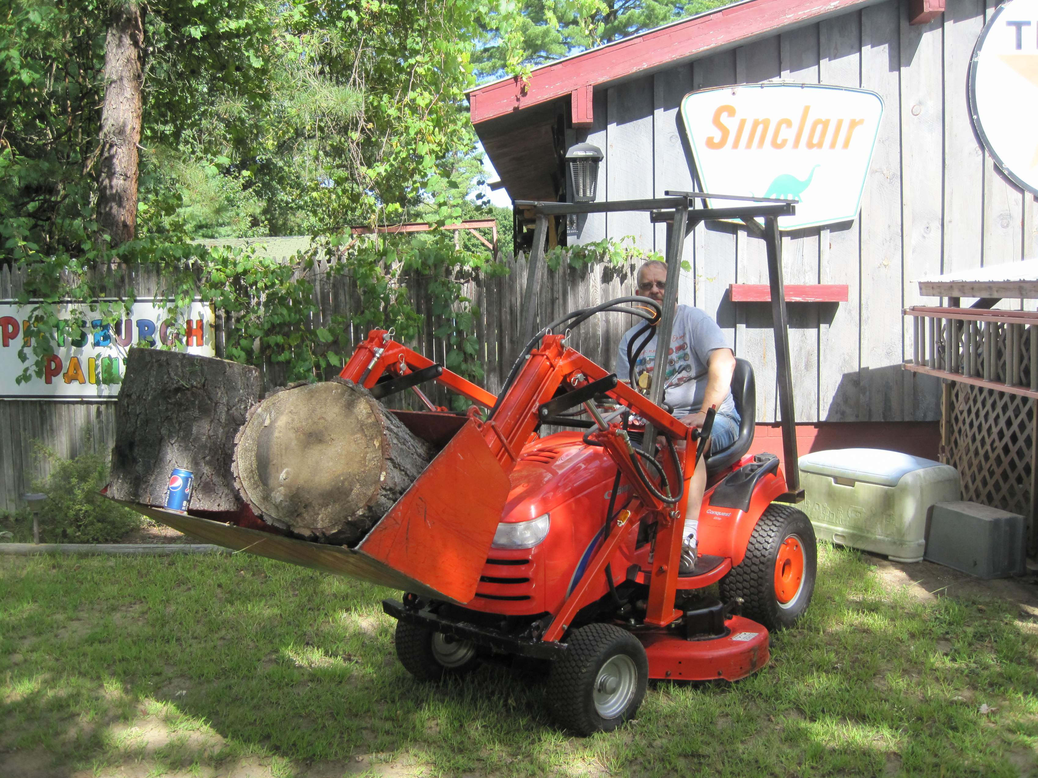

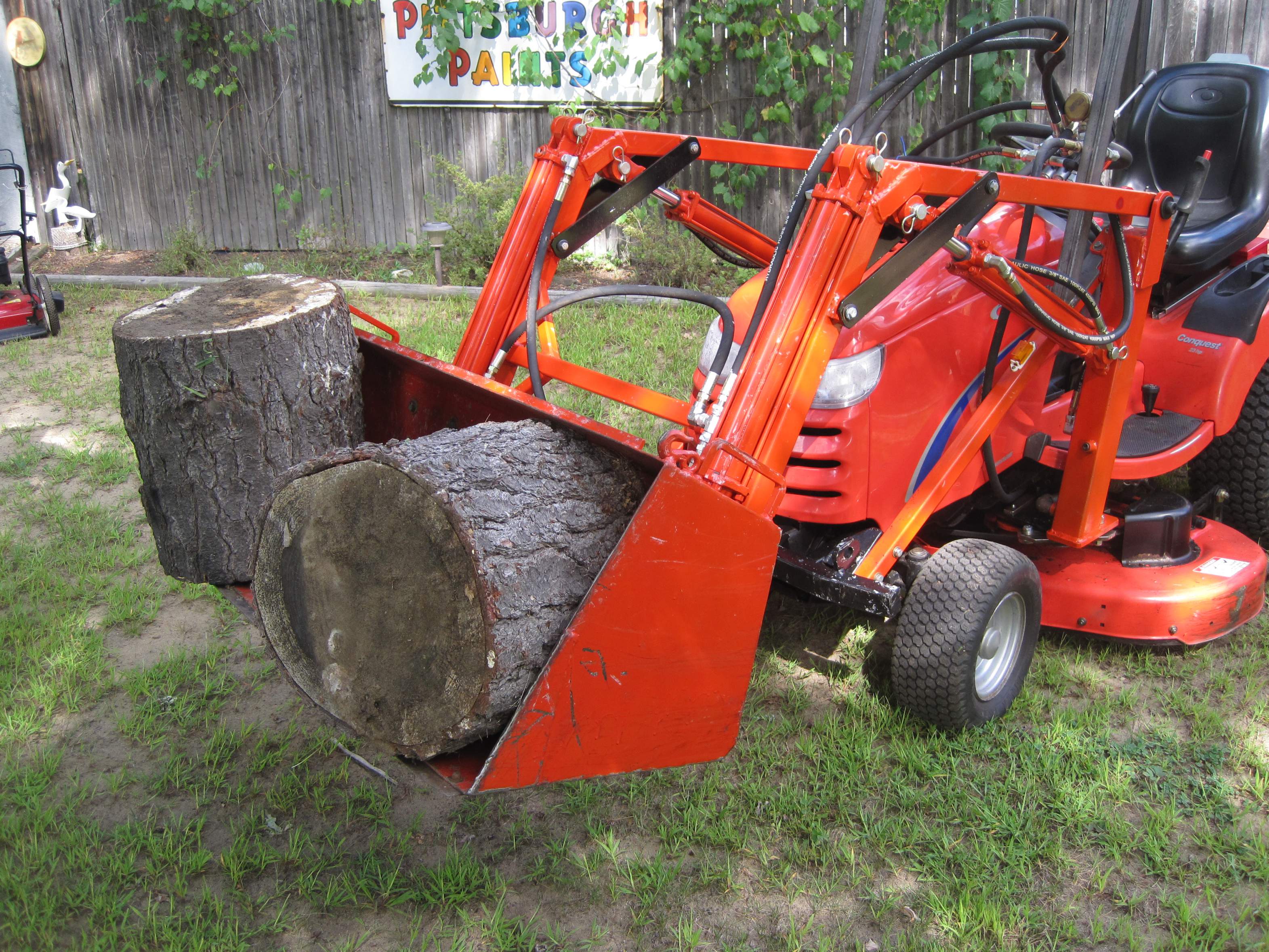

Hi guys as promised but delayed a few more shots of my homebuilt loader. First kudos to Paul at P F Engineering I purchased the basic plans from him last fall worth every penny it was my first hydraulic project and had a bunch of dumb questions I probably contacted him 4 or 5 times over length of build he was always very helpful After reviewing plans soon realized it wouldn't be a walk in the park I didn't wanta cut up the Sim wanted it to have a "bolt on factory look" So I decided that my vertical towers would be angled backward to pick up body lines on the hood Well that was like going from round wheels to square wheels (almost) Anyway it did really mess up all the hydr ram travel and geometry struggled for several days with thin aluminum strips that where drilled with holes to represent the rams at rest and at extended. Being a machinist with my own well equipped shop I added a few nicer touches I radius milled lots of the parts including the pivoting ends of the lifting arms they are also reamed, fitted with flanged oil lite bushings and assembled with shoulder bolts had originally planned to go with a 44" wide bucket but after urging by my welder friend "uncle dick" it stayed 4 feet wide local fab shop bent the bucket shell for me (90$) labor ...it was my metal I welded everything myself except the bucket side panels and heli arcing the NPT ports on the tower Other friend "doctor joe" helped a great deal with cutting and drilling the steel then mockup and repeated assembly and

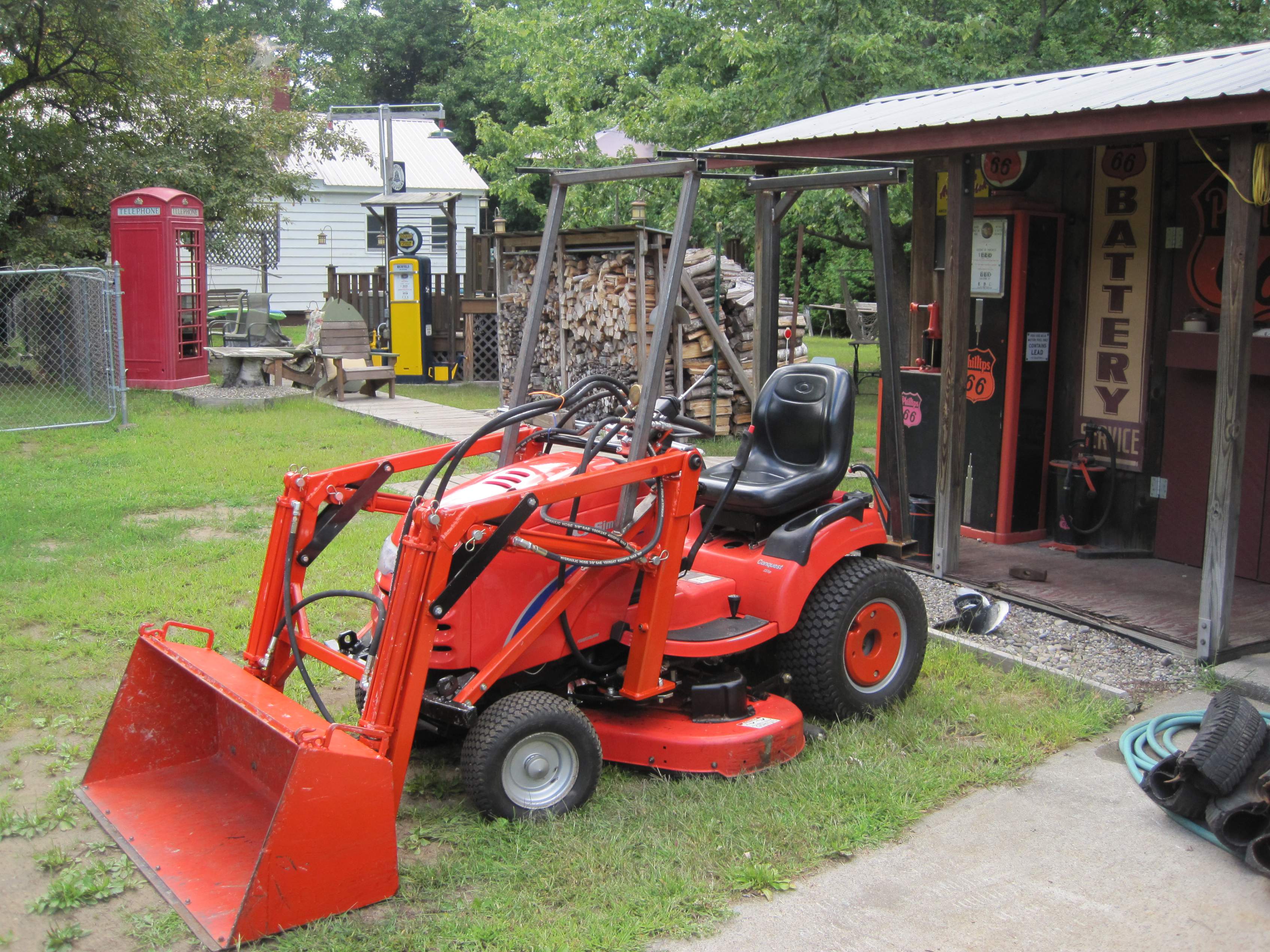

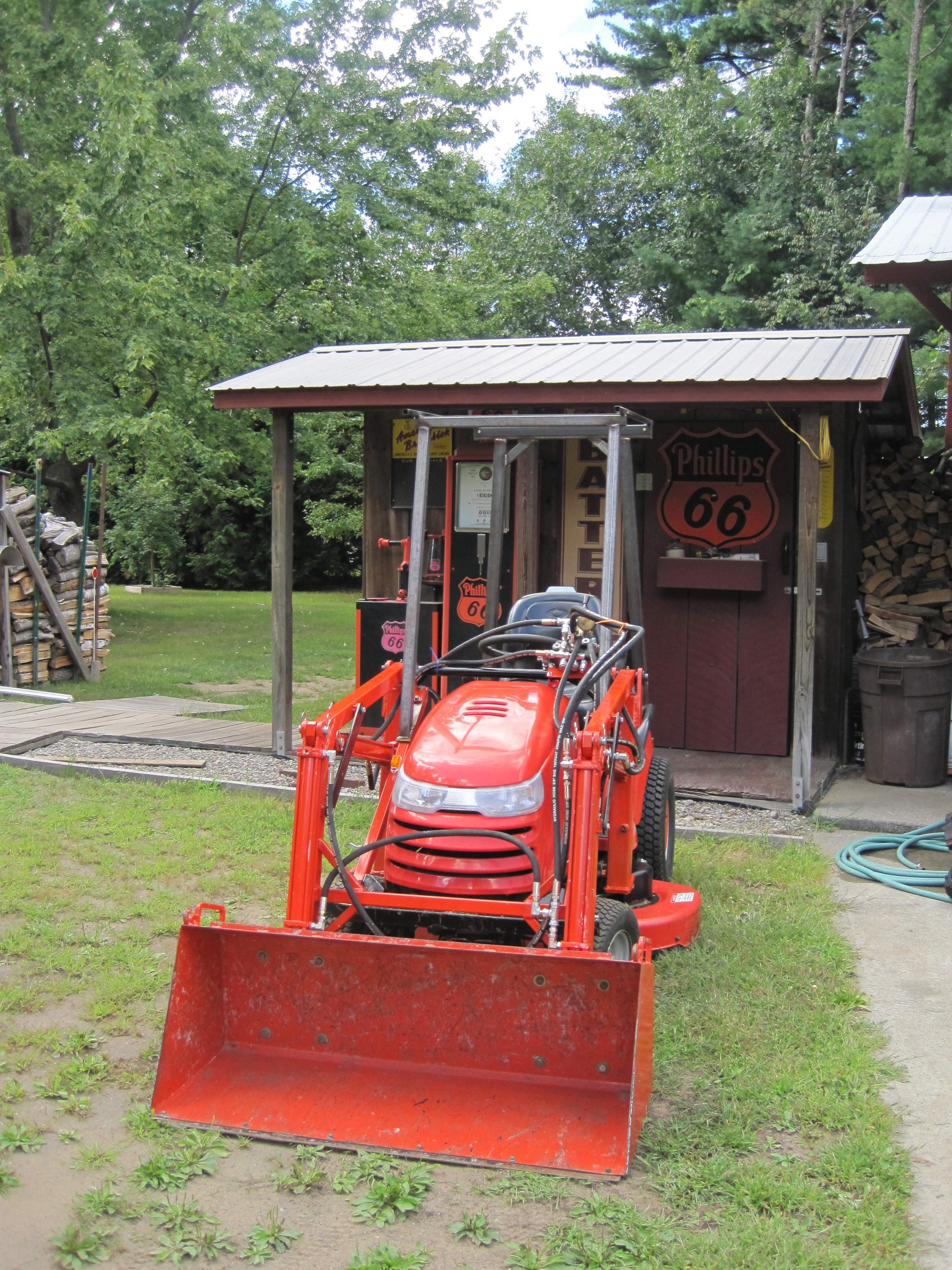

disassembly As steel work started to come together my wife remarked that Simplicity orange was nearly the same color as Phillips 66 orange
So guess what its Phillips orange so everything was torn apart one last time some recycled steel was sandblasted welds where ground and all steel was degreased throughly we had a very mild thanksgiving 2011 and I was lucky enough to paint in late Nov 2 coats epoxy primer and 3 coats of acrylic enamel a few days after paint drying dr joe, joes dad Allen and I reassembled things fit up nicely

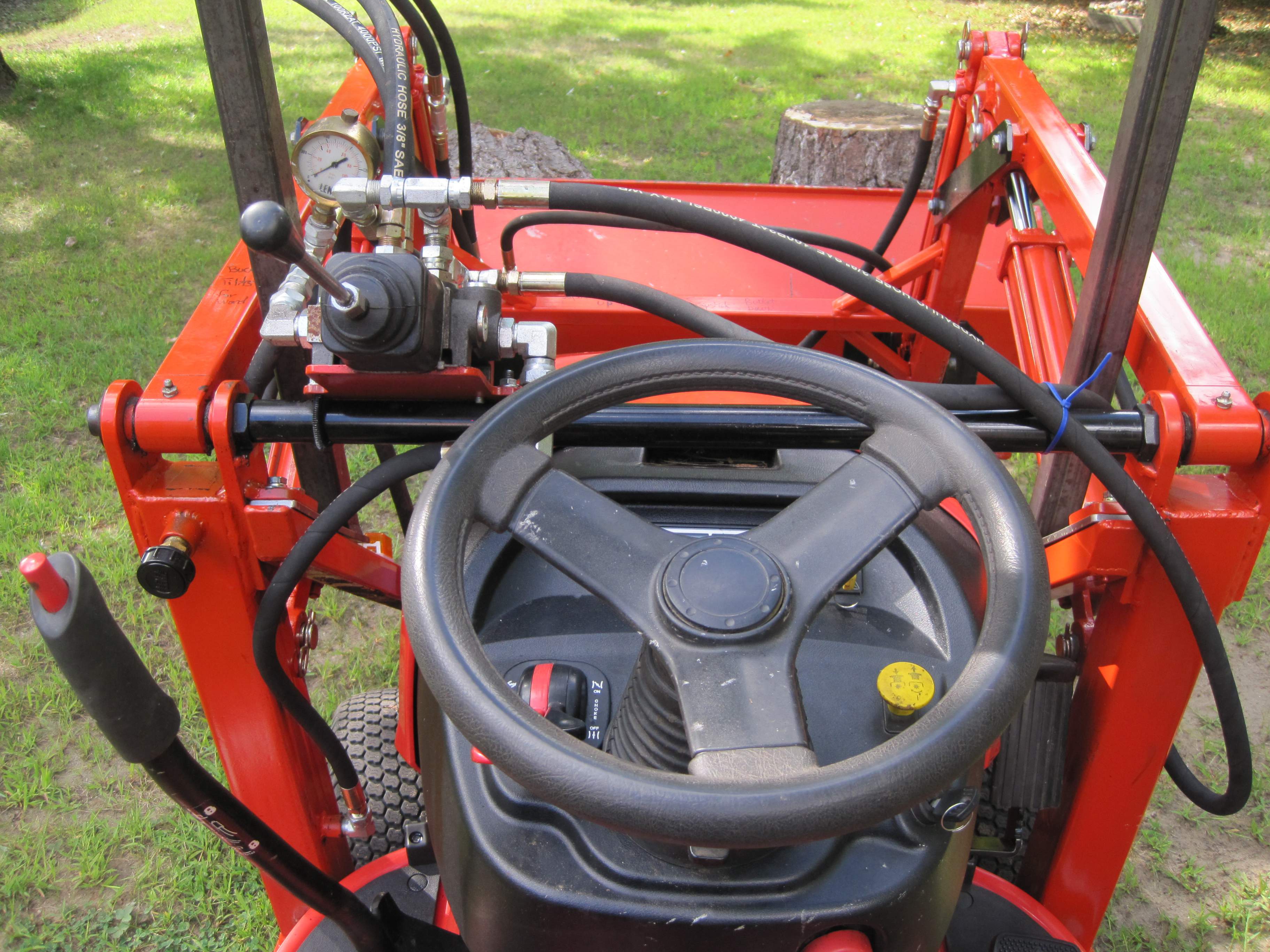

A old hi school friend Paul and I did all the hose and hydraulic assembly in a day and half
Paul from PF eng. furnished us with a check list to do the hydraulic fluid "injection" we only lost about 1/4 qt of ATF
The owners manual of my old AC 616 says machine weights approx. 1000 # at rear axle so that photo kinda shows the FEL capacity
So I think saying it will lift 500 lb. is quite realistic
