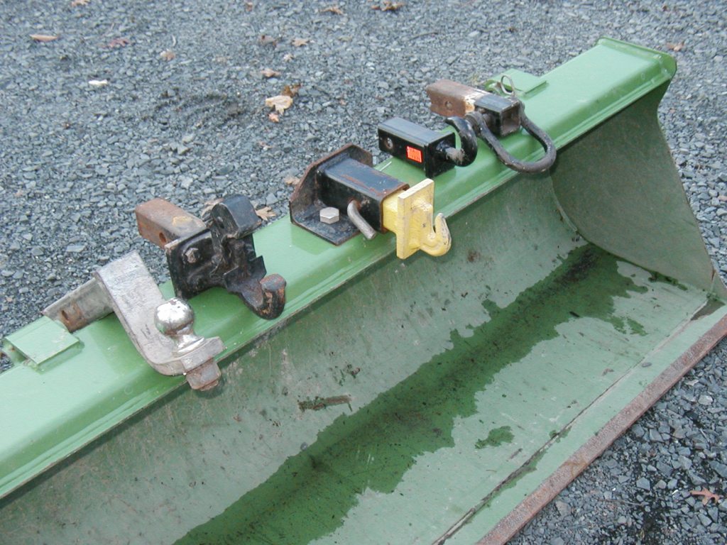

Hooks are pretty versatile. I added clevis mounts to mine as well!

I have the heavy duty bucket and 400x loader on my JD 4120. There are 1/2" holes across the cutting edge for installation of a tooth bar, etc. I keep a couple 3/8 chain hooks in the toolbox, and a few 1/2" bolts. When I need hooks, I just bolt them into these holes. Having them on the lower edge is nice because it gives you more lift from the tilt function than you would get from hooks on the top of the bucket. That bucket is really strong. I also drilled a couple more holes further back on the bottom of the bucket in line with the lift arms, and bolt a couple pieces of heavy angle to the bottom for use as forks for lifting logs, etc. I dont think the standard bucket would work so well with these tricks however.

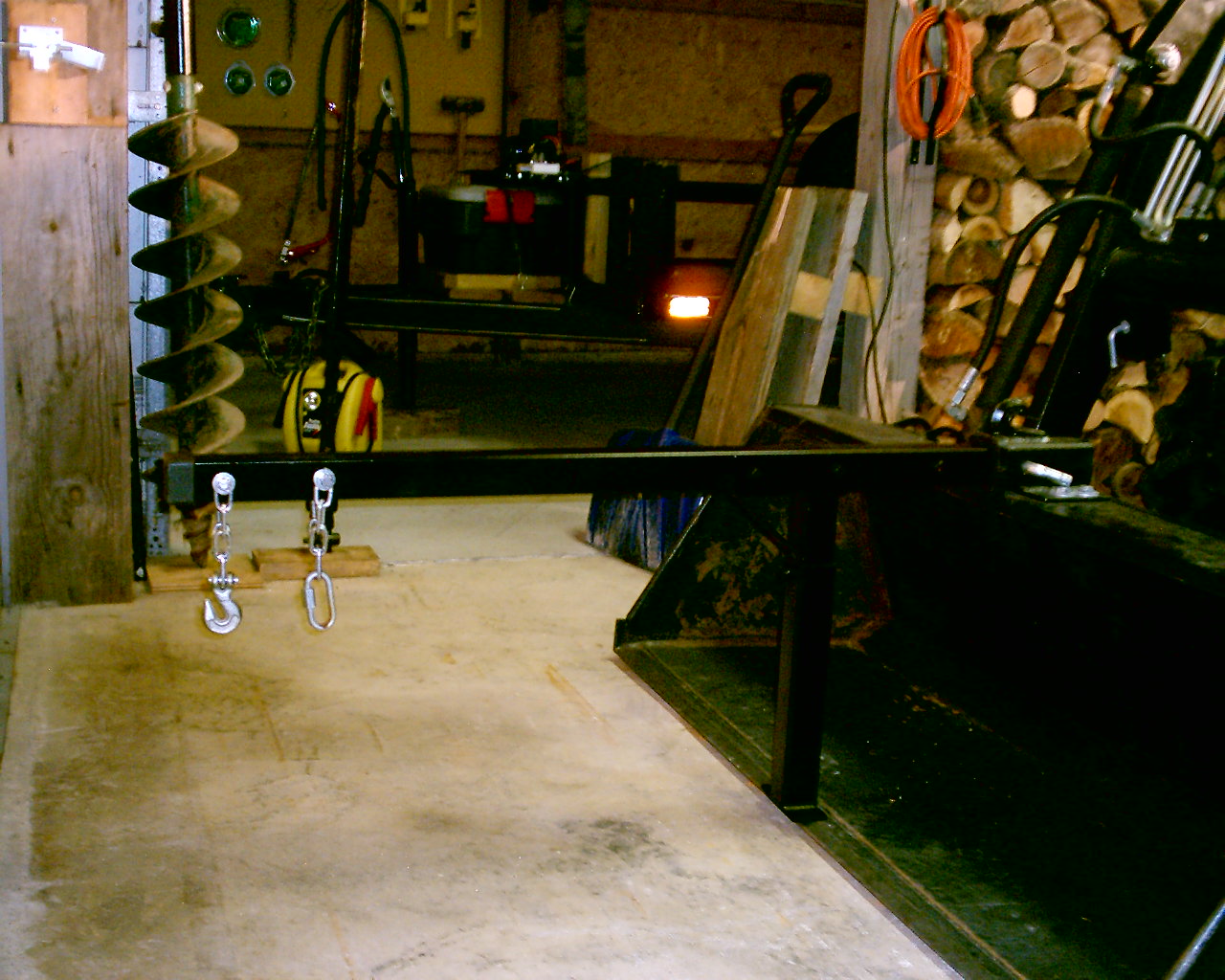

3/8" grab hooks are handy to have, but put them on the sides, save the middle for your receiver tube, you can just weld one on as well.
I bolted mine as I wasn't sure it was a good idea since mine was one of the earlier top center installs (that I had seen at the time). Now everyone has caught on for obvious reasons, it's versatility is limited only by your imagination.
http://www.tractorbynet.com/forums/...g/93535-bucket-buddy-instead-weld-hooks.html?
You can read about my reasoning for the receiver tube here.
JB.

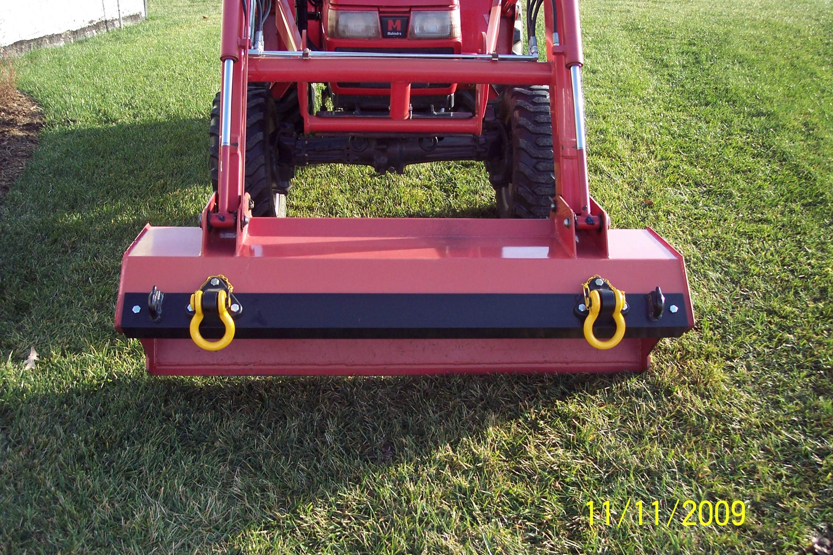

I paid $5 each for my hooks so that is a deal. If I were you I would also pick up a step bumper hitch at HF or any auto parts store for $20 and have them add it also.
I put 3 hooks on each of my buckets. The pic is a old one when I had only 1 hook but soon realized I wanted more. I put 1 in the center on top of the hitch and 1 on each corner.

Nice setup JB!
I made a pair of movable hook brackets that slide anywhere along the bucket. No
welding or drilling into the bucket. (not that it hurts anything)
