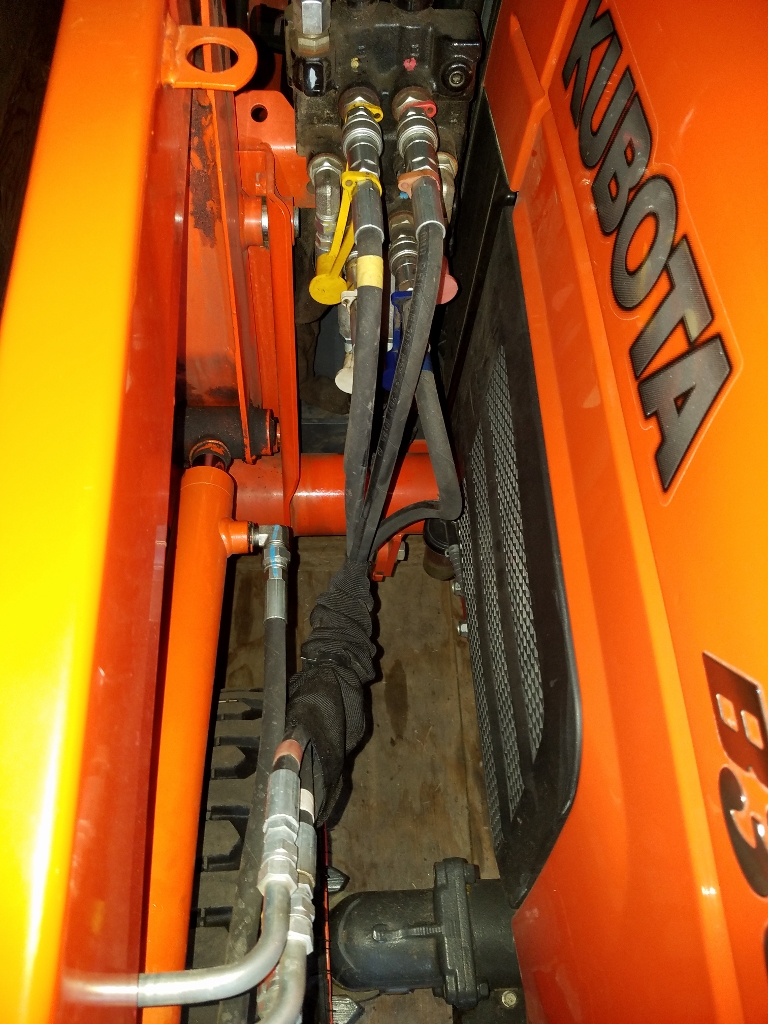

When raising the FEL at idle, I can pull the remote joystick back pretty much all the way till it stops and still get the boom to raise. The FEL has a slow and fast boom raise mode based on how far you pull the joystick back.
However, when running the engine at higher RPM, and thus when hydraulic pump output is stronger, the only way I can get the boom to raise is to pull back on the joystick ever so slightly - if I pull back just a bit too far (what my hand is trained to do after 5 years of loader work on this machine), the loader stops raising, like it's going into bypass mode up at maximum boom height. The only way to re-set, and get the raise function to work again, is to quickly push forward to float mode, then go back to raise mode. Simply releasing the joystick back to neutral position does not re-set the lift function. Loader work has become a huge hassle. Every other loader hydraulic function is fine. I have tried switching hydraulic hoses around, and the problem seems to stay at that same port coming out of the loader valve (moving to the new hose/function plugged into the apparent problematic port).
Am I going to need to pull the loader valve apart and possibly replace the internals on the boom side, or is there some sort of simple hydraulic bypass adjustment on the loader valve that needs to be made? It is a remote (wired) joystick from the cab to the loader valve, LA403 loader on Kubota B3000 Cab model. I have confirmed the joystick adjustment (am able to use the joystick lock feature).
Any suggestions? Thanks in advance.

How many lines are connected to the FEL valve. 6 or 7?
Very important to know if the FEL valve has power beyond circuit (7 hoses) or does Not have PB (6 hoses)
Please post a few photos of the FEL valve and of the overall tractor.
Does your tractor have power steering?
Post pictures of your hydraulic pump or pumps. Some models have tandem pumps, i.e. one pump attached to the back of the first pump.
Did the FEL come from the factory on a new tractor or was it added later?
As others have suggested, your description of how to raise the lift arms seems to be quite unusual. We need to figure out why that is.
Dave M7040
Not sure why I'm not getting notifications lately from TBN when replies are posted, but thanks to all for the feedback.
I have 7 lines coming out of the valve. PB goes back to backhoe, then backhoe comes back up front. Machine has dual pumps with hydraulic power steering.
Hose with yellow caps is the boom lift hose. Every other FEL and backhoe function is working fine - only issue is the boom control. Loader and backhoe have been on the machine since new, so for 6 years now. Issue with boom lift started a little over a year ago.
I got the new female QD installed late last week, so both QD's on the boom lift hose are new, and issue is still present.
At this point, I'm thinking there's something going on inside the valve with the spring or a check ball that is broken, hanging up, or something, so I'm thinking a valve rebuild is inevitable.

I finally figured out the issue with my FEL boom not raising properly. I realized what was going on a week ago when I removed the FEL just to see how the machine handled mowing chores with the flail. I always figured the weight of the FEL would help balance the tractor a little better (it does) so the FEL has always been on for mowing duties. When I was finished mowing, I brought the machine down to the garage to blow all the dust off, and found hydraulic fluid had been dripping from one or more of the factory male QC poppets at the loader valve. The poppets were not seating properly, and were allowing hydraulic fluid to continue to flow through the QC's, regardless of FEL joystick position, thus creating a constant "bypass" situation at the valve.
I replaced all 4 complete factory QC assemblies today, and now I can't get the boom raise function to "fail", so I think the problem has finally been resolved for good.
Interesting part is that prior to these issues starting, the FEL had only been removed from the tractor once back when I first got it, just to do it. I would have figured repeated QC disconnects and reconnects would be harder on the poppets & springs than normal FEL operation, but I guess not. I just did the 200 hour service a couple weeks ago. This loader issue started about a year ago, closer to the 150 hour mark. I just never had time, or remembered, to look into it when the weather was good, since the majority of FEL use the last couple years has been for snow removal. Failed poppets so soon sure seems a bit odd compared to previous machines I've owned.
