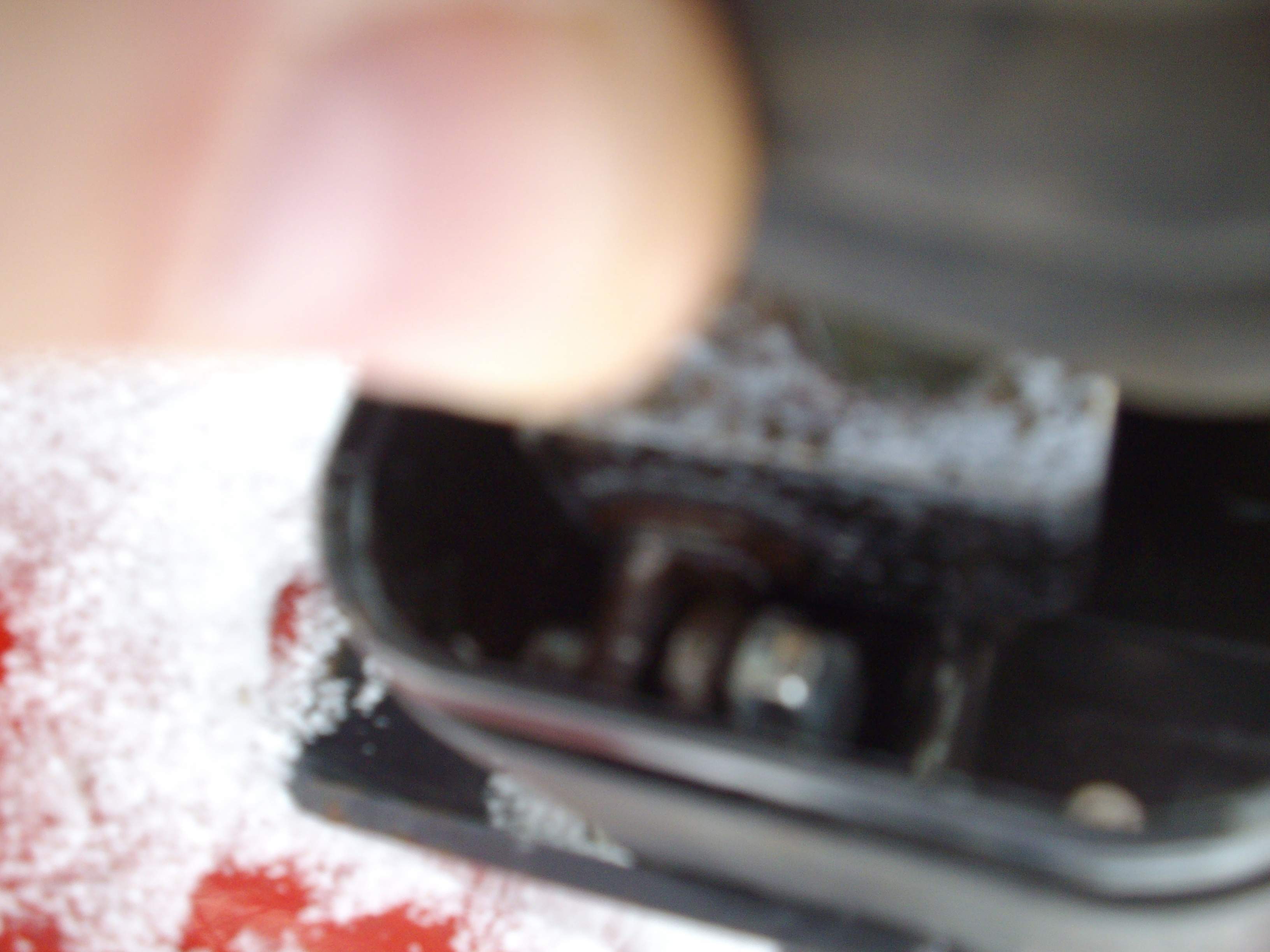

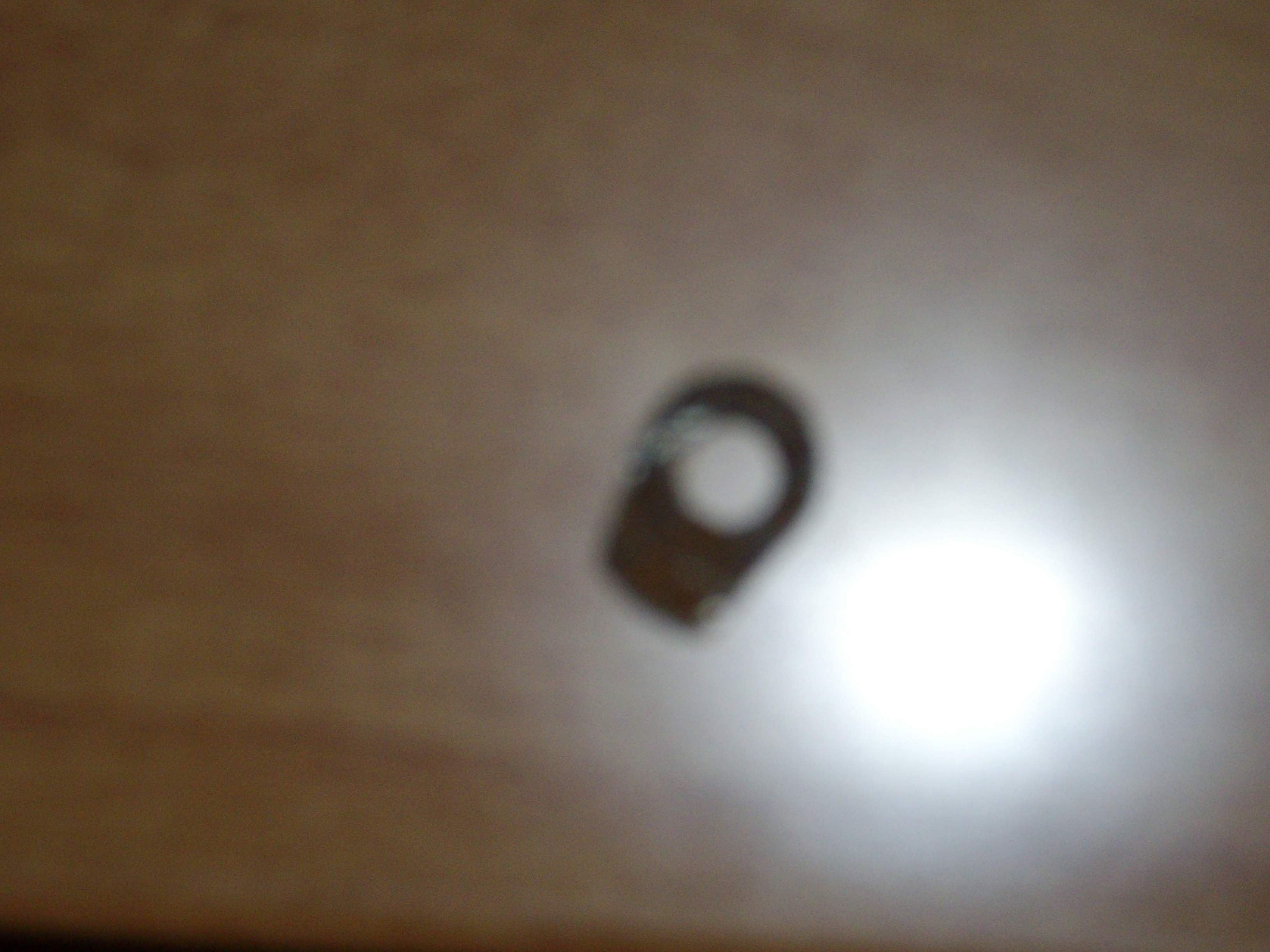

I was moving snow around and something went on the inside. I removed the boot and noticed that one of the Y pieces coming off the hydraulic hose broke off and the pin came out. How do I fix that? Do i have to replace the whole hose or is there a way to just replace the Y and get a new connecting pin? Its a C-50 FEL system off a Century.

I will try to post a picture, but if you open the boot, there is an arm that comes off the mechanism and it goes between the Y that comes off the hydraulic cable. A connecting pin then goes through the first tab, then through the arm and finally through the back tab. Its the back tab that broke off.

Below is a picture of the broken piece and where it broke off. I stuck that bolt in there just so I could finish clearing my road.

Well, I'm corn-fused. Hydraulic hoses and cables? The first picture looks like part of tail light off a 67 Ford Mustang or maybe a backup light from a 49 Packard. I still can't figure out what you're trying to show. :rolleyes:

sorry, its the best I could do. basically what is broke is the end of the joy stick cable where it attaches to the joy stick mechanism. From what I am told, I just need to replace the cable.
