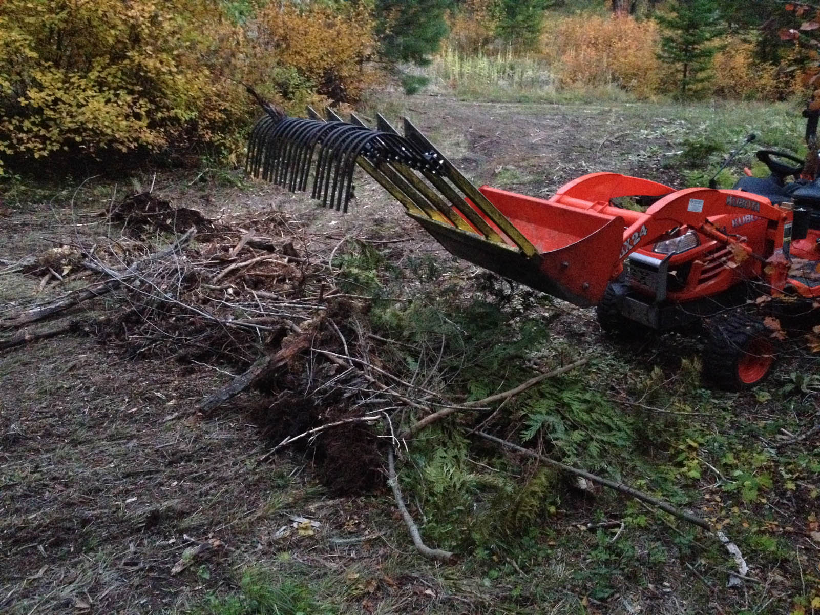

Slightly different setup than yours; my rakes attach to the brush fork.
I'm real happy with my (homemade) FEL mounted landscape rake. With the rakes far up front it can reach way back under a tree and pull out a huge pile of sticks and my back's not sore at all. :thumbsup: Using the "bucket float" it doesn't dig into the grass too much. And they are pretty small, each mini-rake attaches to one fork tine, with one pin. So it breaks down into 5 parts that are easy to throw in the bucket or back of the pickup.
Quick-release with one pin each. Can narrow it up using 2 or 3 rakes if necessary.
If interested in a few more pics and the build story see original thread.
