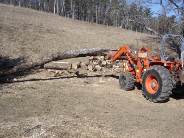

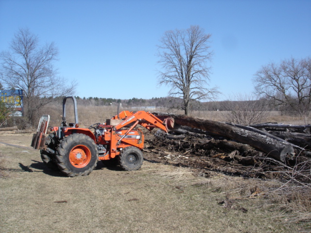

I scored an old pile of logs last spring, here is what I did. I have some pics somewhere of my Grapple I will post when I find them.

I too use my grapple to hold logs for bucking. Considerably better than forks as balance is less of a problem. I can hold the log well off center and just saw from one end. I've also sawed directly into a pick up bed which works fine when I don't need to split the rounds. Sawing into a compact pile for splitting requires some repositioning of the tractor for best efficiency but that's no big deal.
I want those logs off the ground because sawing on the ground is murder on my back. Also the more you can keep them out of the dirt and requiring less handling the better.
The last four feet of log remains a problem because, like everybody, I'm not comfortable sawing so close to steel. I'd like to figure out some wood device I can slap on the grapple and take off easily that will protect the chain teeth from my sloppiness.

Great. I hear you saying you can pick up a 20' log, buck one end at a time, and not run back and forth. Hmmm?
I'll try to get some pic this evening. Now on running back and forth I didn't say I never had to do that, now I only need to do it a few time per log not every cut. But is sure an improvement from what I was doing in the past, hanging from tongs.
Just pick it up from the end, unicorn style, in the grapple.
