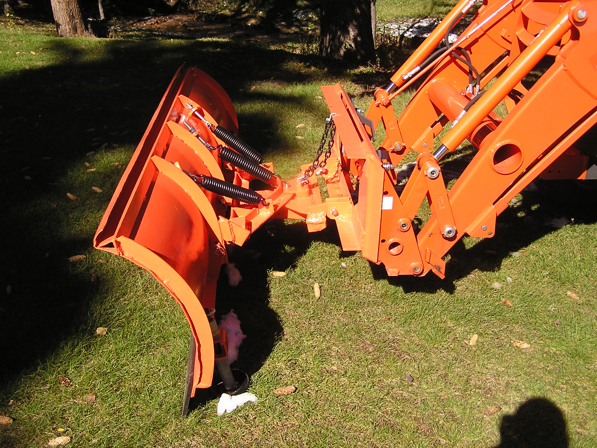

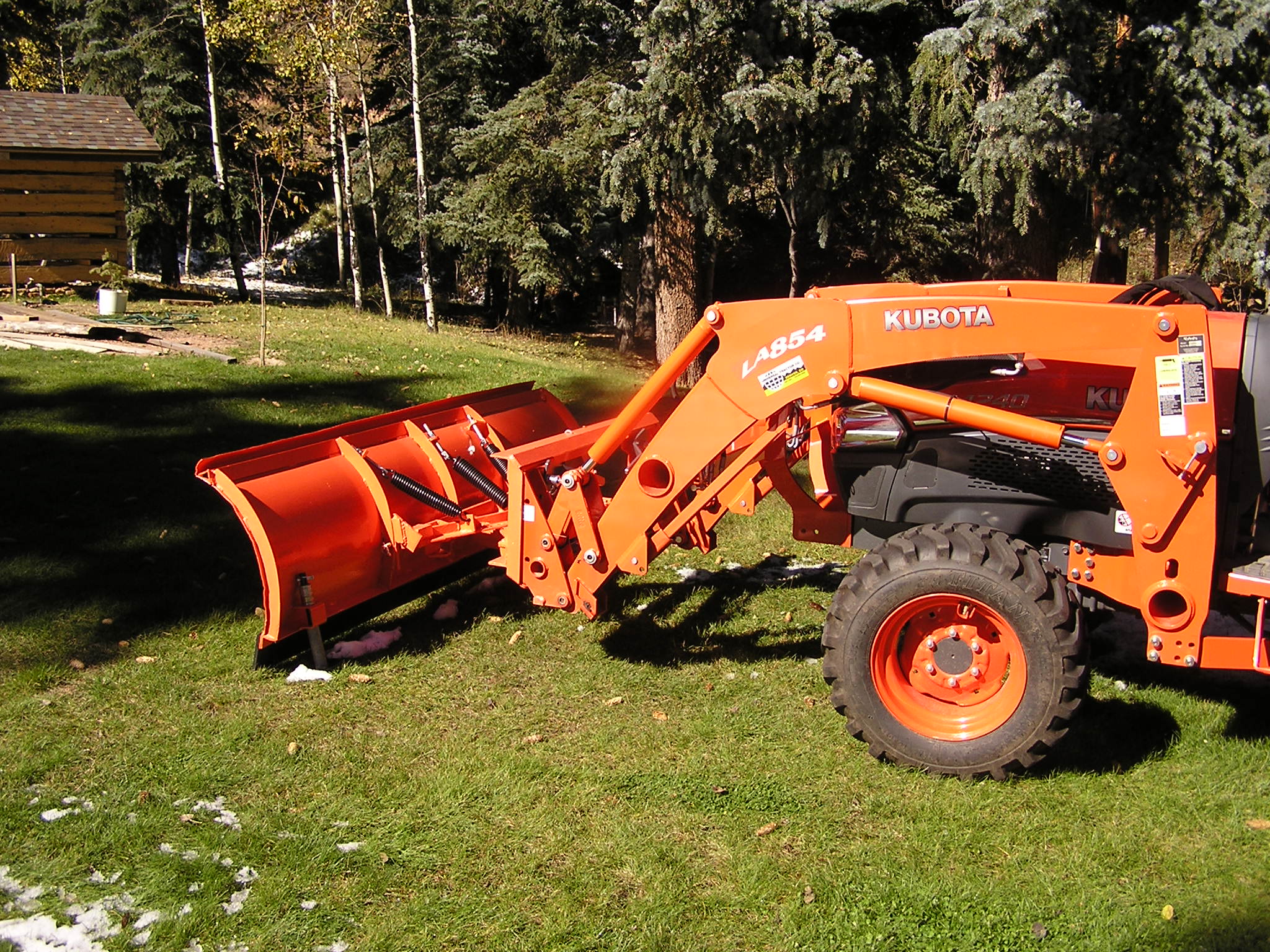

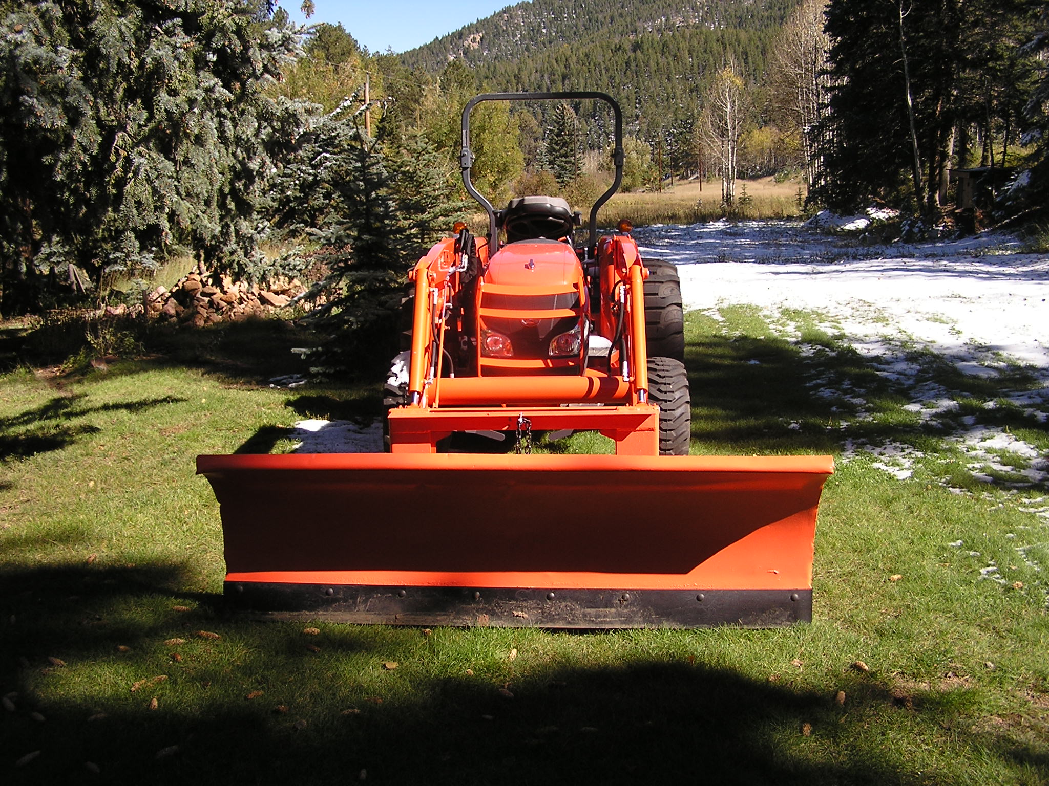

I essentially copied vtsnowedin's approach: I bought a used 1970 vintage Western plow and adapted it to fit my FEL. I now need a good snow to see how well it works. The plow cost me$200, but I had to buy the quick attach plate, a new cutting edge, and pay for some welding, so total cost is probably about $800.
